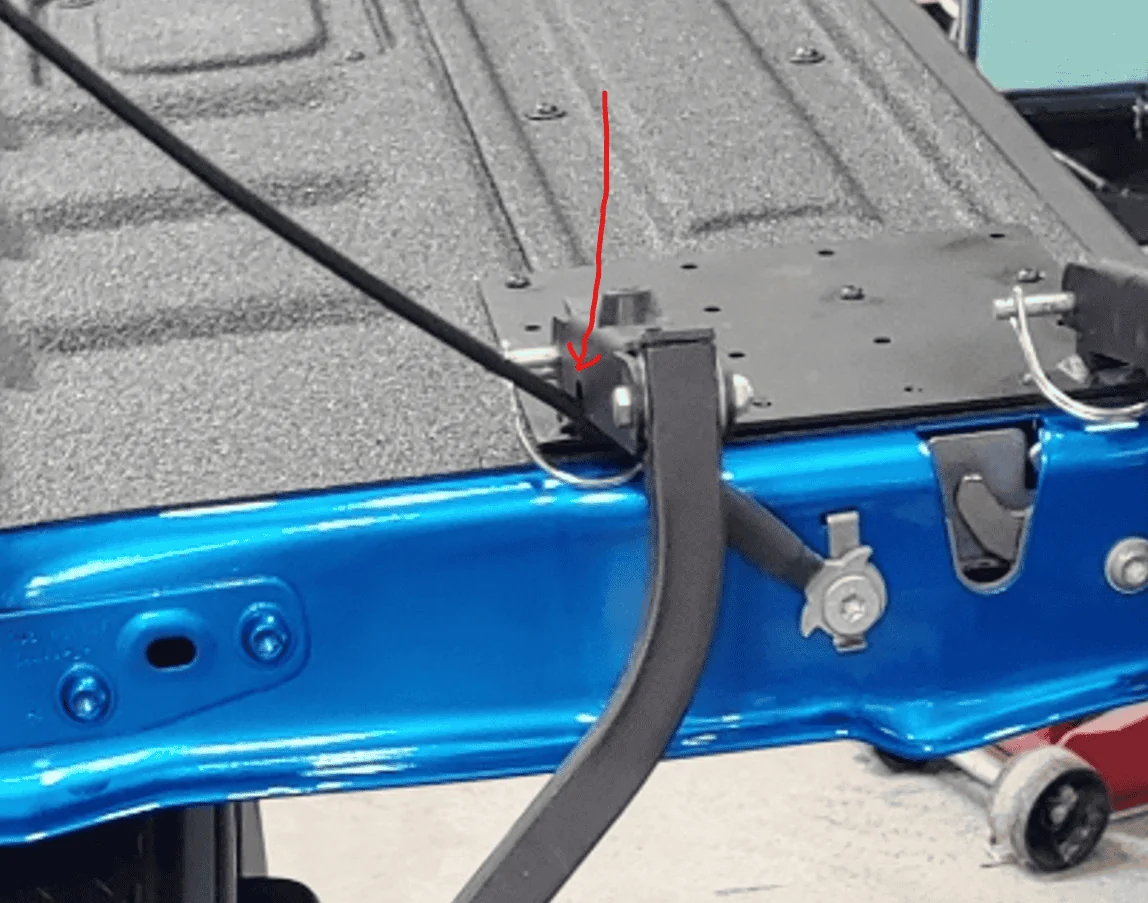

I did change how the plate is mounted, and modified it a bit due to the close clearances on the JT - but it works fine and I use it often.
I moved the one "post" that put the ladder a bit too close to the cable, but likely not actually necessary. My back and arthritis and now vestibular (balance) issues love this thing.

Did you modify the part of the post (last pic) where the cable goes underneath ?

Mine was before HF, Amazon and others sold them, so it was more expensive. The same thing today would be what you see at HF - I consider that a good price.

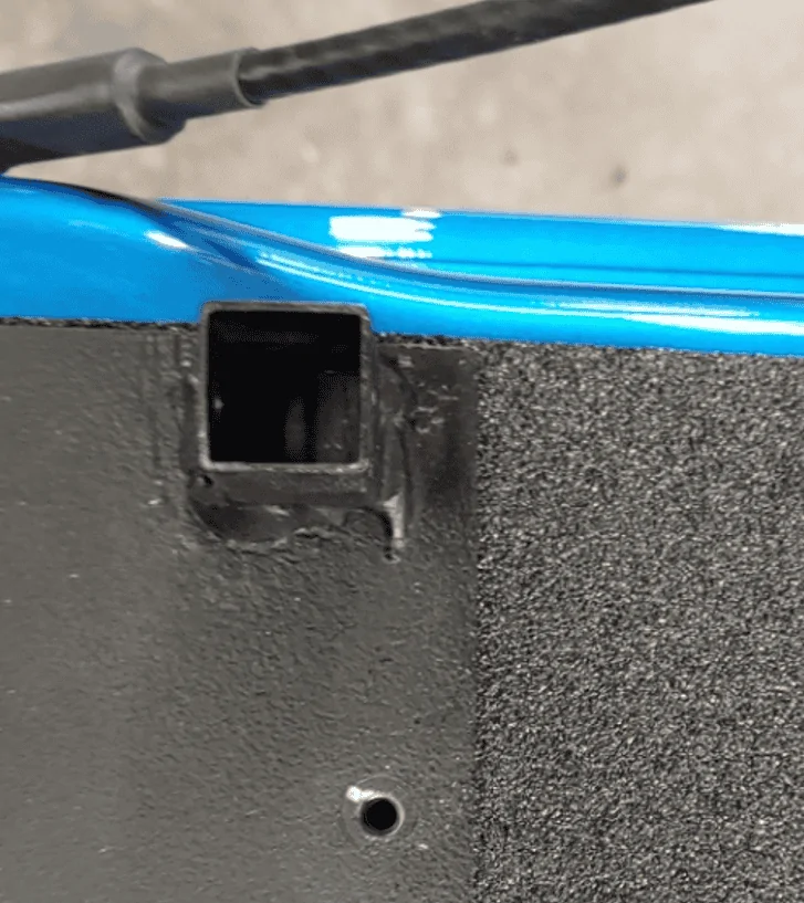

I cut the square post off the mounting plate and re-welded it back onto the plate a bit from the edge to move that part of the ladder away from the cable, and I notches the U shaped part that connects the ladder to the mounting plate post to help clear the cable a bit.
Maybe not important, but it bugged me.

This "post" was over to the right edge of the mounting plate. I carefully cut it off the plate and welded it back on over a bit to help clear the cable. Maybe not needed.......... try not to look at my weld job too closely.
