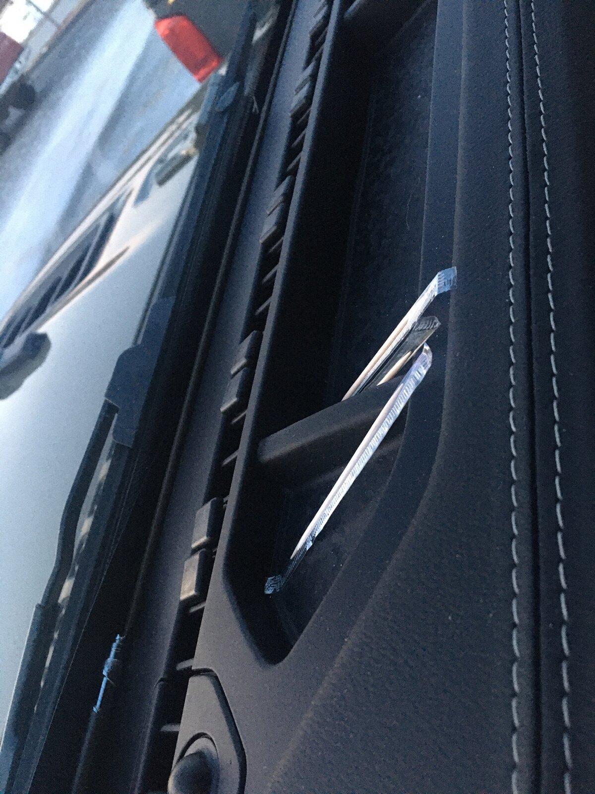

The defroster may be the issue. It has been discussed extensively in several threads. Adding 5/8” square plugs to several of the vent openings will redistribute the heat to provide better defrosting. Available on Amazon, but I do not have a link. Check this post - https://www.jeepgladiatorforum.com/forum/threads/gladiator-and-defrost.36521/post-615072

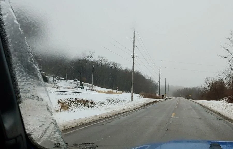

Windshield icing no worse than some other vehicles I've driven. I've driven many since I first started driving at age 14 back in about 71.
Other TRUCKS, including my F250, I had to run the defrost on high, blower on high, and still wipers didn't always stay clear.
Many times I've gotten out of a Grand Cherokee and flipped the wipers to remove ice and scraped the edges of the glass.
This isn't the best, but isn't the worst or the first.
I put a good dose of RainX on the glass, run RainX wiper blades and RainX juice in the washer jug.
My wipers didn't ice up in the pic below - the good thing about these is the flat glass means the wipers are simple. Other wipers on CURVED windshield lose all flexibility when iced - these wipe flat glass, not as big a deal if they did freeze.
When they freeze with a really curved windshield glass, they no longer follow the curve of the glass and stop wiping.
This was mild compared to some vehicles I've driven - (and the wipers didn't ice up)
