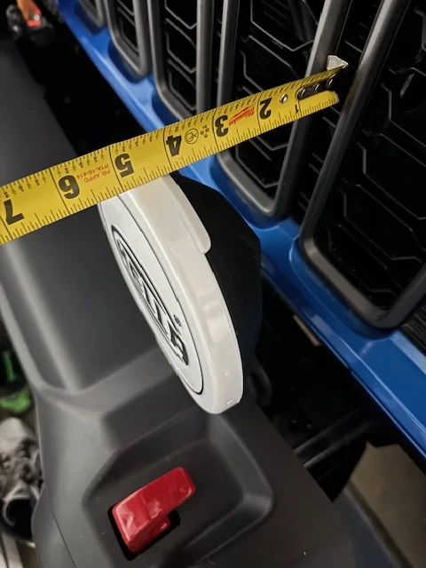

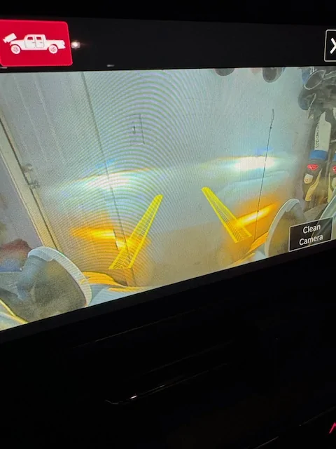

I'm a big fan of cardboard, painters tape, and zip ties to make templates. A couple of measurements to assist you on your quest.
'25 Rubicon w/ 1.5" Tereflex level kit on the front and completely stock suspension otherwise. I'm also running old school lights that are larger in diameter than most of the modern lights so hopefully their 'bulk' will give you some ideas on the worst case scenario side of the sliding scale.
Ground to top center of the plastic bumper = 29.5"
Ground to the center of the trail camera = 42.5"
From the grill indentation to the outer edge of the lights = 5"
Ground to the top of the lights = 38"
Top of the bumper to the top of the light = 8"
The above combo looks like this in my trail camera -

Grill indentation to outer edge of light -
Jeep Gladiator Ideas for lights for my new ride Hella to Grill

The question of the trail camera comes up a few times and I was always surprised to see how much bulk i.e. winch can be out there and not block as much of the camera as I would have guessed just by looking at the set-up.

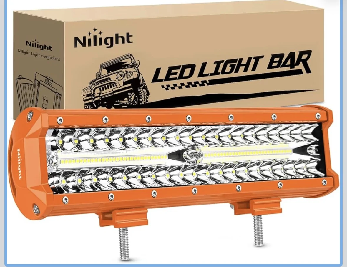

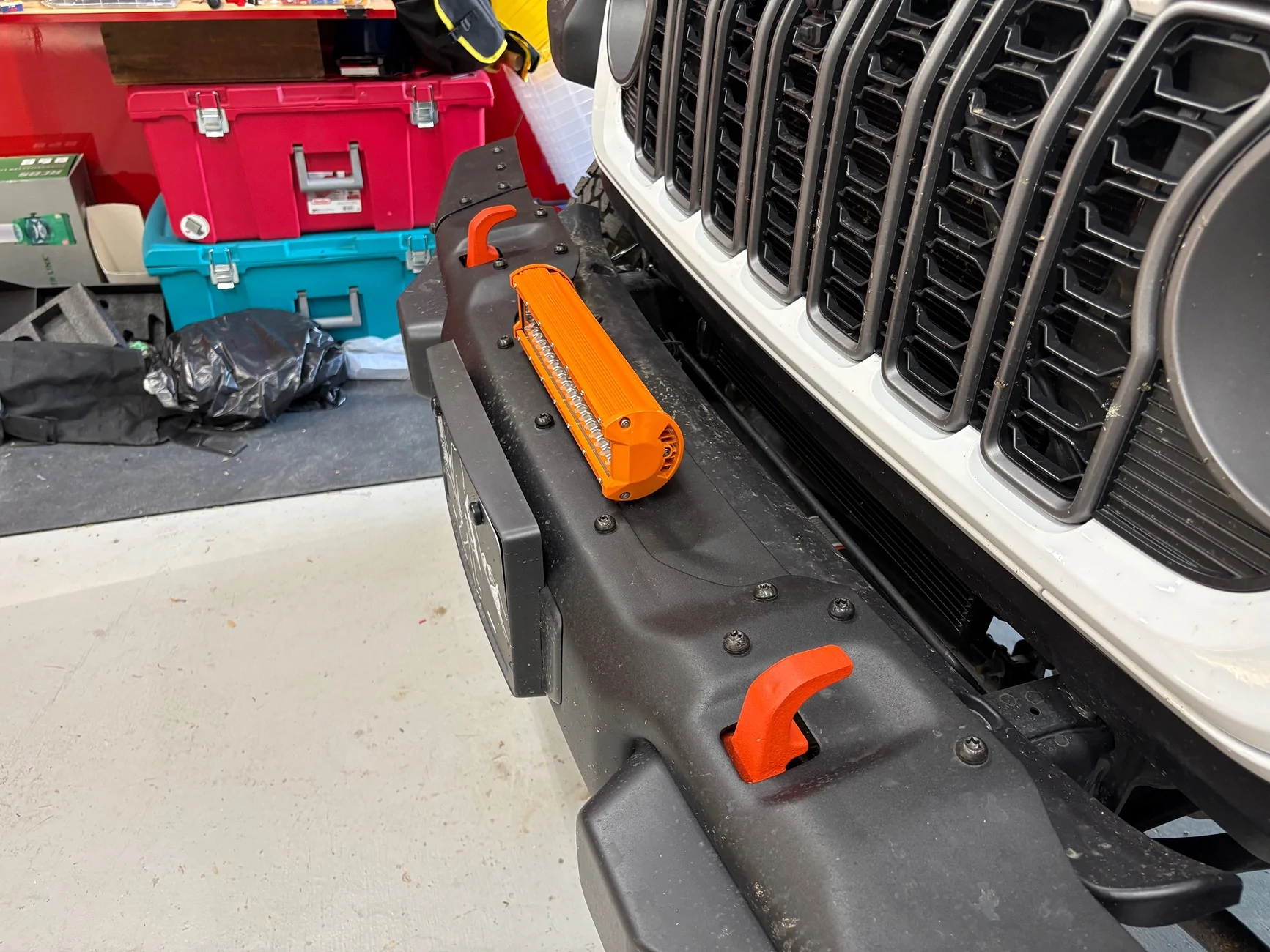

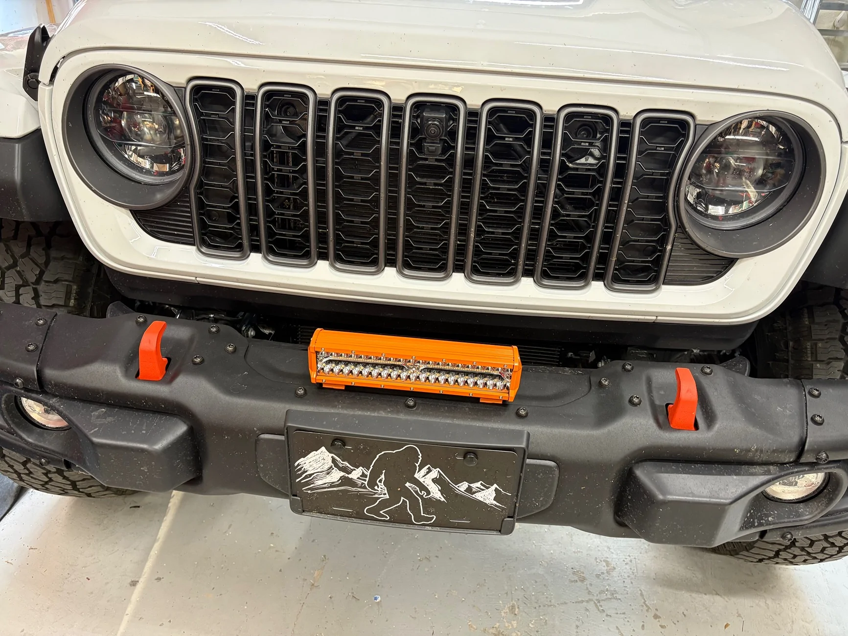

Update...
After a lot of thinking, reading, shopping and studying I decided to keep it extra simple. Nilight a brand that I have used in my old Gladiator with very good success has this tiny 300 W 12" LED bar that does not intrude in any way with my forward facing camera!!! I think it was all of $30 delivered overnight from Amazon and it's built rather nice. The last set of Nilight lights I bought lasted for years of lots of use (I often lose track of time and end up wheeling at night to get home) on my old Gladiator so I don't think I'm too worried about these ones not working as advertised. And as a bonus they come in orange with goes very nicely with the badging of my Mojave X!
Installed them tonight by drilling and mounting them straight on to the bumper winch cover plate and ran the harness to the right AUX 1 lead. I was done in 30 mins. THEN I had to fuck around with the whole setup because my light would not stay on only to finally find out about the freaking "LATCHING" setting!!!!! Son of a bitch!!! But everything is working well now so I'll go out tomorrow to test them off-road and report back. They also come in red for the Rubicon owners.
Anyway, here it is...
Jeep Gladiator Ideas for lights for my new ride IMG_0954
Jeep Gladiator Ideas for lights for my new ride IMG_0955
Jeep Gladiator Ideas for lights for my new ride IMG_0949

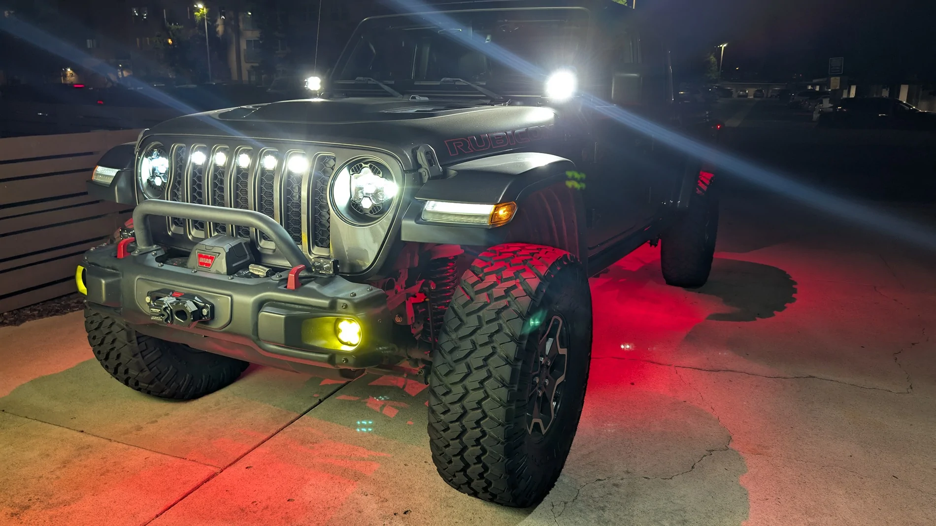

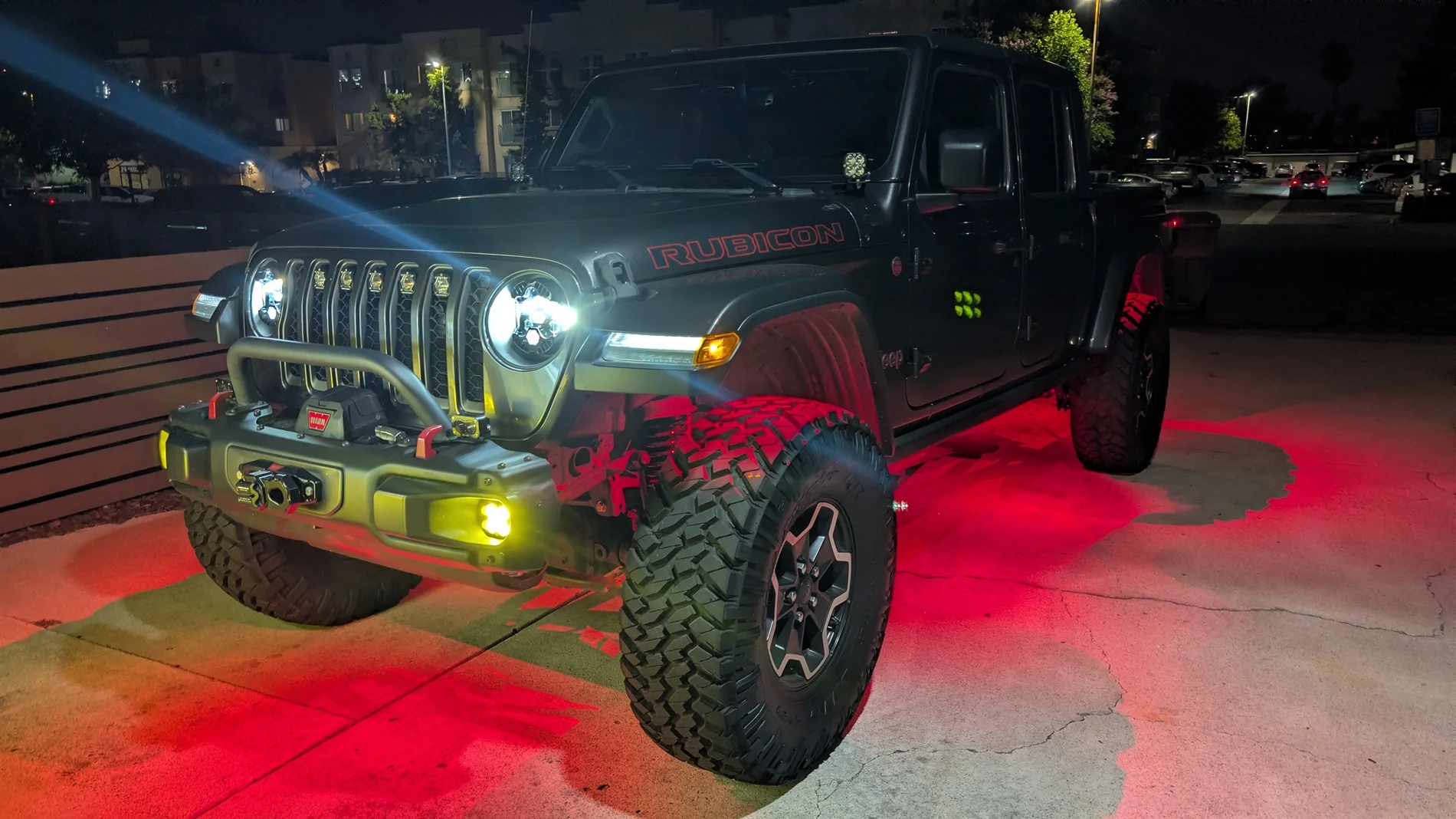

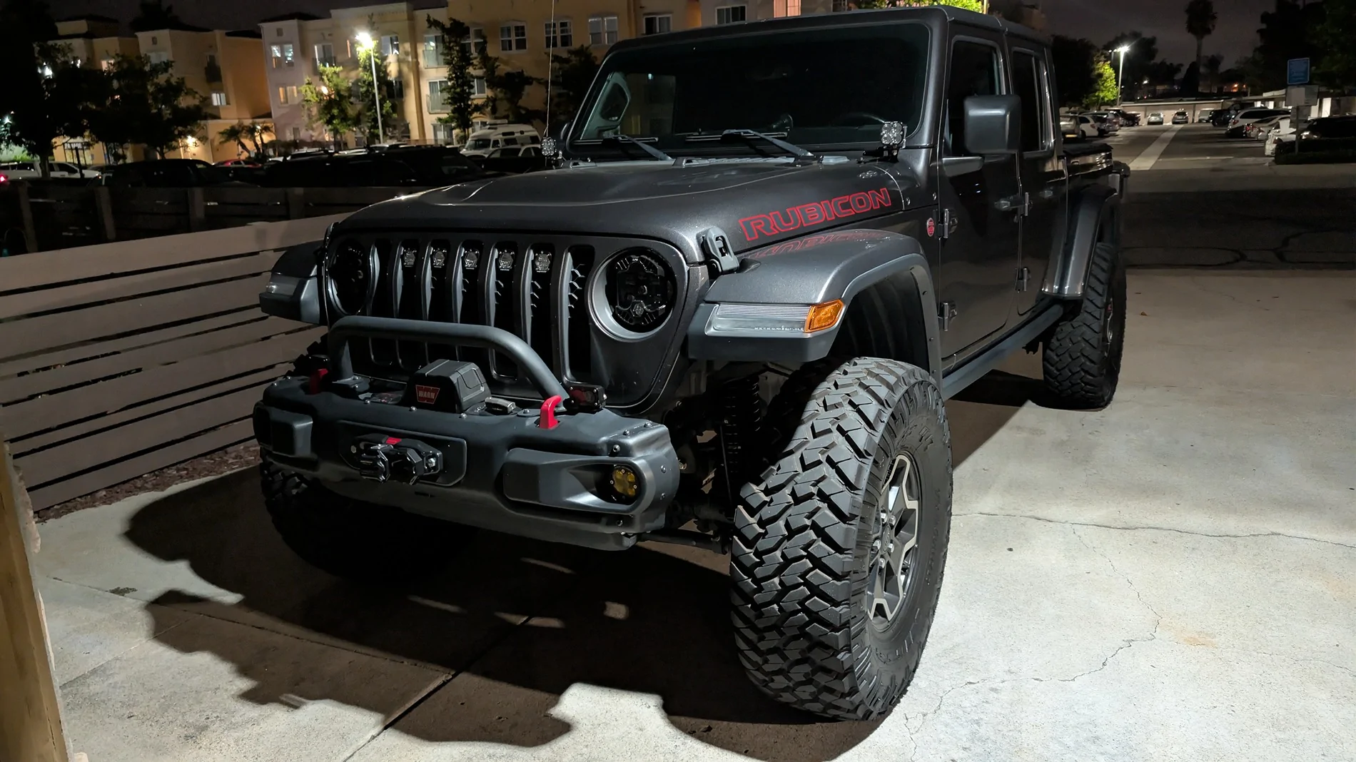

I've been very lucky and have had an incredible experience with Bent Motorsports and Lakebed Innovations. Baja Designs lights all around. He's the list:
LP6 DOT headlights
(2) S2 IR lights
(2) Squadron Sports
(5) S1 in the grill from Lakebed Innovations
(2) S1 rear bumper lights
(10) Red Rock lights
(1) Red done light
(2) SAE dog lights
They are incredible lights and I've been very happy with their performance. The LP6 headlights aren't as bright as the stock led lights but they are good.
Led's always look different in pictures but here are some shots. You can see better pics in some of my other posts.
Jeep Gladiator Ideas for lights for my new ride PXL_20260618_034851180
Jeep Gladiator Ideas for lights for my new ride PXL_20260618_034924641
Jeep Gladiator Ideas for lights for my new ride PXL_20260618_034943358
