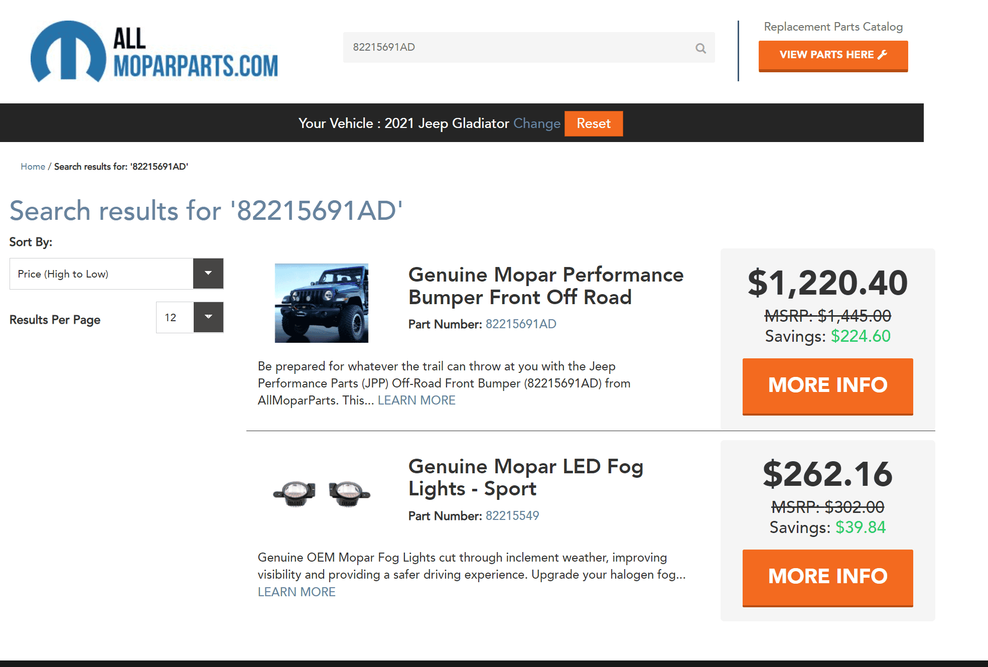

Looks promising:
  • Fits Sport (MB1) and Mopar steel bumpers such as 82215691AD.
  • Does not fit Rubicon-style three piece steel bumper.
https://www.allmoparparts.com/sku/82215549.html
This is your bumper, right? 82215691AD?
https://www.allmoparparts.com/sku/82215691ad.html
Since AllMoparParts says they work, you should be covered.
When you search that bumper, they even show those fogs:

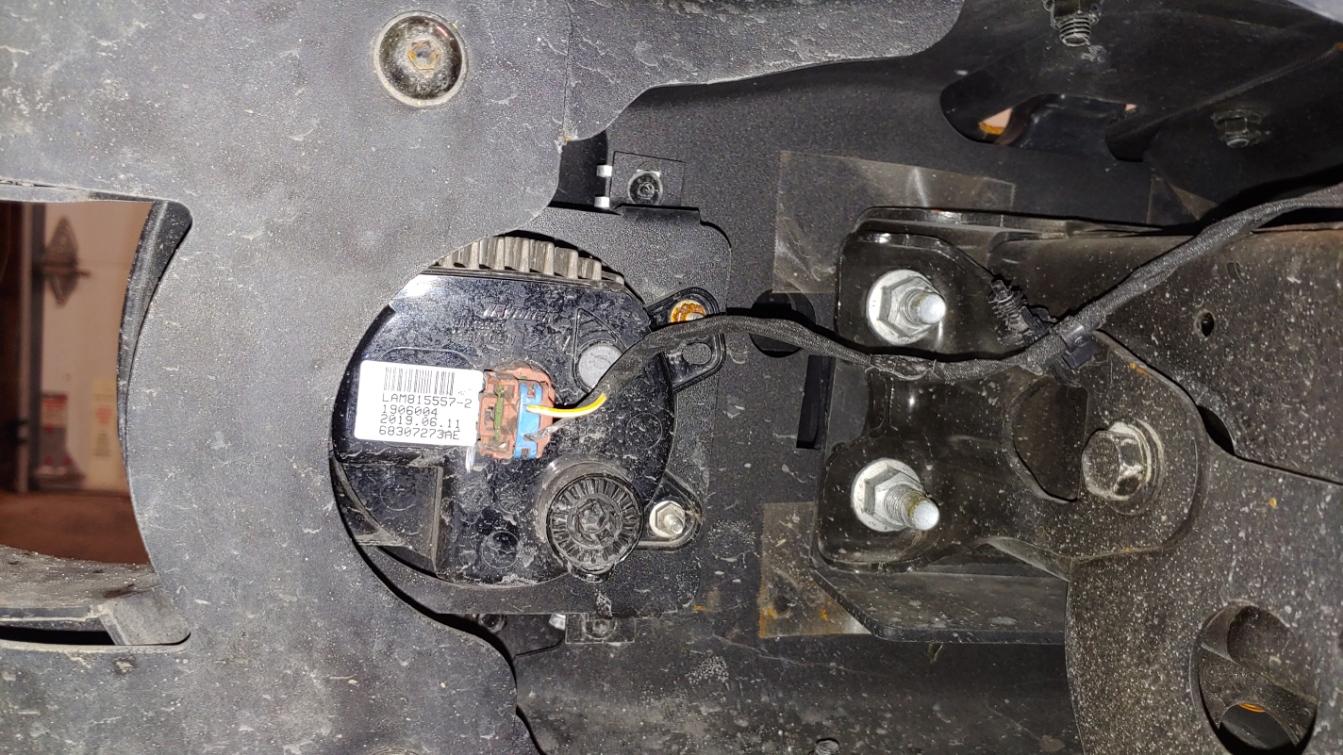

That is the bracket kit I bought on Amazon to use the factory Rubicon LED fogs in the HD bumper. LED fogs were pulled out of my stock plastic bumper.
Again, been a year and no shake, hasn't lossened, no issues.
I did order this, thank you again. I will try there first and hope that it will work with the factory LED lights.
40,514
54,044
Looks a lot like the bracket I use. Mine uses the 4 tabs on the light and screws to the bumper with 2 screws.

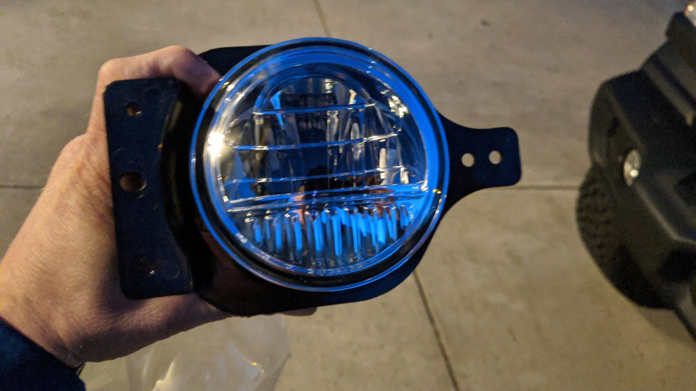

I got some led fog lights that are close to factory that i was running but couldn't run them on my Rugged Ridge bumper. They fit on my stock bumper though and the stock bumper had Halogen lights. I'd be willing to send them to you for the cost of shipping. I got nothing in them, they were sent to me by a company that makes lights. Let me know if you want them to see if they will work. Here's a few pictures of them
Jeep Gladiator Purchased a brand-new Rubicon bumper for my gladiator Rubicon. What do I have? MVIMG_20200313_202805
Let me know if your want them. I got no use for them at the moment. Not sure if they will work or not but it may be worth a shot.
Jeep Gladiator Purchased a brand-new Rubicon bumper for my gladiator Rubicon. What do I have? MVIMG_20200302_185013
Thanks bud, I ordered a bracket to hopefully be able to use my current lights on the bumper. I will let you know if that doesn’t work. Thank you so much I truly appreciate your offer.
