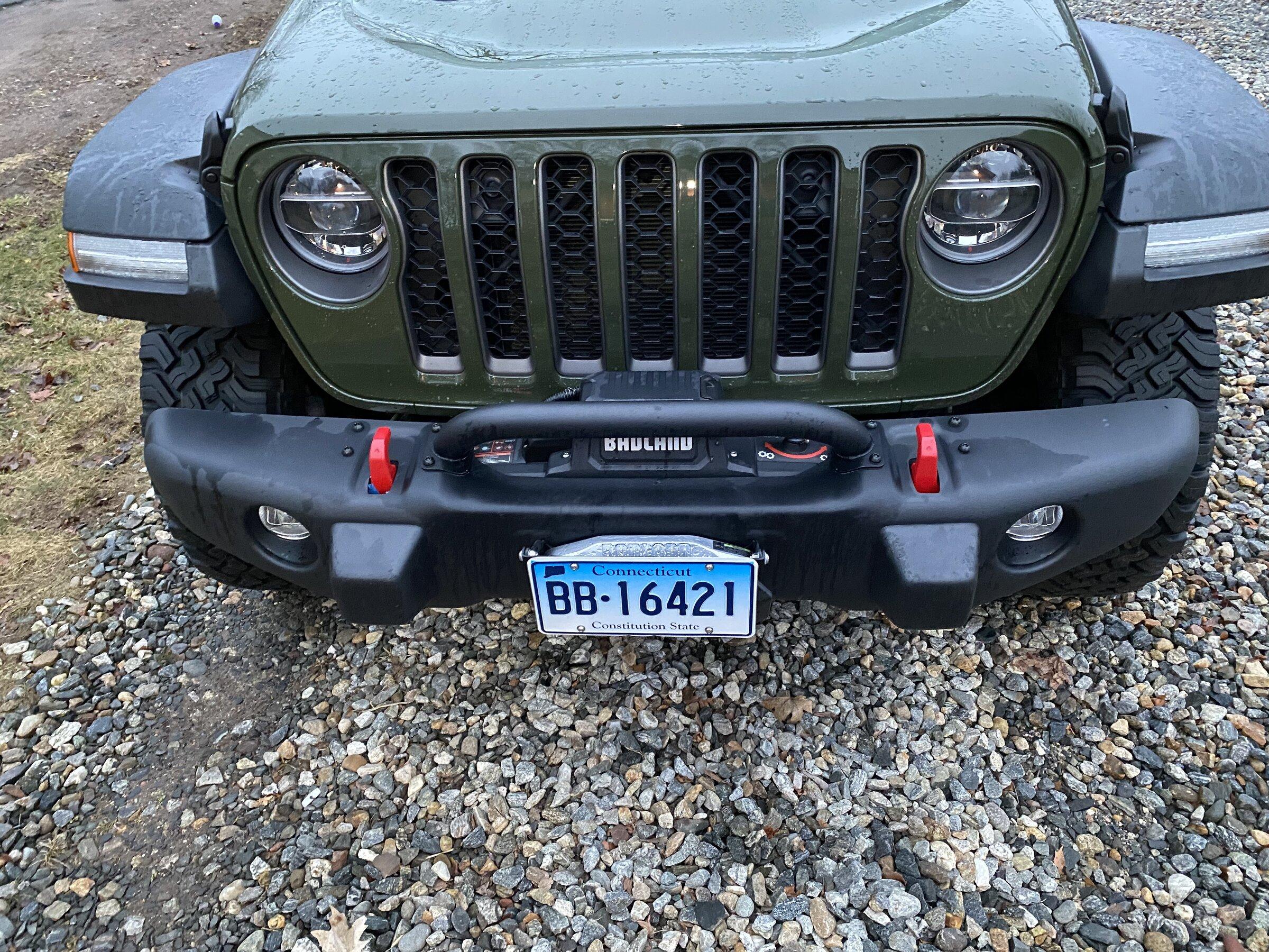

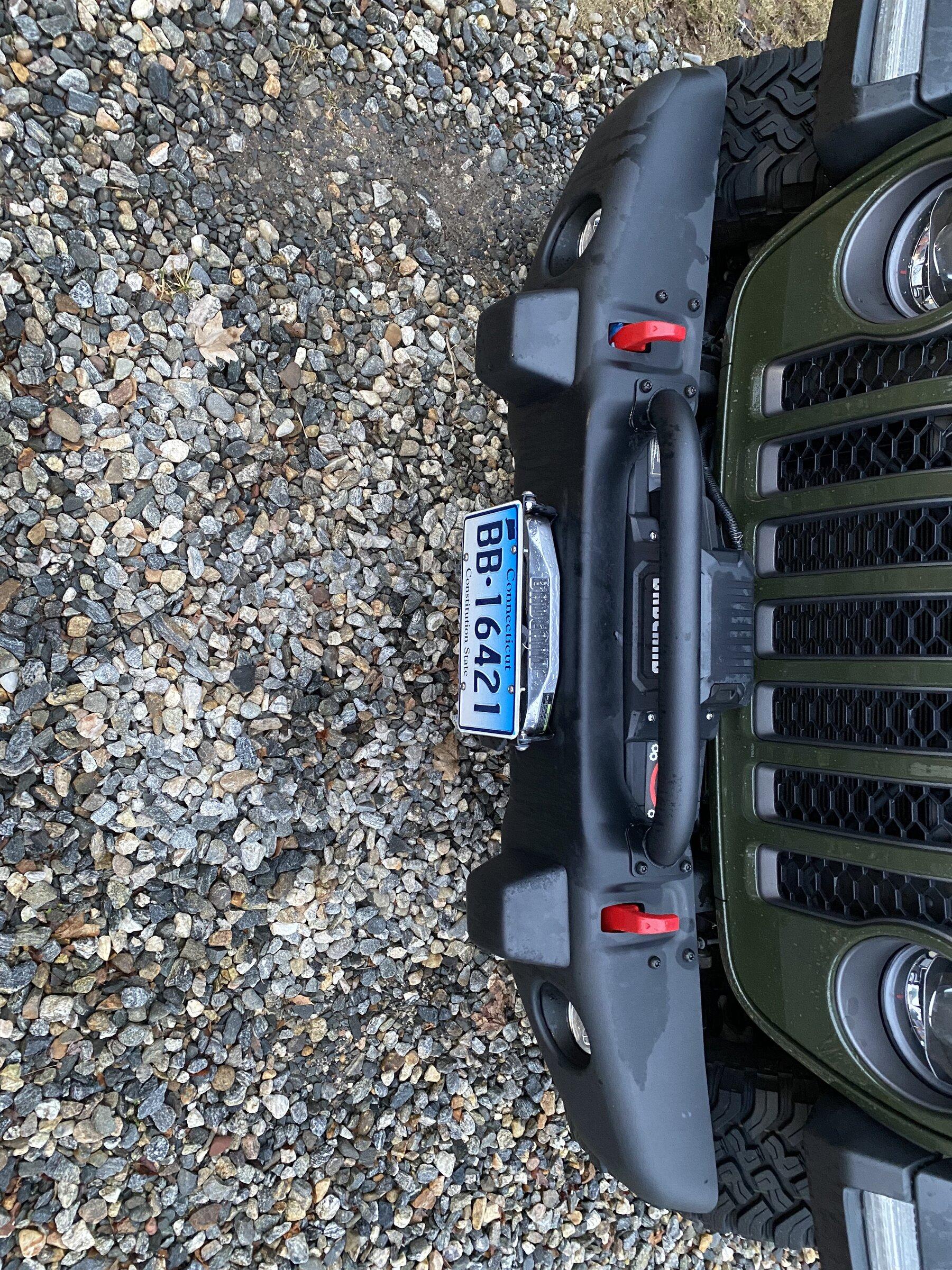

I have that bumper on my JTR. Ordered it separately when I picked up my truck. I asked for the metal factory bumper not realizing they offered 2 different versions.
Any ways, it is a very heavy duty bumper. I was able to re-use the factory LED fogs with an adapter I bought from Amazon. Worked perfect. Fog lights have been rock solid with the adapter, zero shake. I did need to modify the bracket a smige, enlarge a hole I think.Moved the red hooks to the new bumper. The rubber/plastic bumps have helped protect it a few times. Plate holder is from Quadratec too.
https://www.amazon.com/gp/product/B01MRISD6W/ref=ppx_yo_dt_b_asin_title_o06_s00?ie=UTF8&psc=1
I also have the winch protector hoop on mine, factory short one. I have the HF Badlands 12K winch, cheap, reliable and for the amount of times I will use it made more sense then the Warn. $425.00 out the door. Winch plate is from Quadratec.

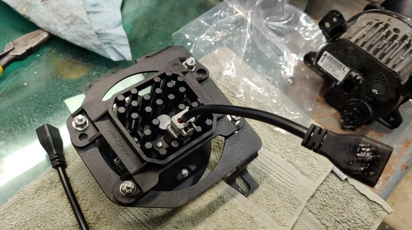

If you ordered the Rubicon with the steel bumper you got different fog light configuration as far as mounting.
So there are two factory fog light mounting methods -
Sport, Overland, Rubicon with plastic bumper
Rubicon with steel bumper.
The picture below shows the Overland type plastic bumper fog lights with a steel adapter bracket for the Rubicon steel bumper - the 4 holes would be used directly on the plastic bumper, the Rubicon steel bumper uses 2 holes, seen on the towel on the metal adapter here -
