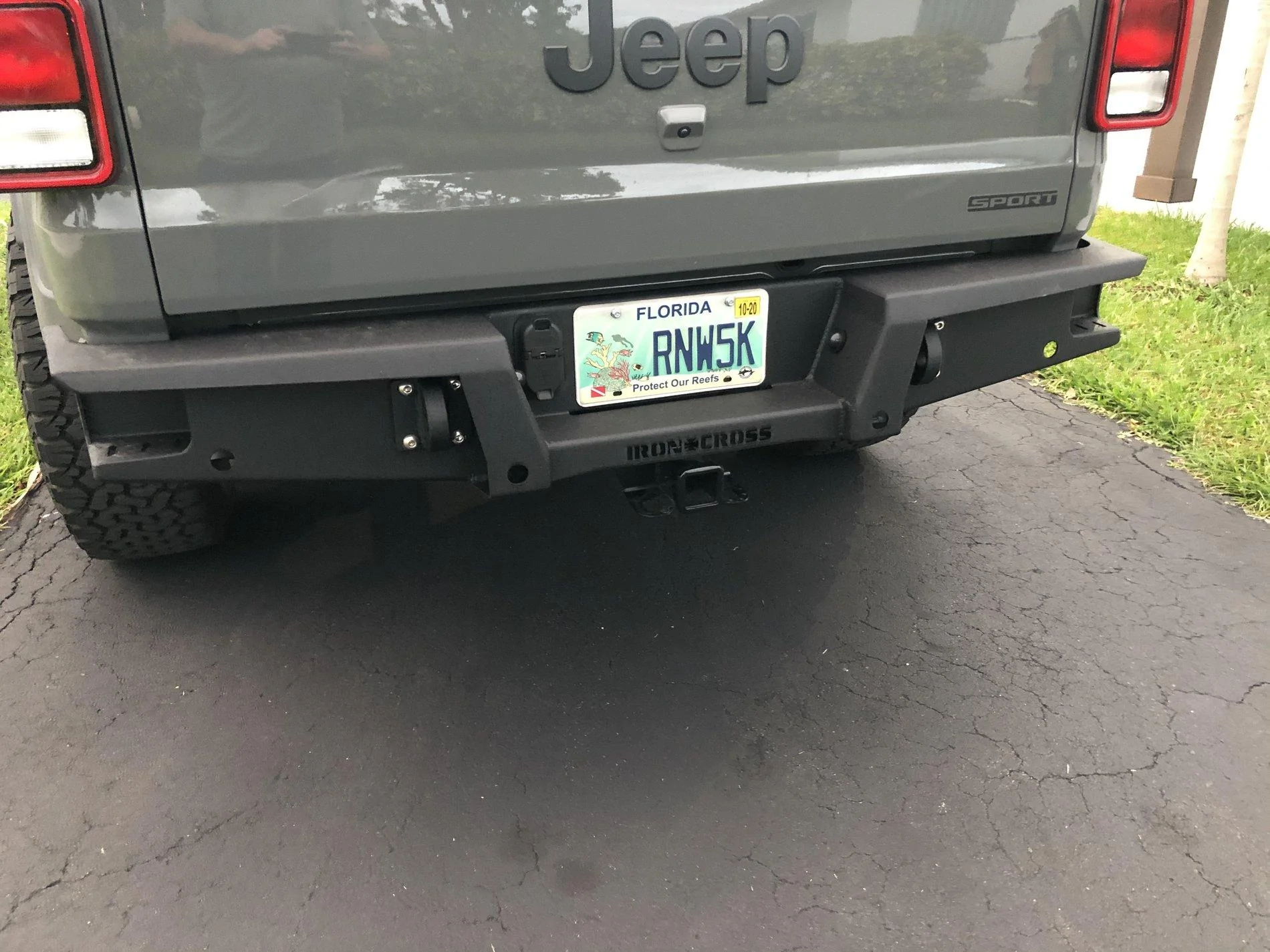

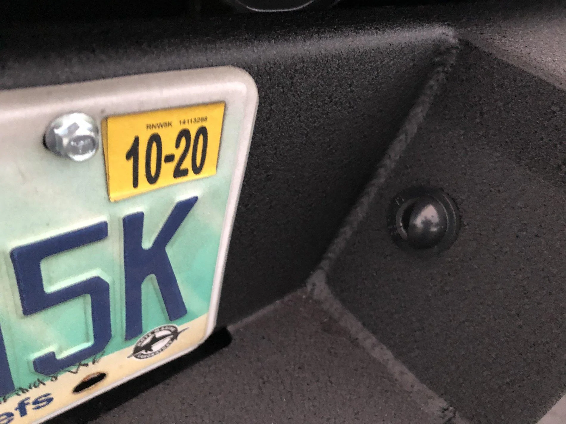

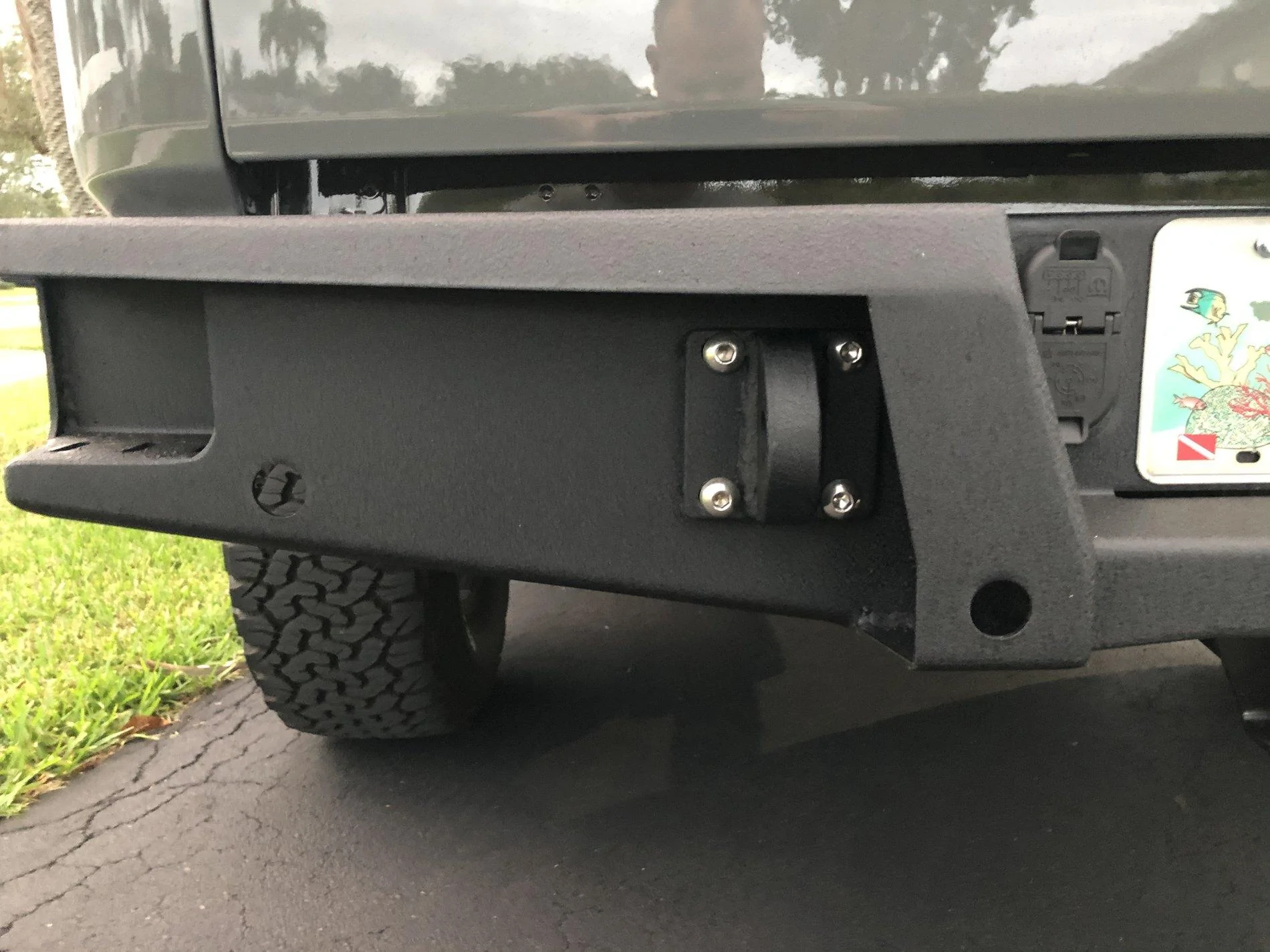

I just installed the Iron Cross rear bumper. I really like it but have 2 complaints I’m hoping you guys can help me with.
1) the cheap Fks, provided the cheapest 1.25” round license plate lights ever made. And the drivers side lights up the trailer plug really well but that’s about it. Would it kill them to spend $5 on some led ones. With that said, they are harder to find than you would think. Should I just put led bulbs (192 bulb) in them or anyone know where I can get sealed led lights to replace these with?
2) there is four 1.15” (1 1/8) holes that I’m guessing is for the park distance sensors, which I don’t have. I’m at a loss as what to use to plug these holes. But I think they look terrible so I have to do something. They seem like somewhat of an odd size so my initial thought I’d those trailer marker lights are all 3/4” so they won’t work. I’d like to get lights that I’ll hook up to the reverse lights but would settle for plugging them if necessary. Any creative ideas out there?
Aside from the above I really like it. My only design change would be to have the mounting plates also bolt to the frame rail where the factory tow hooks bolt on. But that’s probably overkill. It has built in cutouts on each corner for square lights but I think I’ll leave them open so I can use them as a step.
TIA

Here is some pics
Jeep Gladiator Need help/ideas for Iron Cross rear bumper 347303EB-08FB-4139-917A-FD726E1812DF
Jeep Gladiator Need help/ideas for Iron Cross rear bumper 6931EB0B-AC6D-4468-81A9-86137810B7B2
Jeep Gladiator Need help/ideas for Iron Cross rear bumper 4C8F1BB2-65E1-41FF-B90F-D42FBC9093D6

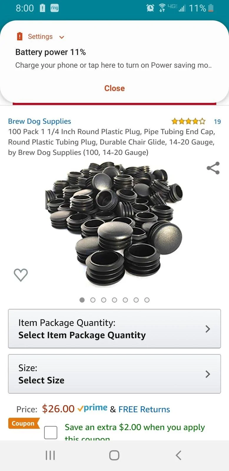

This should work. If not, there are some 1" ones on amazon too.
Jeep Gladiator Need help/ideas for Iron Cross rear bumper Screenshot_20191220-200057_Amazon Shopping

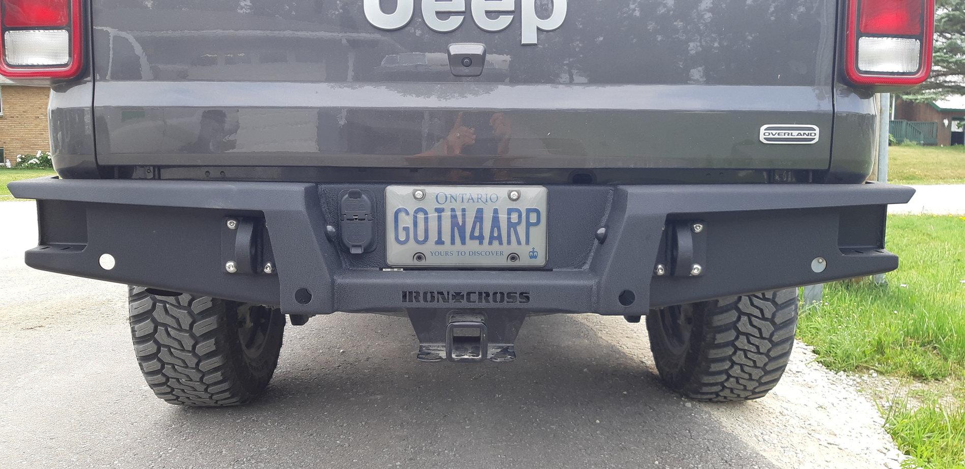

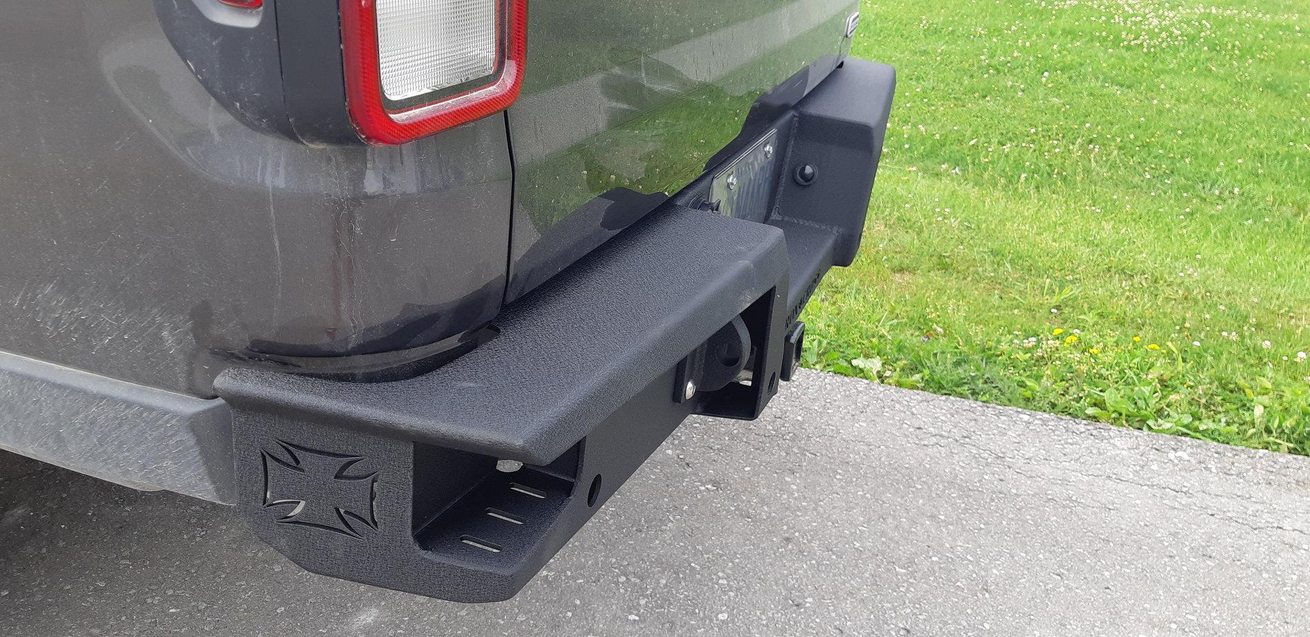

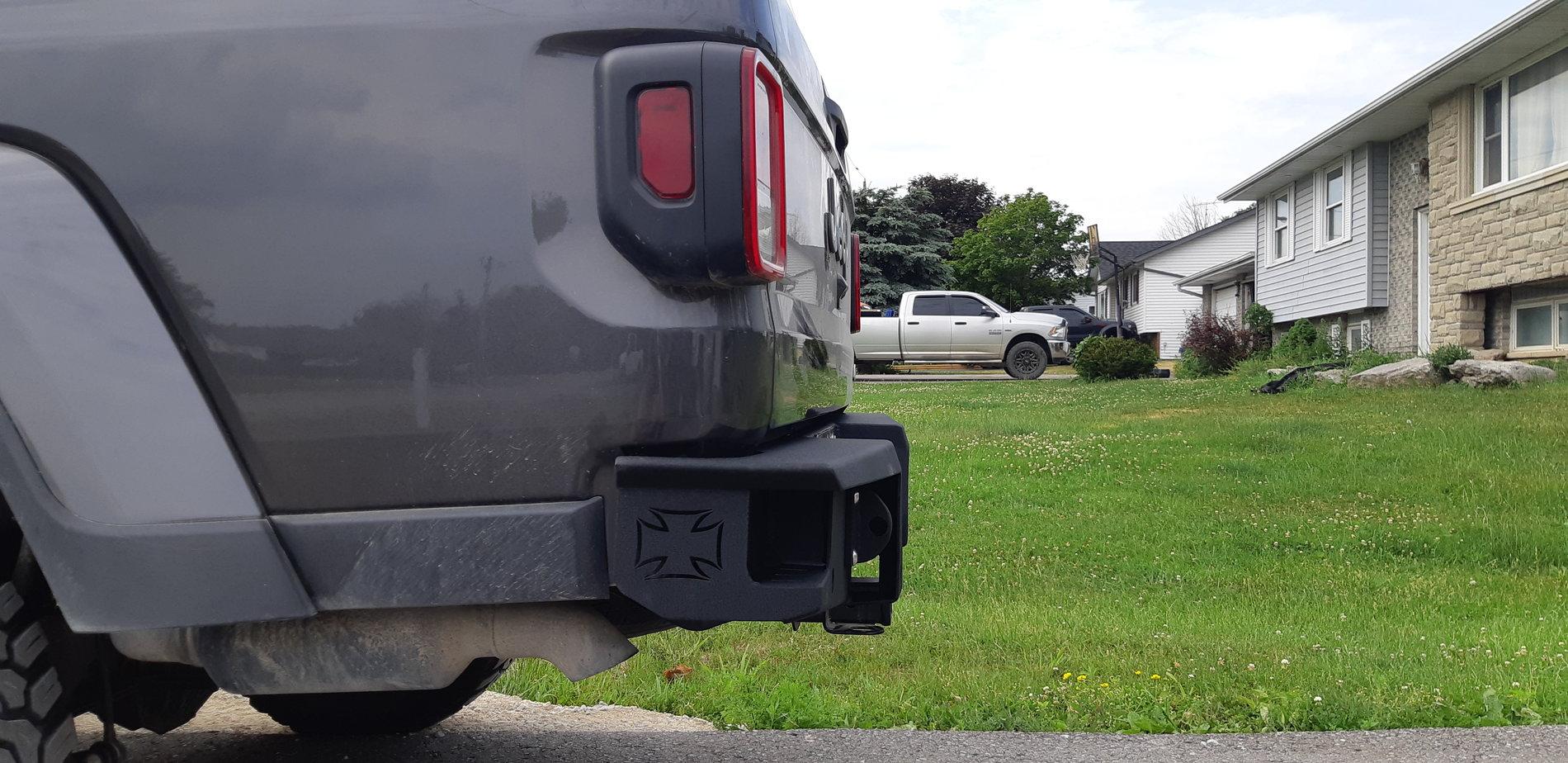

I just installed this Bumper too. They Definitely cheaped out on the license plate light.
I thought it was odd the hardware has 1/2" Stainless washers and Allen bolts, but regular lock washers and regular nuts. I changed the nuts stainless steel.
The bumper realy matches the body lines of the Gladiator.

I was thinking about this bumper in the future, looks like you can get 1 1/8 round plastic plugs off Amazon for under 10 bucks, and I was partial to seeing if I could integrate the oem led lights,( I have the tazer so on backup they don’t bother me) I also noticed Hooke Offroad on Amazon has same bumper as a fraction of price just no iron cross cutouts

After a year of this bumper I can say with confidence that it’s mall crawler material. Don’t use the D ring mounts unless you want to bend the bumper mounts. It’s weak, if you get mildly stuck, pull from the hitch.
