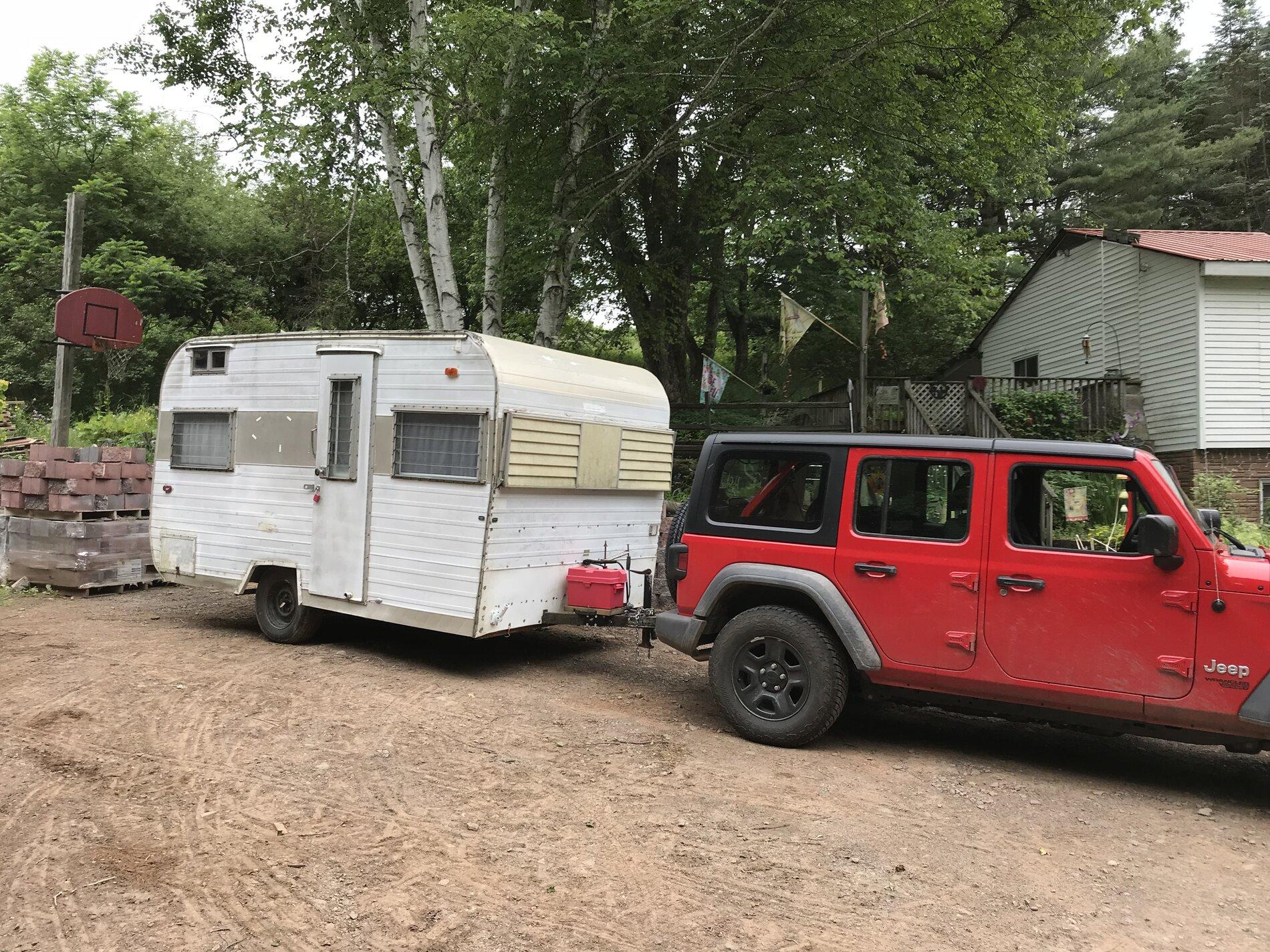

I have a dump trailer that I pulled with a JKU with a MT loaded it weighed 3400 pounds it did fine even at 70 mph. I also pulled a vintage camper with it. You rarely use sixth on the interstate. I now have a Willys Gladiator and will be pulling my dump trailer loaded later this week.
You’re planning to pull that camper? That’s a very similar setup to what im planning.
Believe it or not I pulled that camper with a two door not very far and defiantly not fast, the four door pulls the camper great I am thinking the Gladiator will be even better. Like other posts have said it is how you load your trailer, as long as you have the proper weight on the hitch it will be fine. Mark
