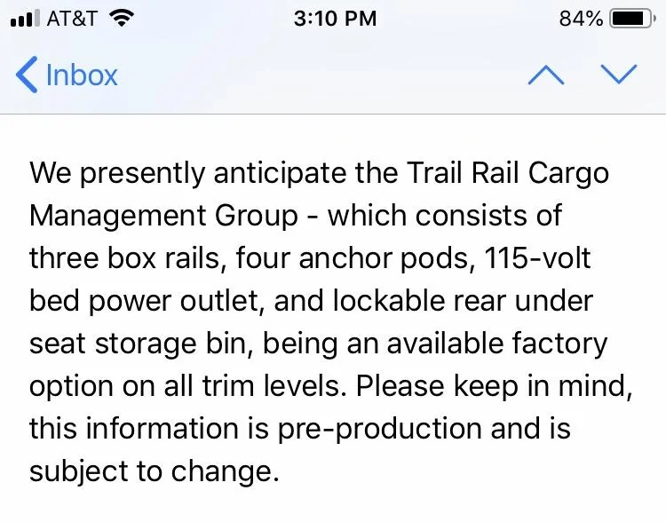

Not so certain about that. I called a guy from Jeep about this very same issue as I also would like to get the trail rail system on a base Soort model. And the build site does not show that it is available for a Sport model. And we had some emails back and forth about this. Long story short he told me in 2 separate emails that the trail rail system would be available on “all” trim levels. See the attached email.
I wanted this for a couple of reasons. I like the idea of being able to lock things underneath the rear seats. And I would like to have the 4 tie down points in the truck bed. This should be a standard thing in any pick up bed. Don’t really need or care about the bed power outlet.
But I also was trying to find a if I would have to have that trail rail system in order to also then get the Mopar hard trifold tonneau cover. It’s more than difficult to get anyone at Jeep or at Mopar to say if that will be required. And I’ve never seen a picture of that hard trifold tonneau cover. But hey the guy says I can get a trail rail system on all models, includes the Sport. So hopefully he has given me some correct info. I will ask my dealer to order both trail rail system plus that hard tonneau cover when I get them to order one for me.
Like everyone else in the world I am waiting for confirmation of pricing before I order.
Hope this info from the Jeep guy helps you & I hope it’s correct.
If you don't need the power outlet or if the wattage is too low for what you might want it for why pay $1000 for the factory option for the trail rail system? You can buy just the rails from Mopar Parts for about $350. Save that $650 and get a real inverter.
