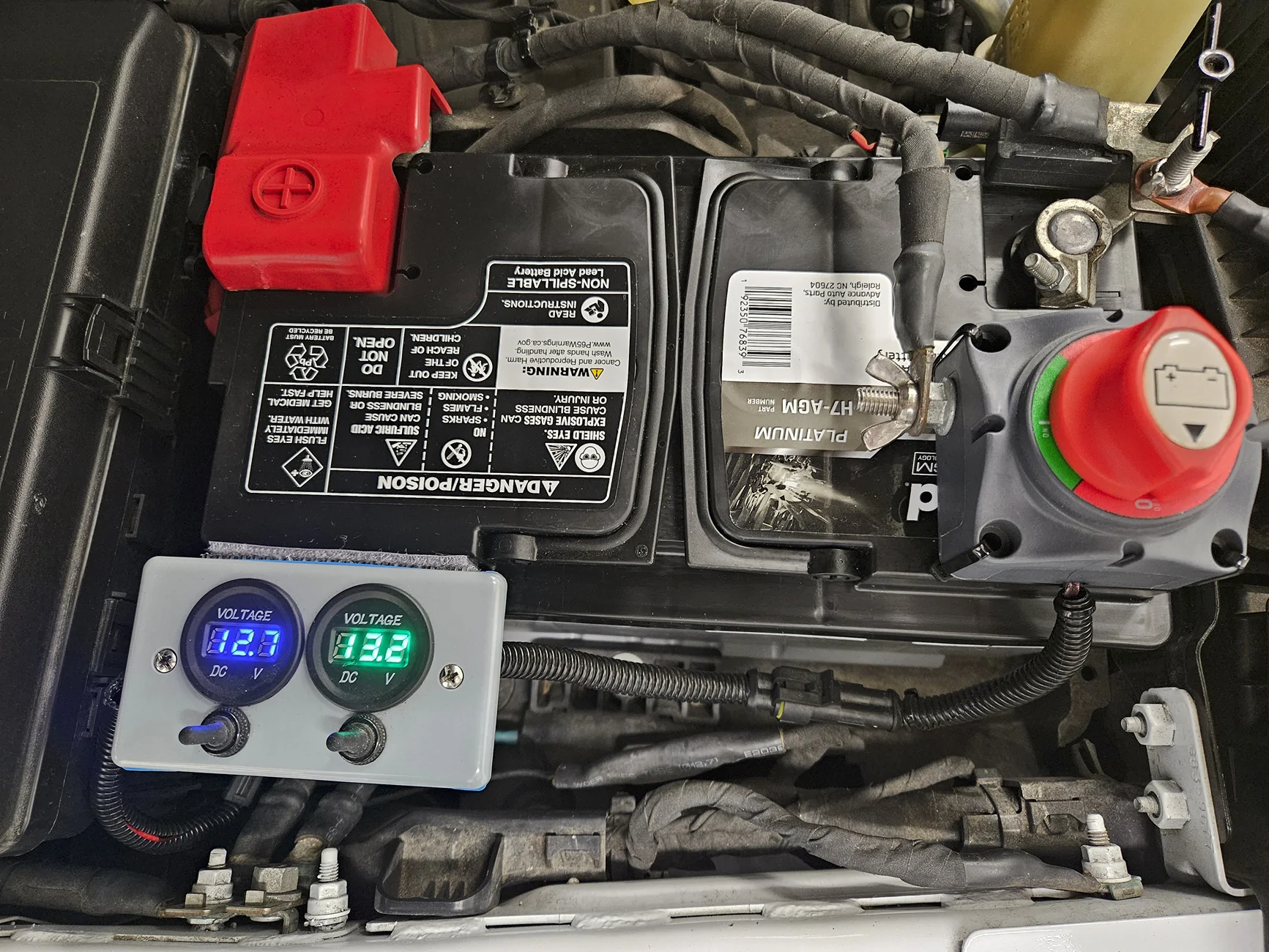

I installed a set-up few years ago. Works great!
I can see voltage of both Aux and Main.... can separate batteries.... can charge separately .... and I have Aux bypassed. I can toggle Aux if I opt to.
Thanks again, @jebiruph who assembled the kit for me.

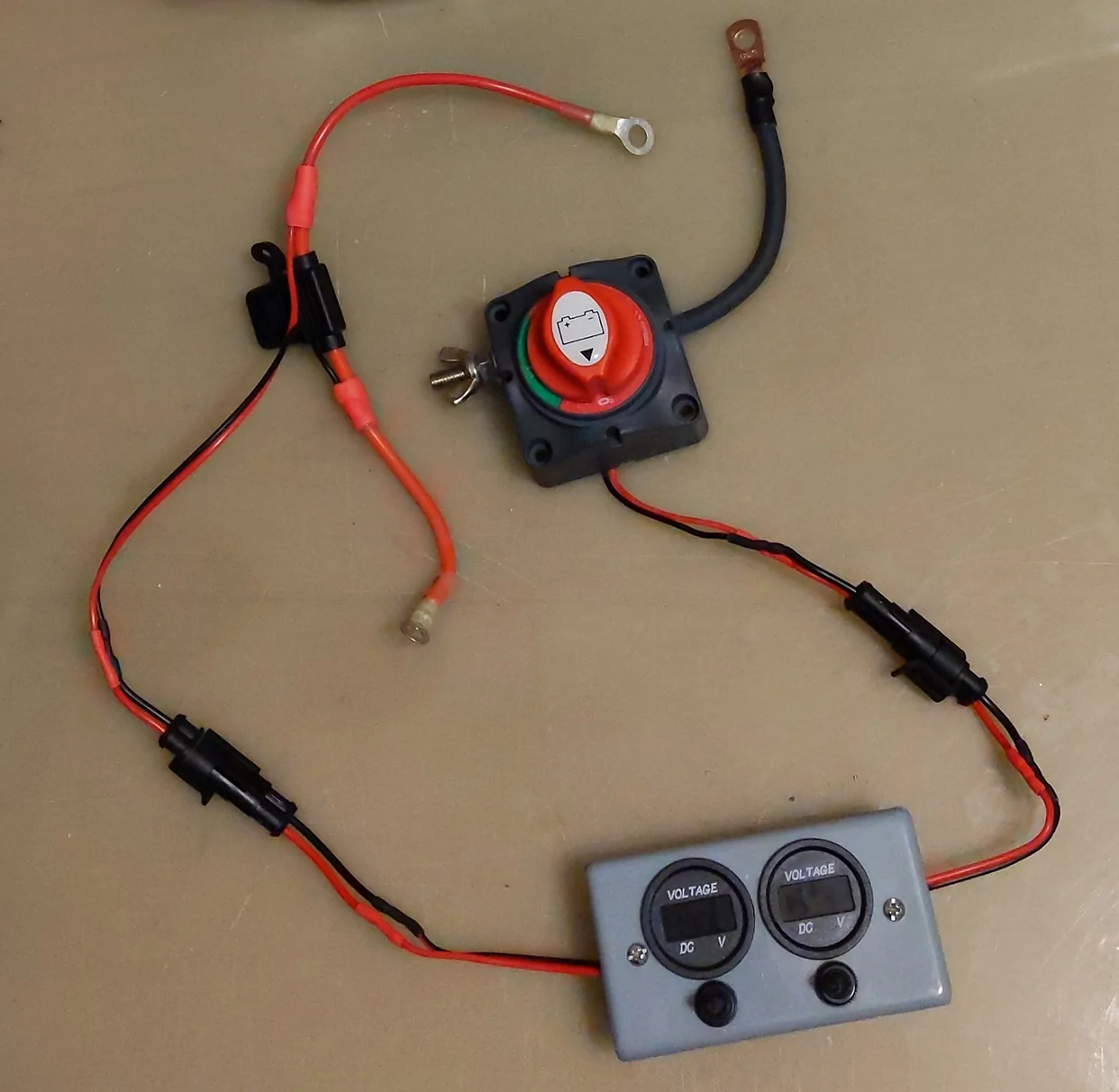

Here is the new simplified version with one voltage gauge and one switch and without the jumper or battery switch.
Jeep Gladiator Install auxiliary battery disconnect in 5 minutes jt battery monitor 2
Jeep Gladiator Install auxiliary battery disconnect in 5 minutes jt battery monitor 1

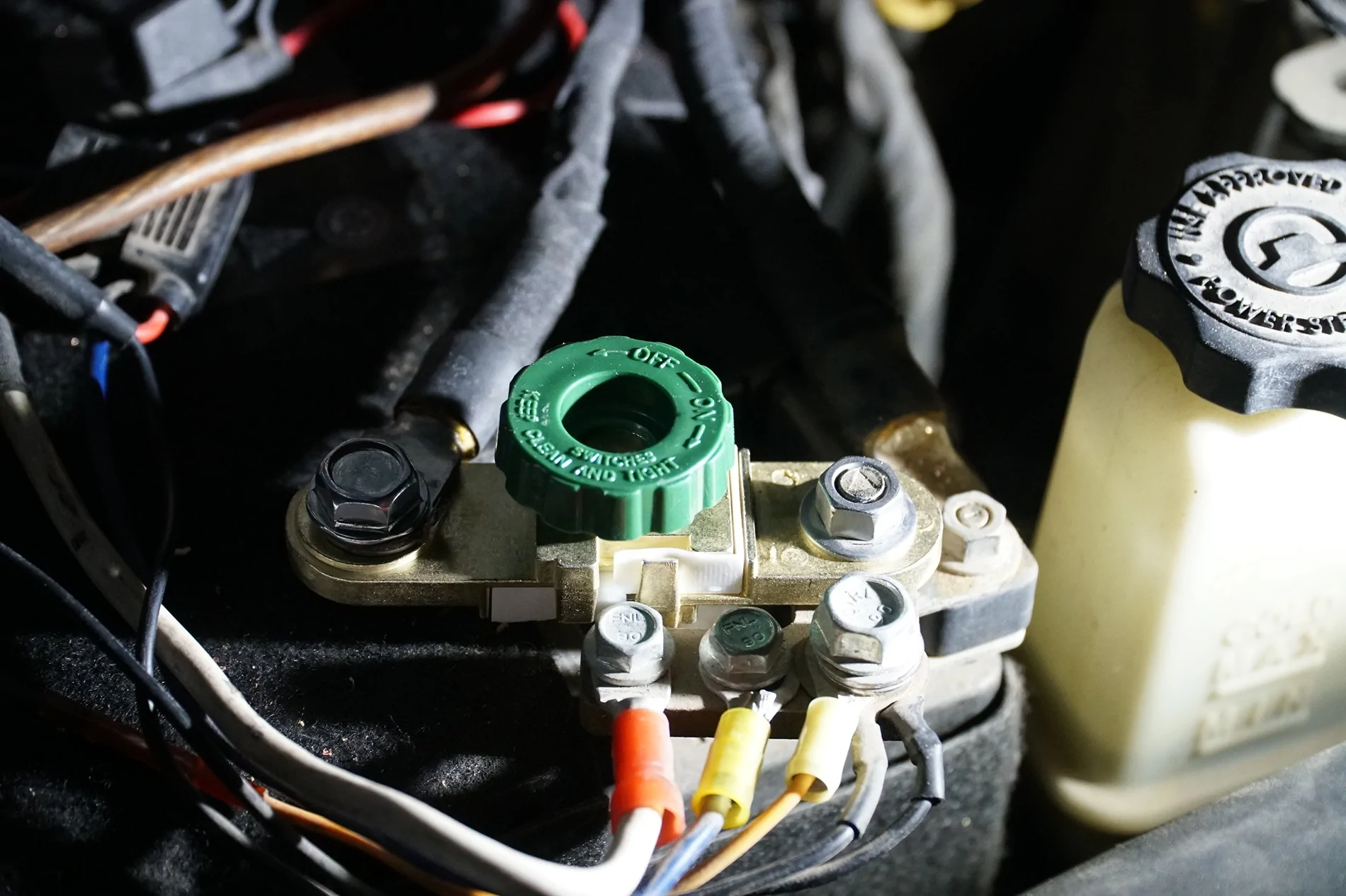

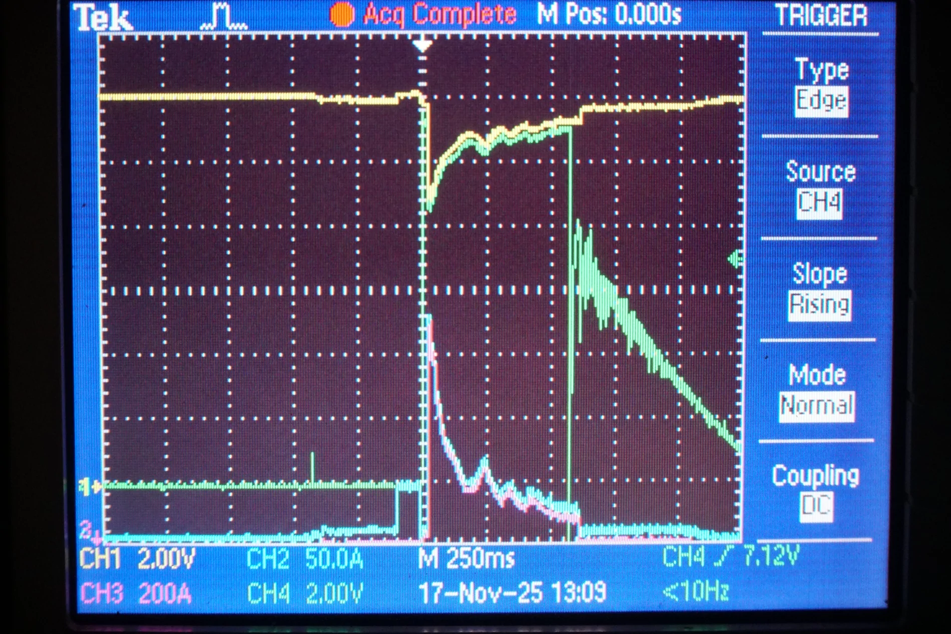

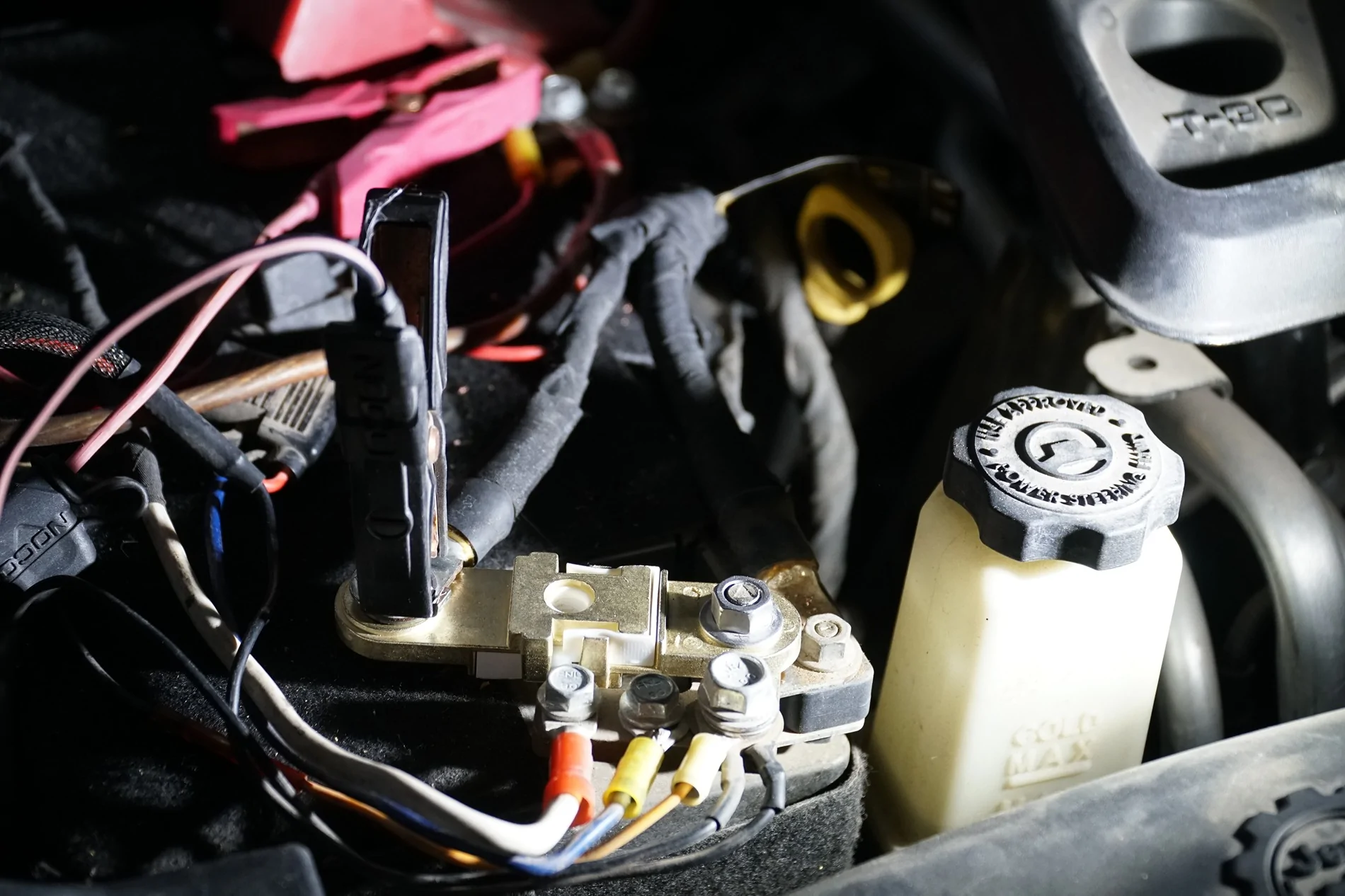

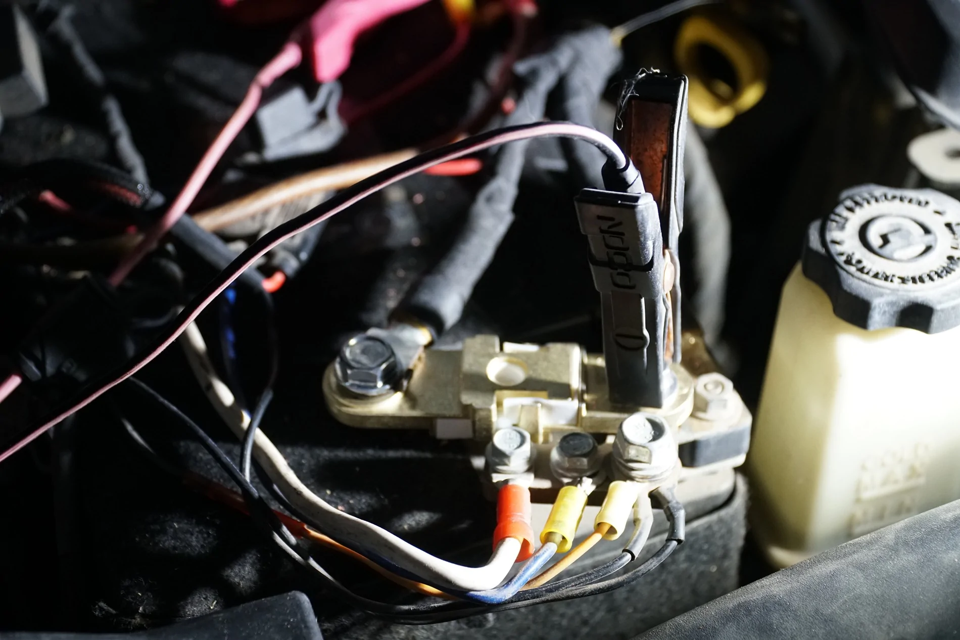

This is the ground for the aux battery. The shunt is 75mv at 150A. 80mv is 160A peak for the aux ground.
Jeep Gladiator Install auxiliary battery disconnect in 5 minutes DSC05596
Jeep Gladiator Install auxiliary battery disconnect in 5 minutes DSC05599

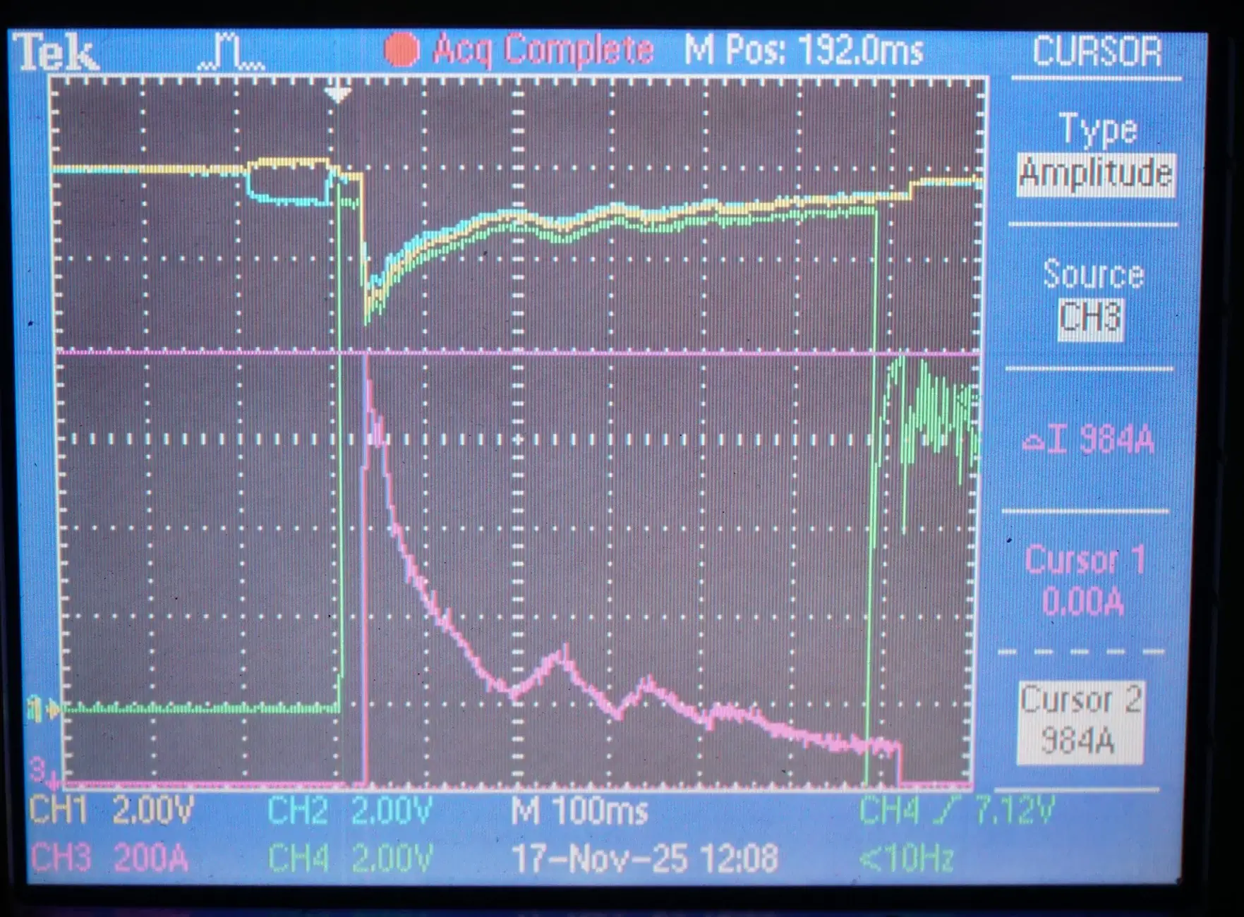

Something is amiss - accuracy or whatever.
I can believe a microsecond spike in the hundreds of amps, but no way these pull more than a 4.5" massive Motorcraft starter cranking over a cold 390 for any period of time perceivable by man.
800 is a pretty large spike considering all that the current does is:
Operate the pull-in and hold-in windings of the solenoid, after which time the pull-in windings are taken out of circuit (if these solenoids even HAVE two windings)
And - operate the armature of the starter since there are no field windings.
It's an initial 'short' when the armature is connected by the solenoid and stationary, as soon as it moves, that changes. (not truly a short, but for all practical purposes it appears as such)
Wouldn't the dual batteries, the higher voltage of the AGM battery, the high compression of the 3.6 and a smaller starter all contribute to higher starting current?

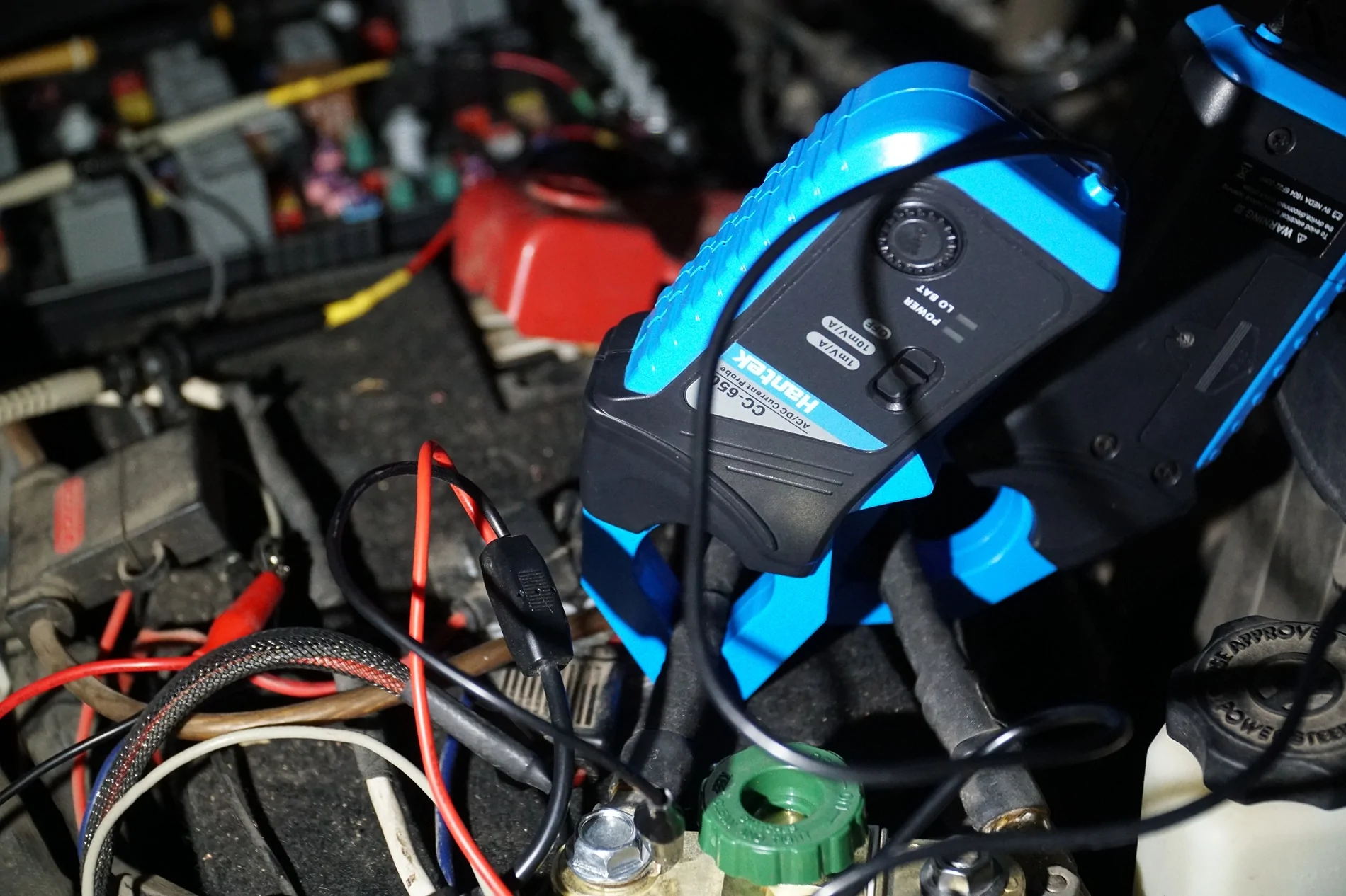

Now add the clamp on meter. Channel 2 is shunt, channel 3 is clamp on.
Jeep Gladiator Install auxiliary battery disconnect in 5 minutes DSC05602
Jeep Gladiator Install auxiliary battery disconnect in 5 minutes DSC05603
Jeep Gladiator Install auxiliary battery disconnect in 5 minutes DSC05600

Shunt reads 75mv = 150A peak, and clamp on reads 154A peak.

Starter cable channel 2, aux ground channel 3. Next is main ground 2 and aux ground 3. Next two images
Jeep Gladiator Install auxiliary battery disconnect in 5 minutes DSC05607
Jeep Gladiator Install auxiliary battery disconnect in 5 minutes DSC05609
Jeep Gladiator Install auxiliary battery disconnect in 5 minutes DSC05615
Jeep Gladiator Install auxiliary battery disconnect in 5 minutes DSC05616
main ground 2 and alternator 3.
