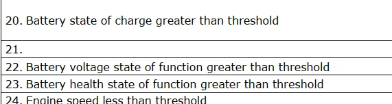

1.a. ESS cares about the crank battery, but tracks the aux as well. It knows the state of charge and voltage of each. If it detects any issues, it either will NOT stop the engine, or will restart it before it's too late. ESS monitors a crazy list of stuff - including voltage. If it decides a whoops is coming, it will avoid a stop, or will start it before too late.
Here is a small sample of the things that have to be "just right" for ESS to shut the engine off - or if things fall outside of a range when it's ESS stopped, will cause a restart - see - if knows the battery state at each stop -
Jeep Gladiator Auxiliary Battery Jump 1655398574588
If you disable the ESS when you start it - it really makes no difference on things. It simply means it won't shut off if all of over a dozen conditions are met. It won't make any difference otherwise.
