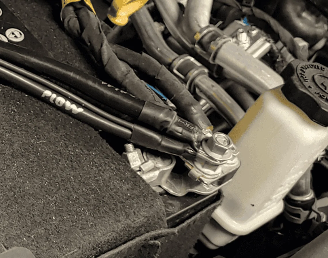

I'll have to verify the layout- which cable is which - on my 2022.
They LOOK exactly the same - same studs and stud sizes, two cables, one bolted to the IBS and the other bolted to the first via the taller stud, but can't say if they switched them around as to which one is the chassis ground and which is the aux battery ground.
The body ground cable is a thicker cable than the aux battery cable, or so I've heard.
I had my PDC off when I did my Aux switches as well as the entire battery tray to get the grommet nippe.....the cables didn't make sense based on the videos I was watching....which were for 2020s. I'll see if I can find the link.

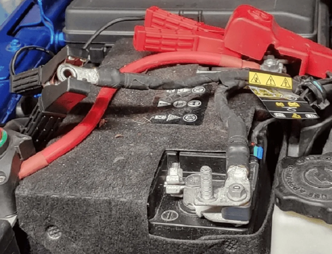

Is the upper negative wire shown at the diagram at the crank battery the aux battery ground? I don't want to tear into the cable connections to determine that if I can help it.
40,496
54,011
The diagram is representative - it appears at some point there was a change as to which cable was which, but in this picture - the cable connected to the other cable via the tall stud is the auxiliary battery ground.
The cable still on the IBS in the pic below goes to chassis grounds.
Jeep Gladiator Auxiliary Battery Jump 1669160940577
It would be pretty easy to determine- remove the cable as I've shown (just a single nut (12mm wrench) holds the cable in place.
A volt meter on the positive post of the crank battery and the ground stud on the fender would show 12v if you removed the aux ground cable.
