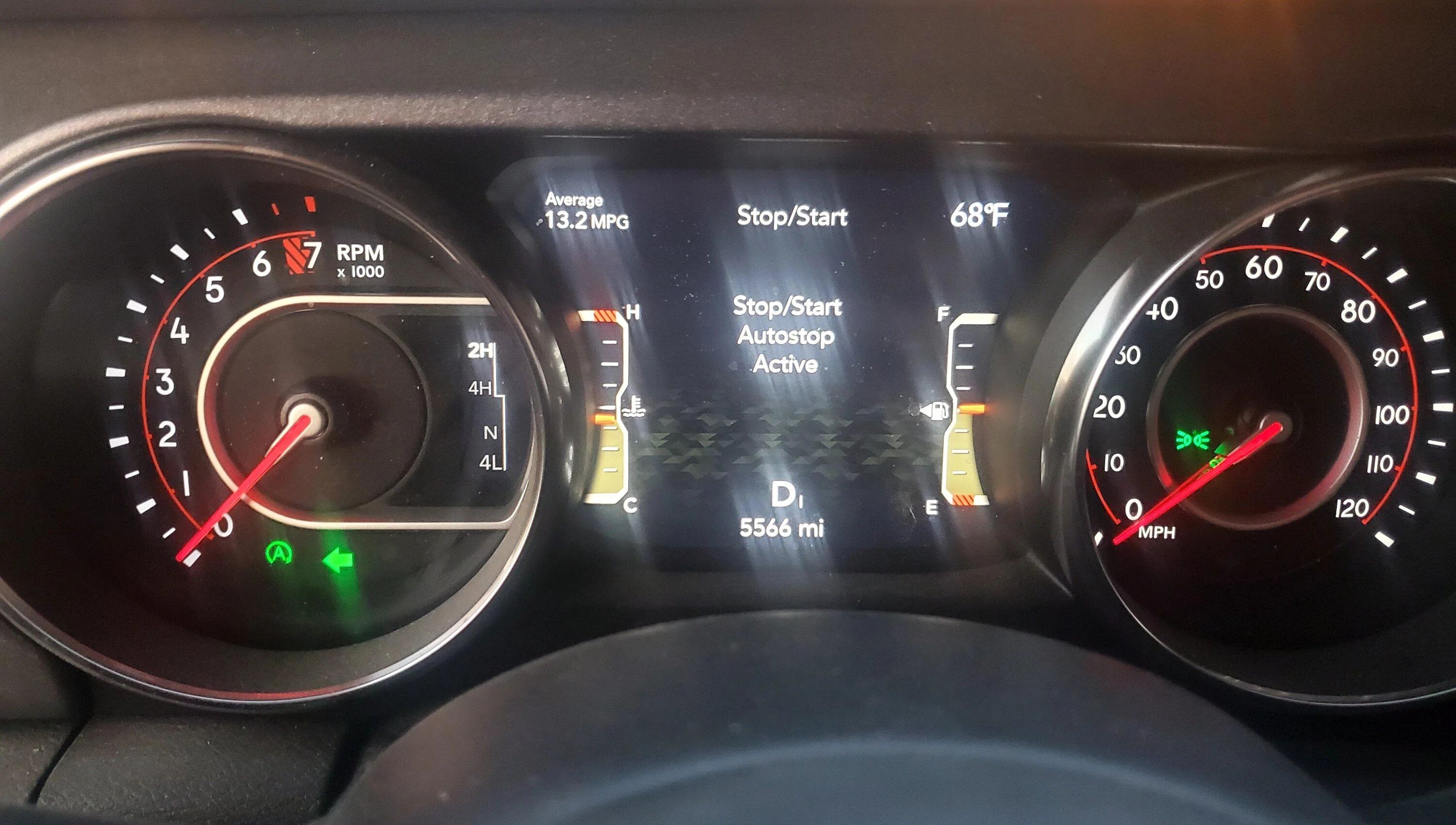

@ShadowsPapa just to be sure....lol....I went out and tested it. I figure if it's working now it will work through Sunday and isn't dead. Lol.

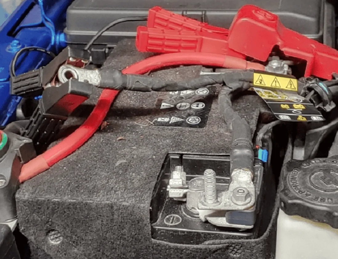

If you don't have a jumper, you can just disconnect the aux battery ground from the main battery to prevent a dead aux battery from holding the whole system down when jumpstarting. The ESS error light will turn on, but you can worry about that after you get home.

So in my case....2021...disc the aux from the fender ground. It doesn't go to the main neg.

I can't speak for diesel, but for gassers, the ground for the aux battery goes to the top of the IBS on the crank battery, then another cable goes from the top of the IBS to the fender/chassis ground stud.
In this pic of my 2020 (3.6 GAS), you can see I have disconnected the aux battery ground from the top of the IBS and have the negative charger clamp on it to charge ONLY the aux battery.
The other cable (on top of the IBS) still on the negative crank battery post is the cable that goes over to the chassis ground stud between battery and body.
There's a change in 2021 3.6....I'll take some pics.
I'll have to verify the layout- which cable is which - on my 2022.
They LOOK exactly the same - same studs and stud sizes, two cables, one bolted to the IBS and the other bolted to the first via the taller stud, but can't say if they switched them around as to which one is the chassis ground and which is the aux battery ground.
