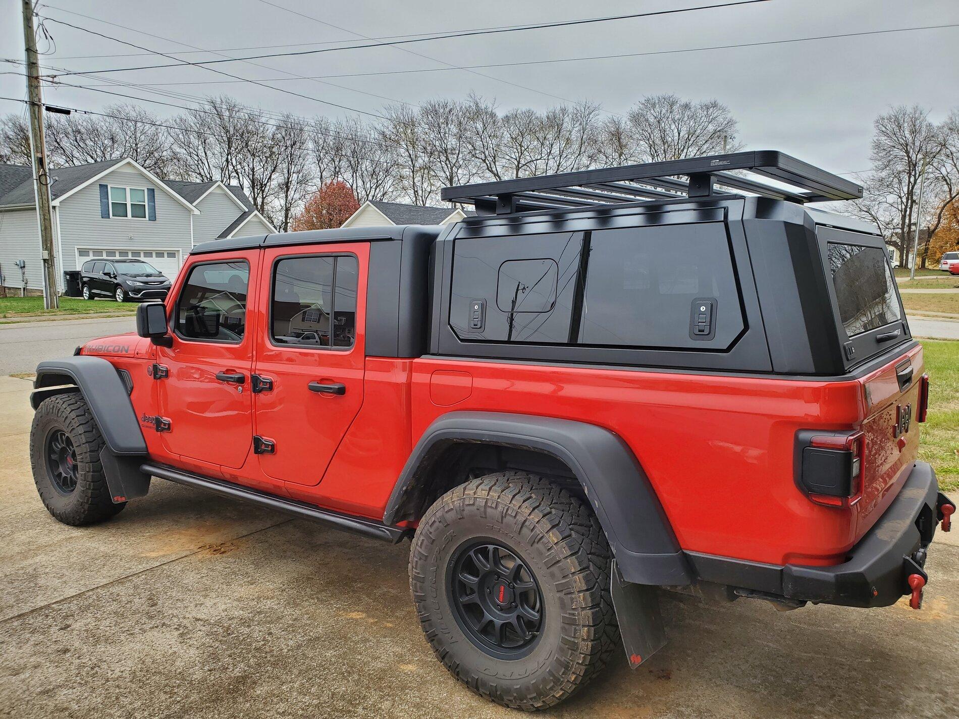

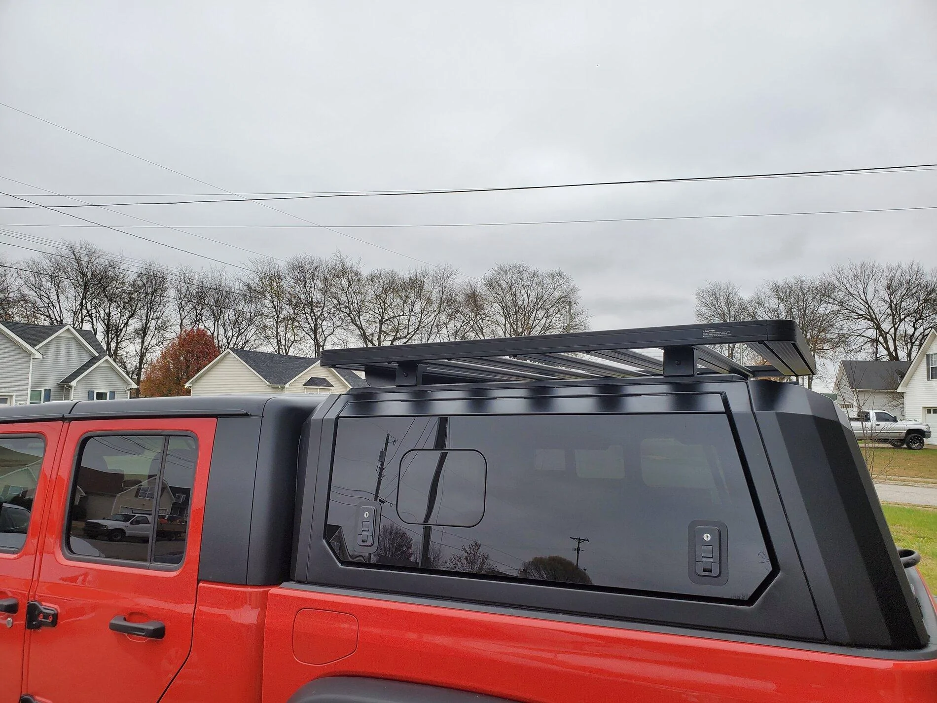

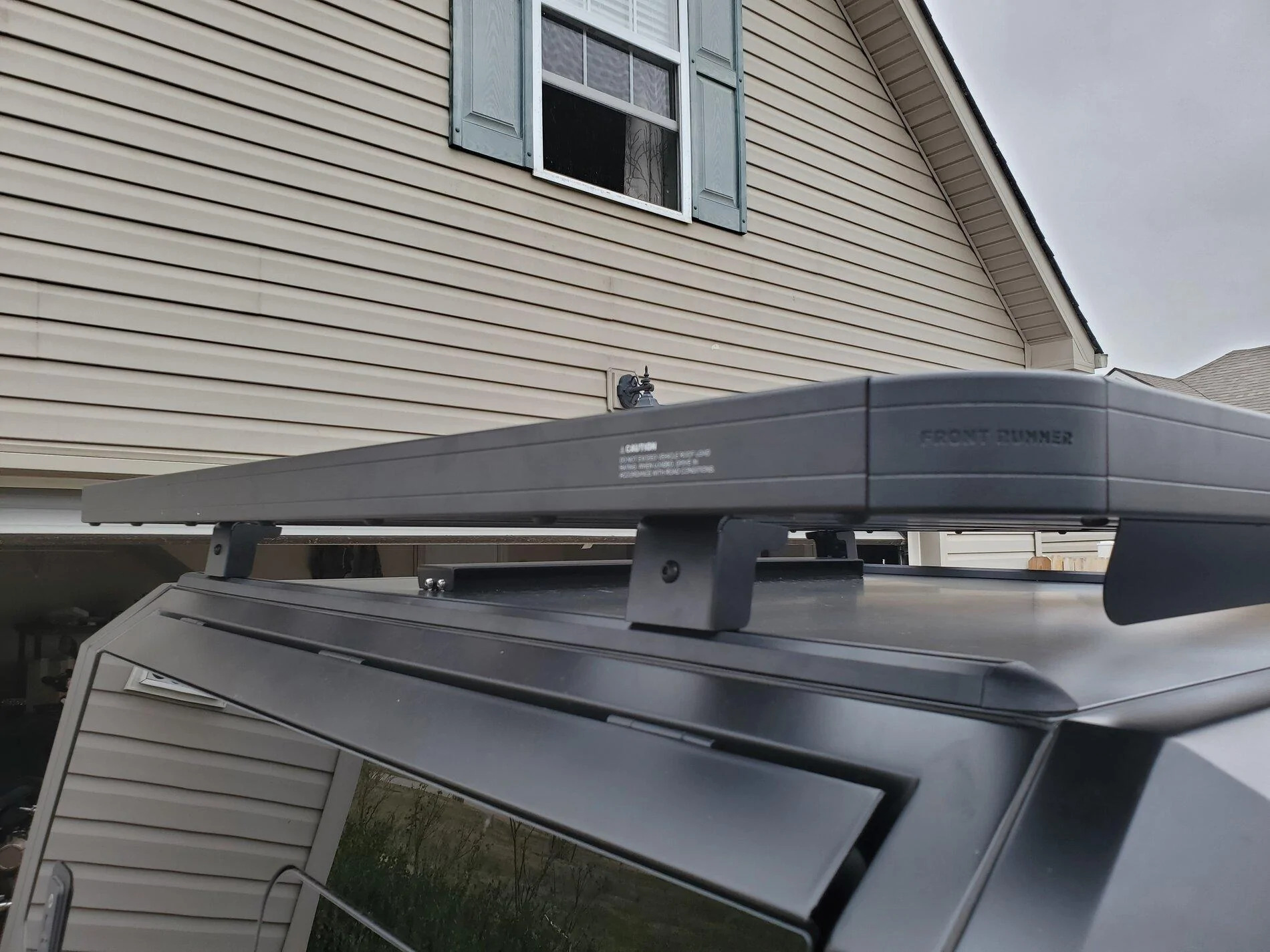

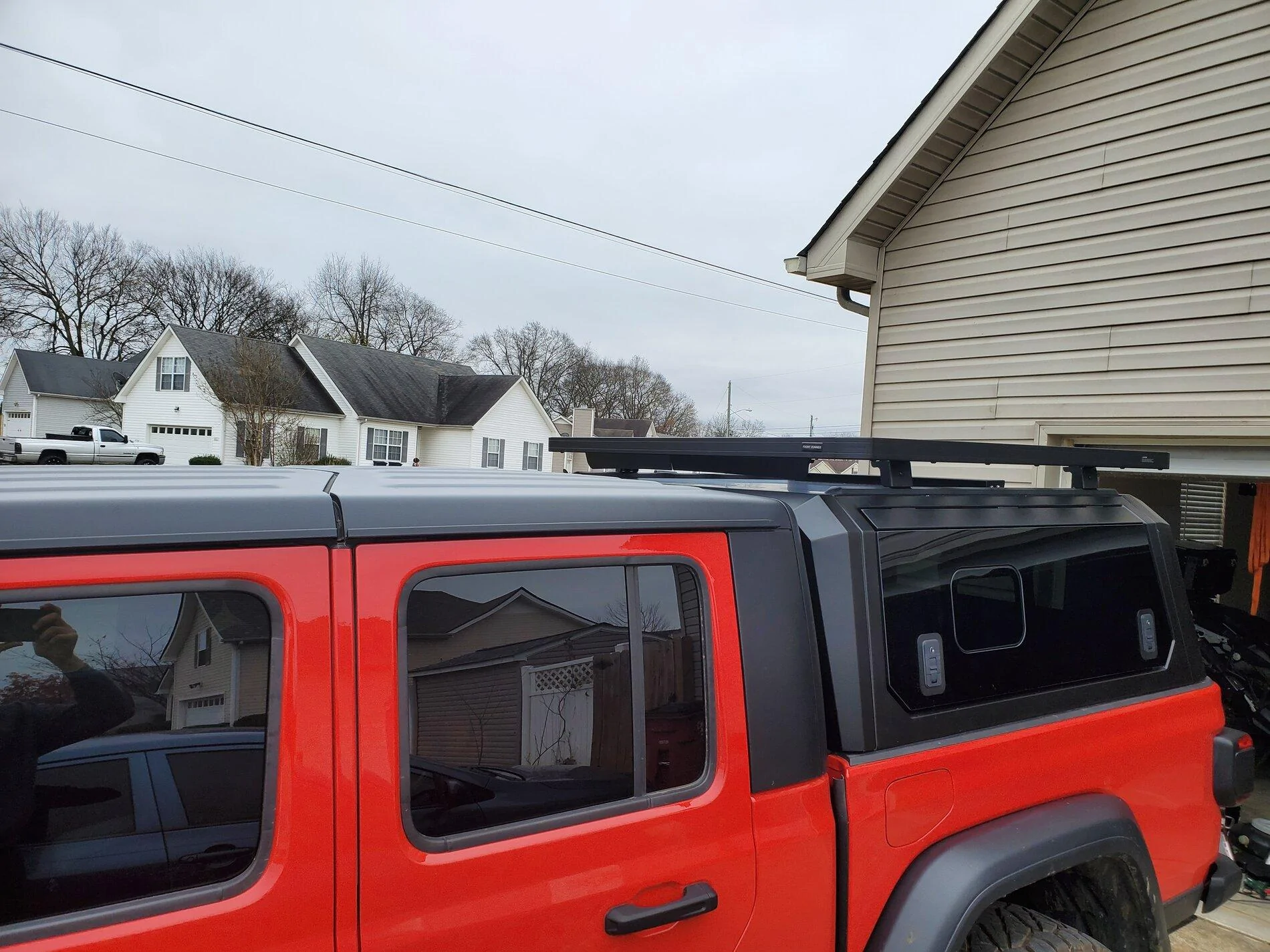

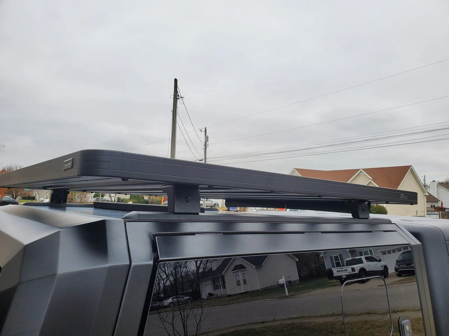

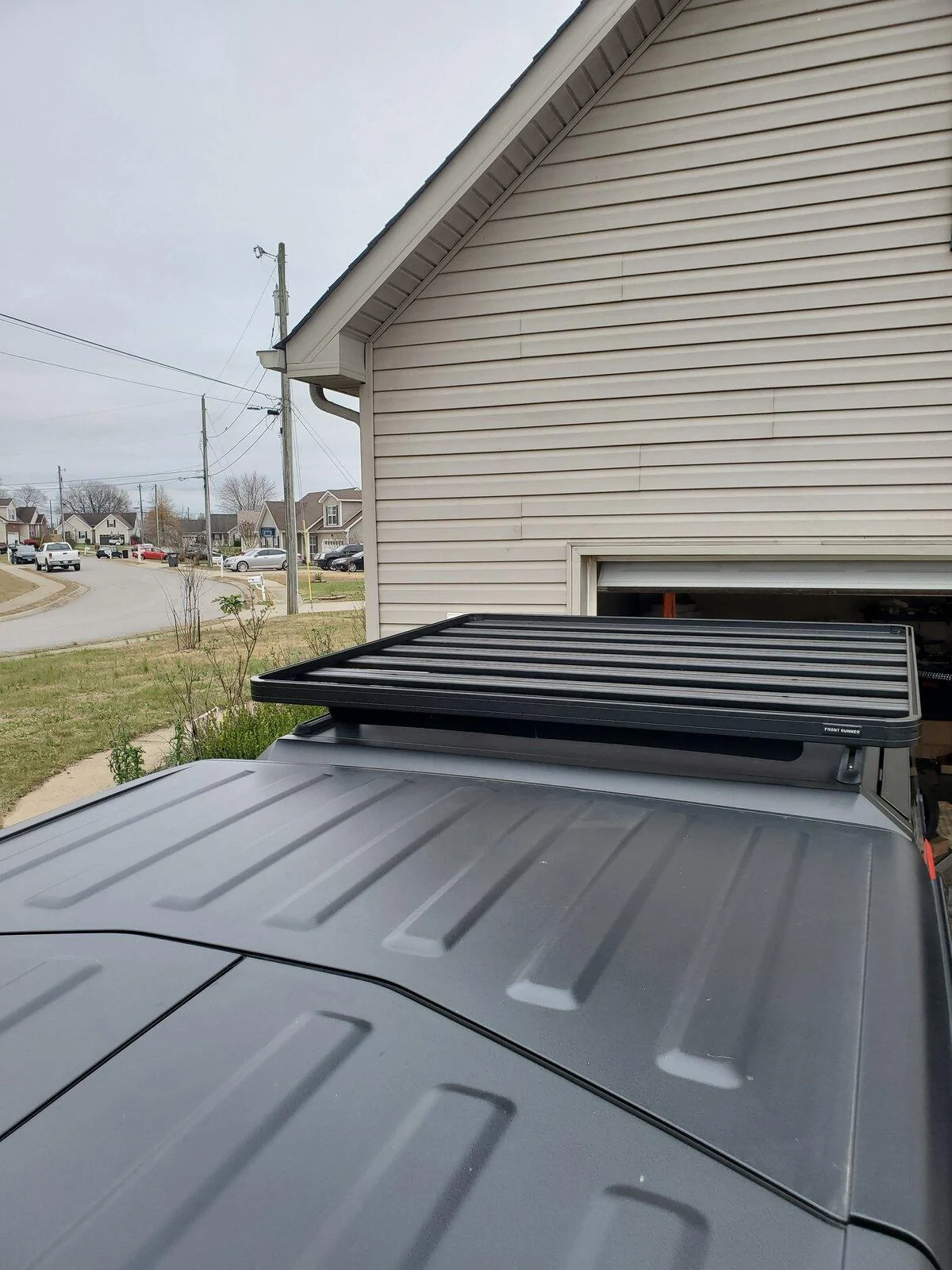

For any of you interested in following along on developments beyond the initial review/impressions:
Frontrunner rack is up and running on my SmartCap. Fitment is perfect.
Be advised that the RSI channels are narrower than other manufacturers. Frontrunner makes RSI specific brackets for the mounting feet that aren't available on their site, so be sure to call or chat with them if any of you plan on going a similar route. I also went with the tall foot kit, to provide clearance for the RSI vent and Frontrunner wind fairing.
Up next is mounting my RTT brackets and test fitting the ikamper. I have a plan in place for the roof rack lighting, but I likely won't execute that until the front roof rack is on as well.

Thanks for the photos. I have a cap on order and am shopping for a rack right now. Could you please share the dimensions of your Front Runner? Is it 53.5" x 53"?
TheHops
TheHops
Dec 23, 2019
567
830
Nashville
I went with their 1358mm long x 1425mm wide rack based on manufacturer recommendation when I provided them the RSI roof and track dimensions.
