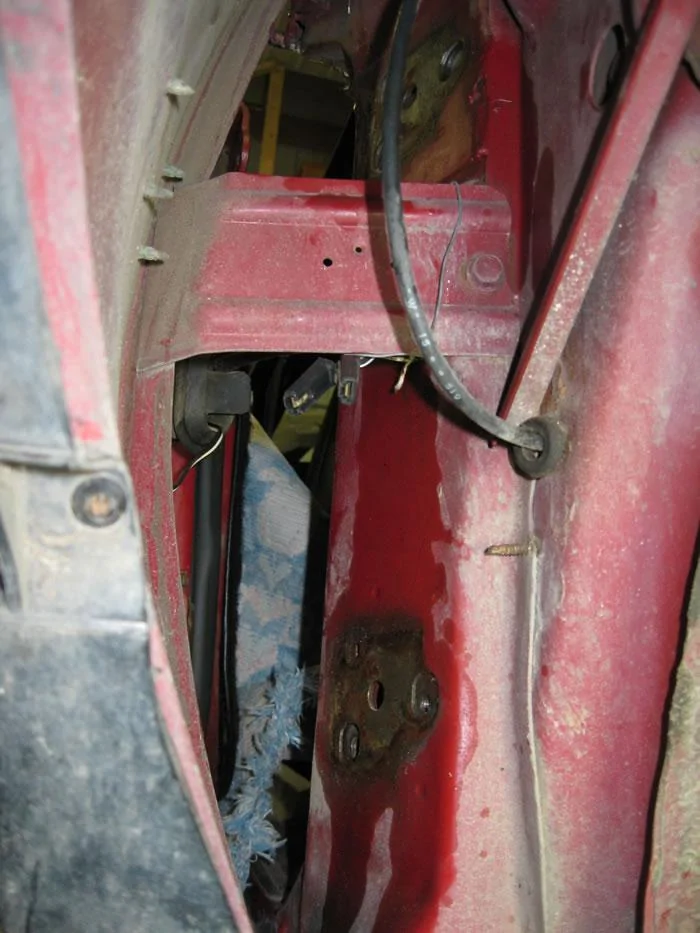

One the Eagle doors, you remove the fender liner (completely) and while using stands, jacks and in my case, the cradle on the engine hoist to hold the door in place, you look back behind the front wheel and - here's where the hinge bolts go - on the other hand, I wish Javelin door hinges were this bloody easy. You literally take out the whole instrument cluster and the dash as the bolts go from inside the car, out........

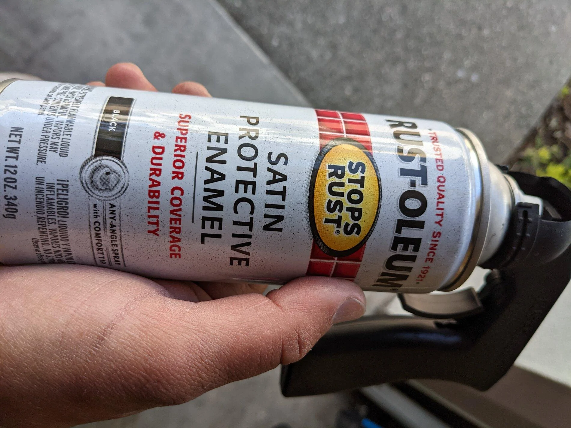

Ffffuuu. I had bought 2 trays of flat black at HD for these and other items upcoming. Come down today to check on the final visible paint and some jackal had gotten a satin can in there and I didn't check. Gotta wait 48 extra hours now before I can get a layer or 2 of flat on it.
It doesn't look bad just not what I wanted
