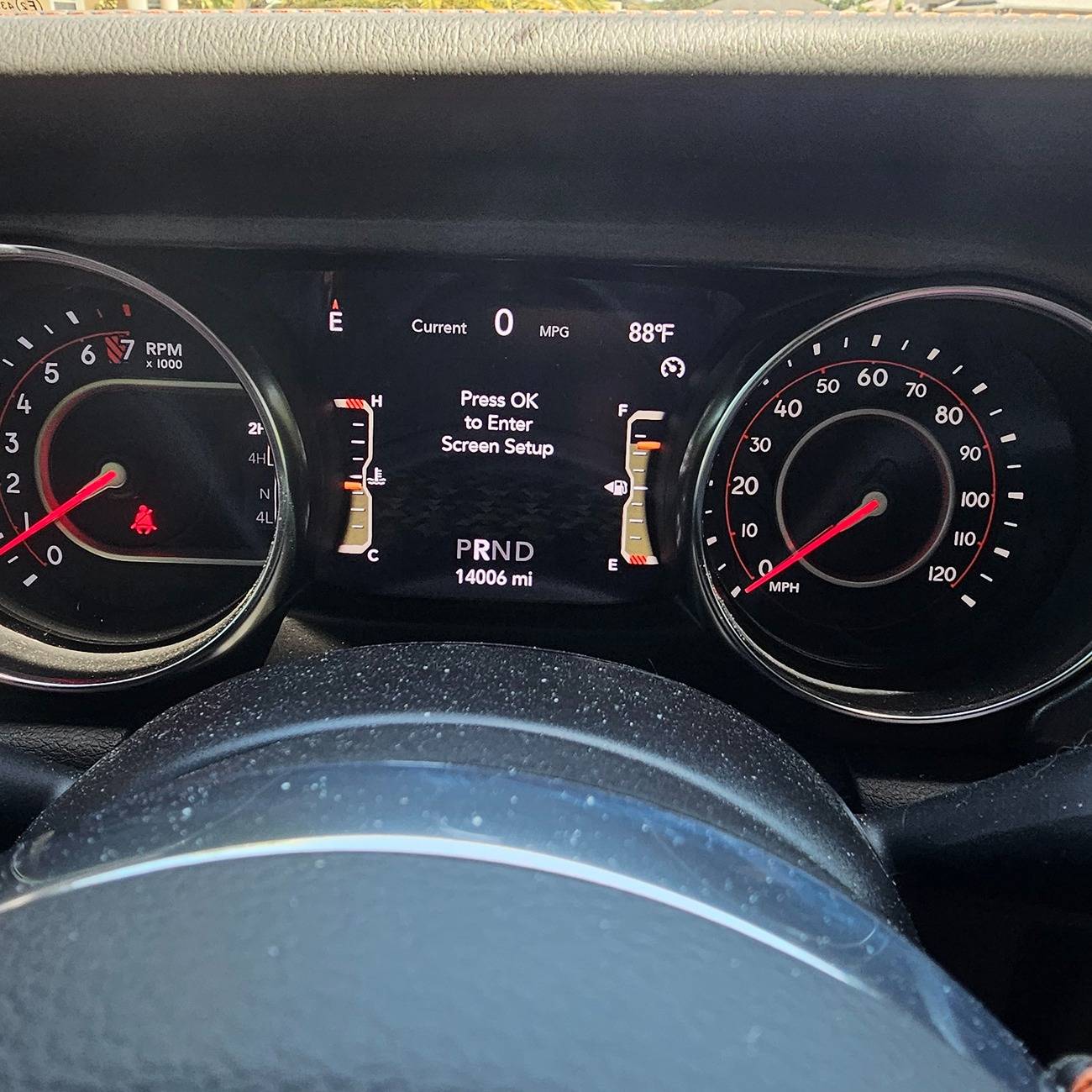

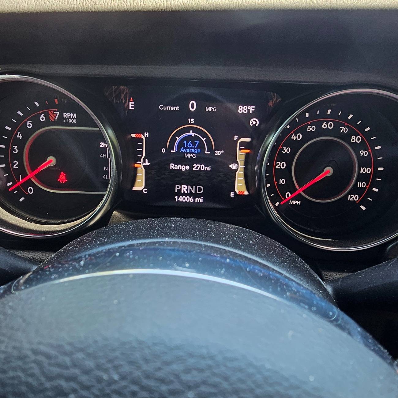

Heres a work around, as mine has disappeared again and like many posters, I really like the instant average feature on my gladiator.
Enter the cluster "Setup" screen:

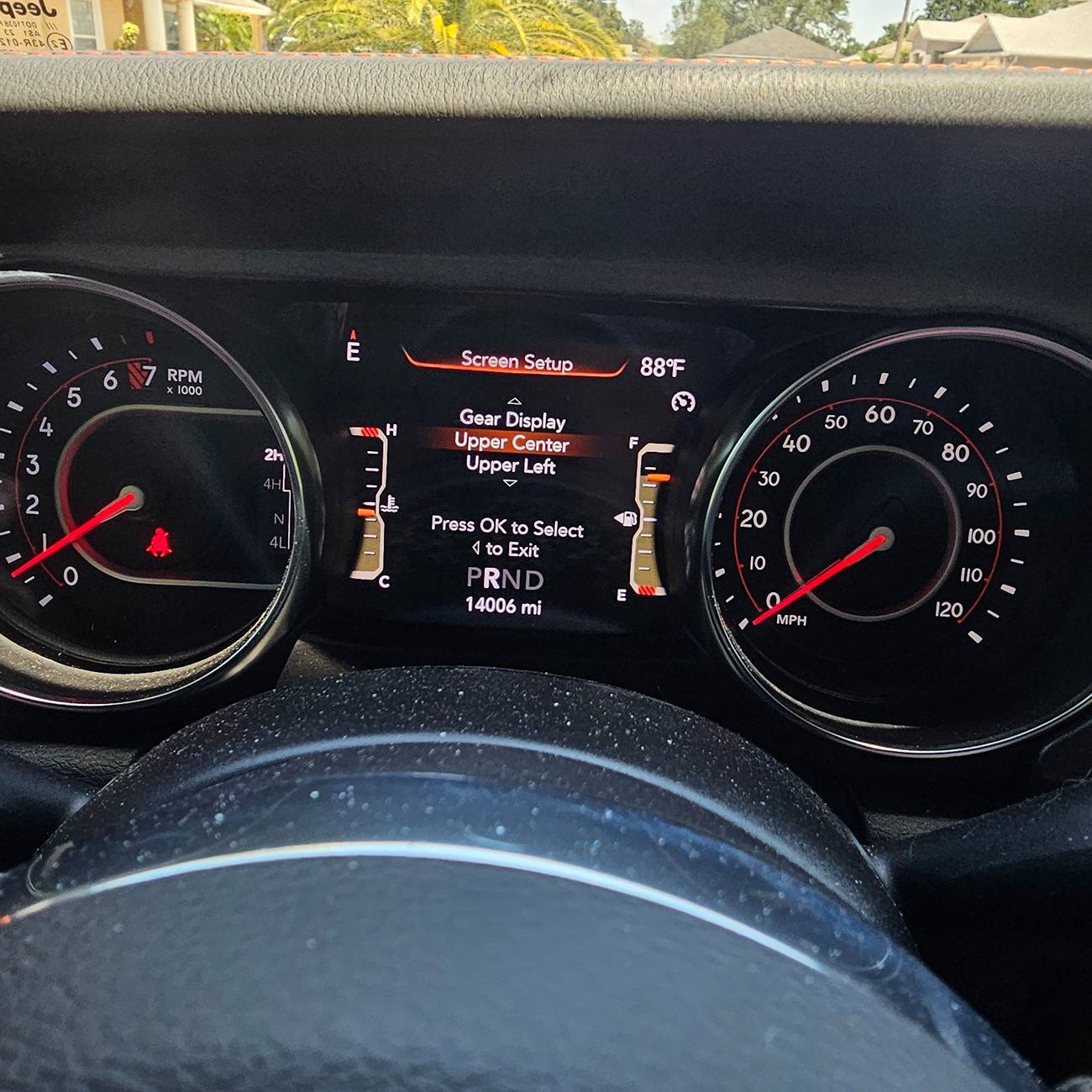

Scroll down and select "Upper Center":

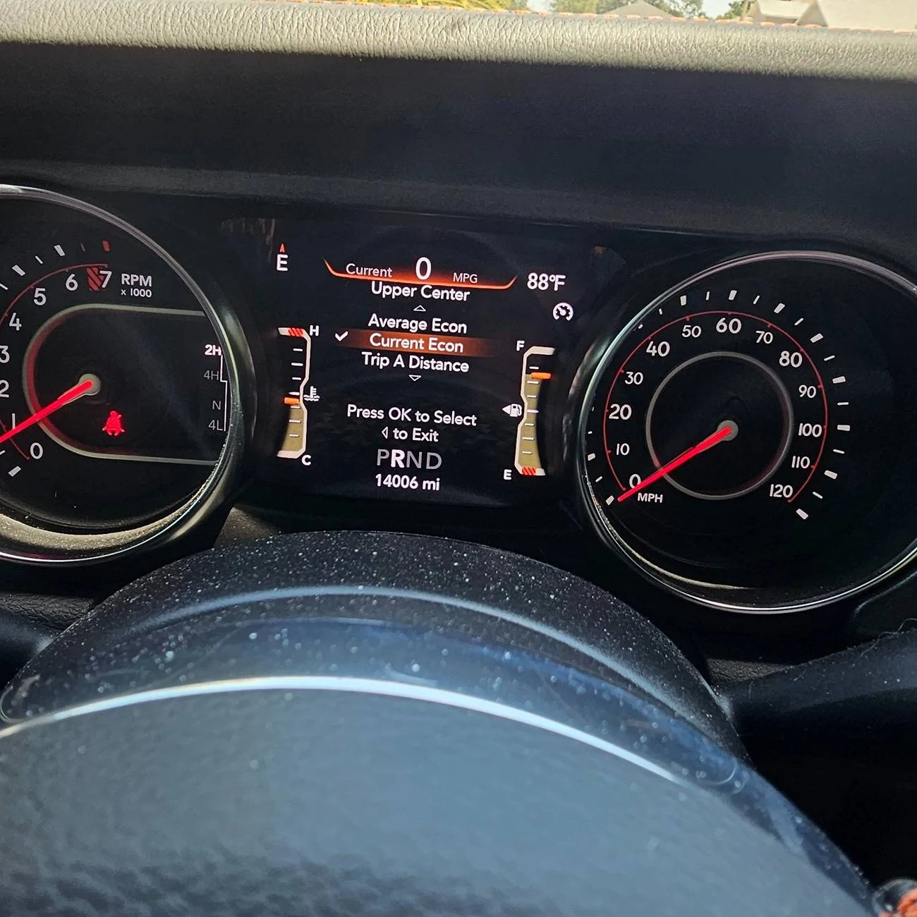

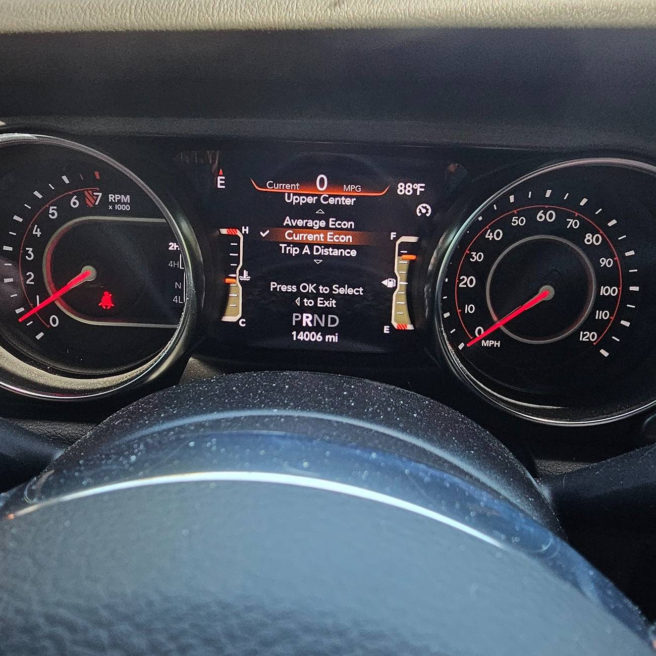

Scroll down and select "Current Econ":
Follow the on screen prompts to exit cluster setup. Then return to Fuel Economy or any other screen. When done, after the screen selection goes away, the Current Economy is displayed at the top center.
