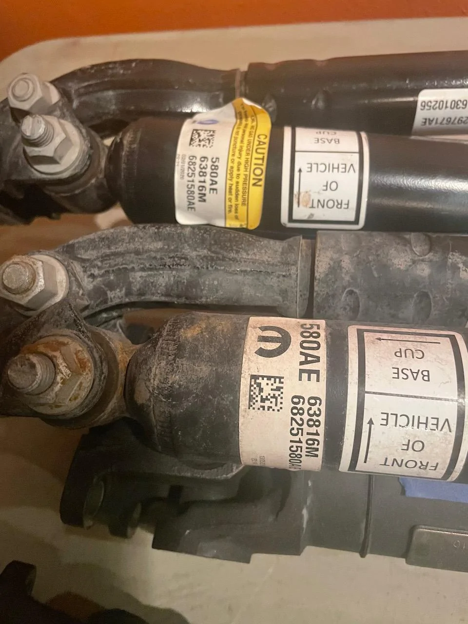

FWIW, replacing the steering stabilizer is unlikely going to fix death wobble. It is as other's have noted only a bandaid. If you're really convinced you need a new one... well, I've got two OEM steering stabilizers that are like new. Would be happy to sell/ship you one. They came off a 2020 Gladiator Mojave and a 2019 Wrangler Unlimited Sport S. However, I think you'll be disappointed.
This is strictly curiosity and has nothing to do with death wobble and stabilizers masking or fixing or for that matter, being involved in the plastic bags in the highway medians around here -
Does the Mojave use the same part number stabilizer or is it different enough in height or some other configuration that they use a different part number compared to any other level of JT?
Just wondering and no other reason.
They're the same part. The JTM and JLU Sport S have the same steering stabilizer.
