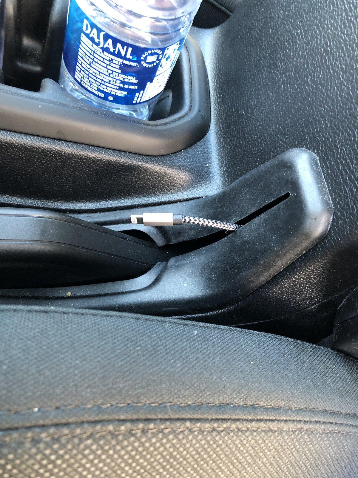

In regards to routing the USB wire.... I suppose you are running a phone connection for charging and for Apple Interface with the radio. I ran a 3/8ā€ drill bit into the console from just above the parking brake handle (between the rubber trim pieces) and fed my lightning wire out through there. Slick and easy. I just did it because I didnā€™t like the way it looked having the wire snaking out over the top of the console. This looks much neater to me.
