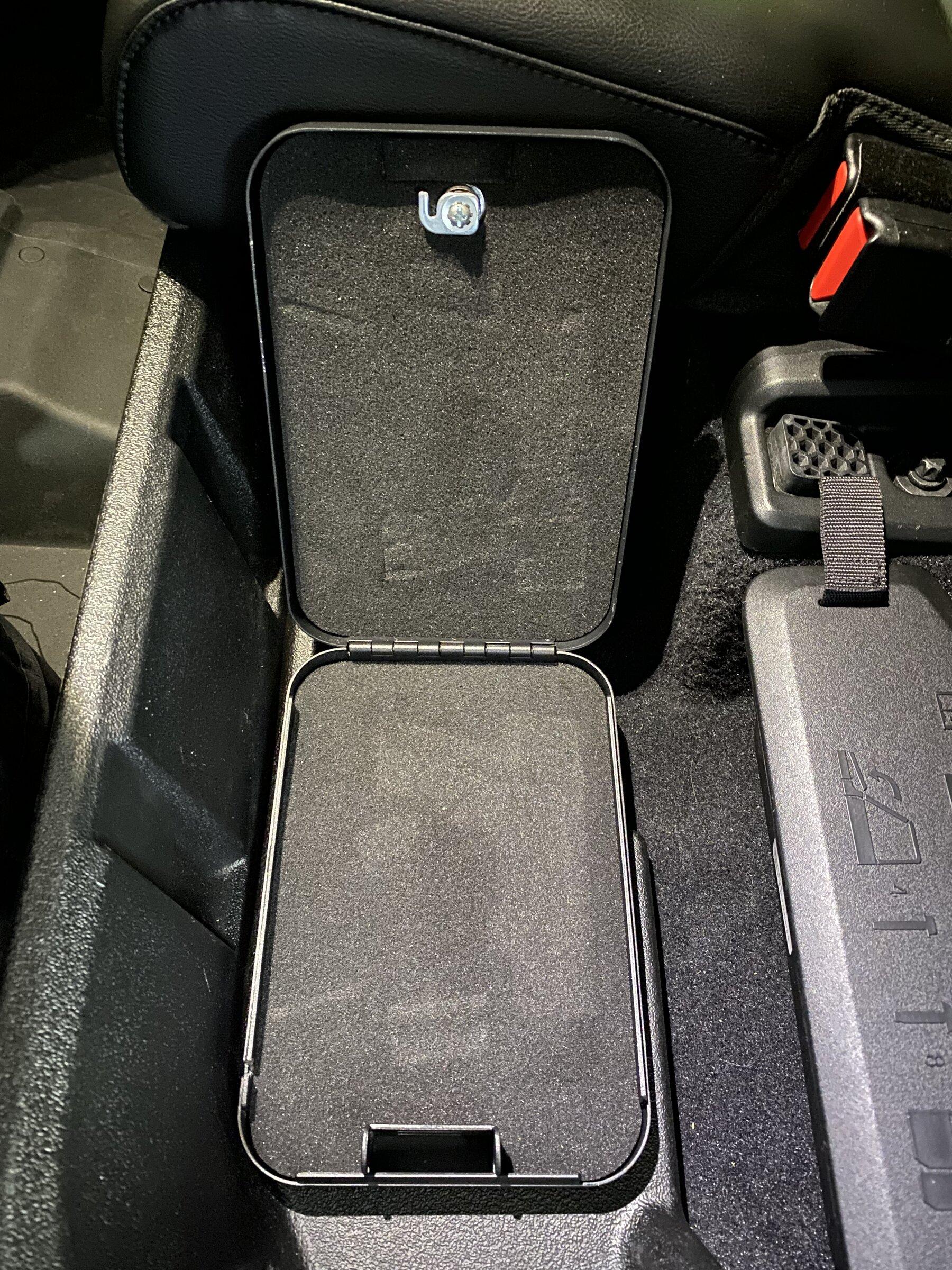

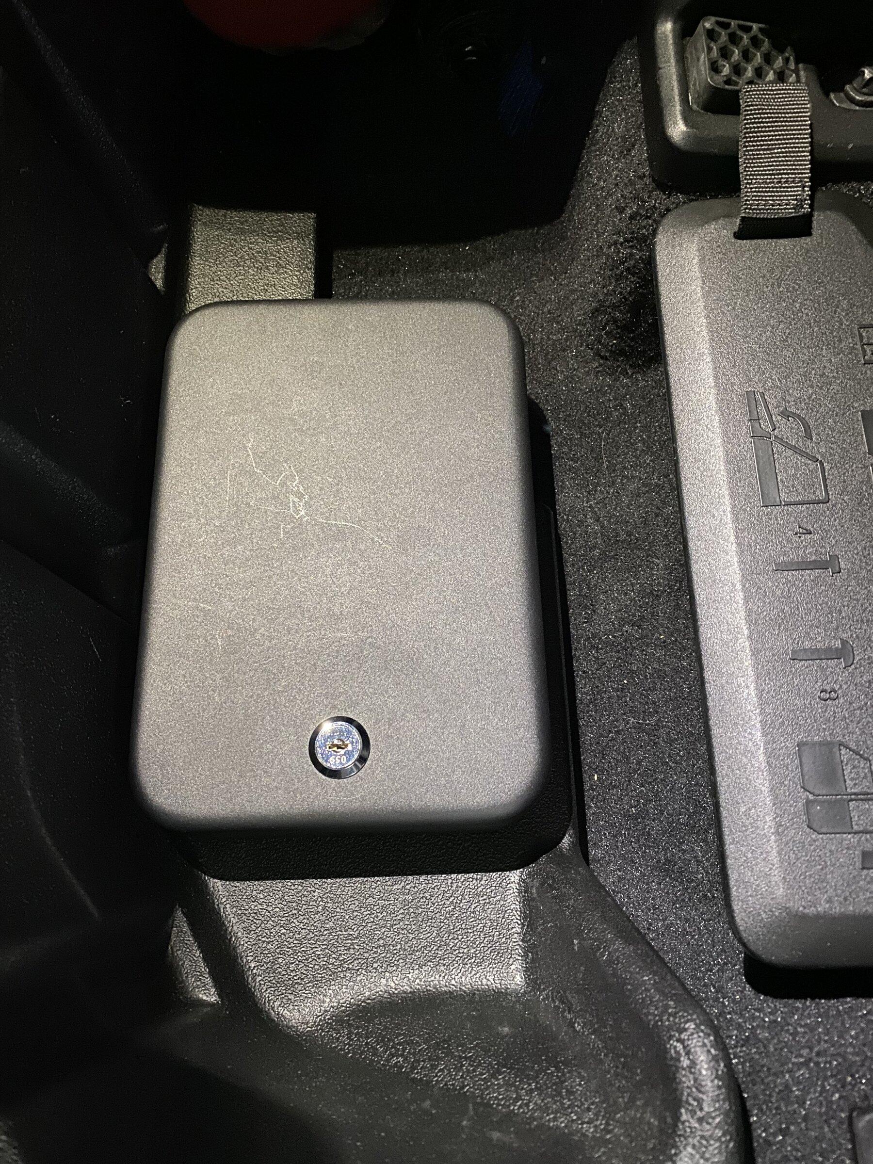

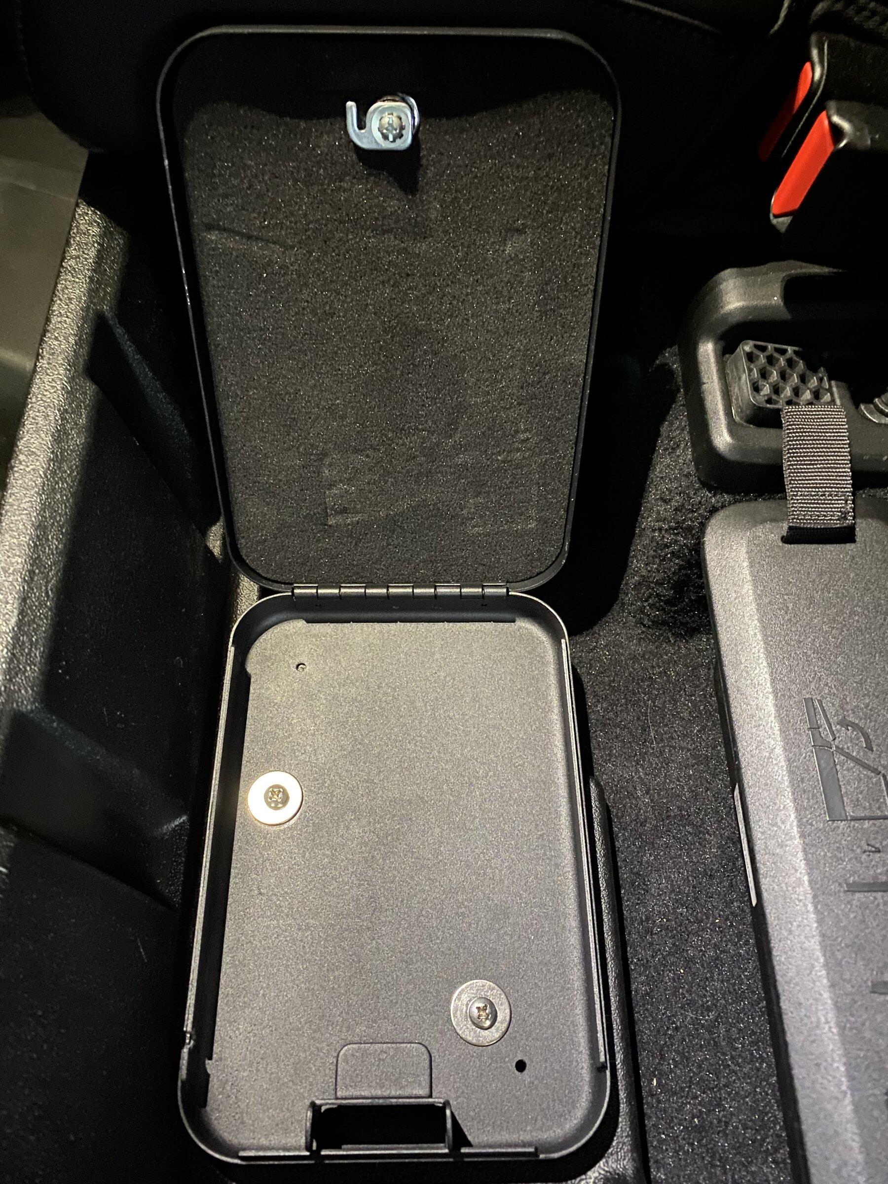

Thanks everyone for your feedback. I came up with a solution until something better comes up. I had a pistol lockbox lying around so I mounted it under the rear seat on the driver’s side using the bolts holding down plastic OEM storage box, so no modifications to the Jeep at all, and if I need to lock up my pistol I will be able too.

Great idea! I have a similar box that’s normally used with a cable lock. from what I understand, the Tuffy rear lock Box actually mounts the same way. How was laying out the holes to drill in the box? Did you make a cardboard template Or just measured and winged it?

I removed the plastic storage box from the Jeep flipped it over and held the lock box where I wanted it mounted and marked the holes on the gun case and drilled them. I then went to Home Depot and bought two longer M6 screws, 2 flat washers and two thick plastic bushings. I put the bushings in the indent between the OEM storage box and the bottom of the gun box so it was more solid when I mounted the box and used blue lock tight.

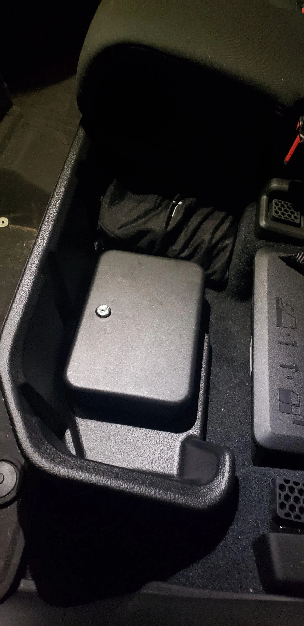

You can fit a single box like above under there. That's my current setup. A mobile box with cable lock. I took a strong magnet and zip-tied it to the rear part of the seat frame. When I slide the box back, the magnet grabs it. So far, under heavy braking, the box has never moved.
I finally got the chance to do mine đź‘Ť

Looks good. I preffered it bolted down -vs- a cable lock which was an option with my box. I see yours is also bolted down.
