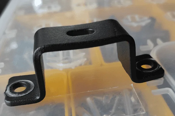

2) Assembled with only one issue - the lock bracket.
Jeep Gladiator Rear under seat storage box brkt
The mount holes did not align with basket mount holes. After hammering and Dremeling it was installed. Later, when the seats were lowered I noticed the pin did not engage the hole, so more dremeling to make that work. To be honest, a lot more adjusticizing than I expected (or desired). PRO TIP: as installing the lock and bracket is basically step #1, thoroughly check it at that time for proper operation and engagement. It's much easier to do it then rather than after the basket is installed.

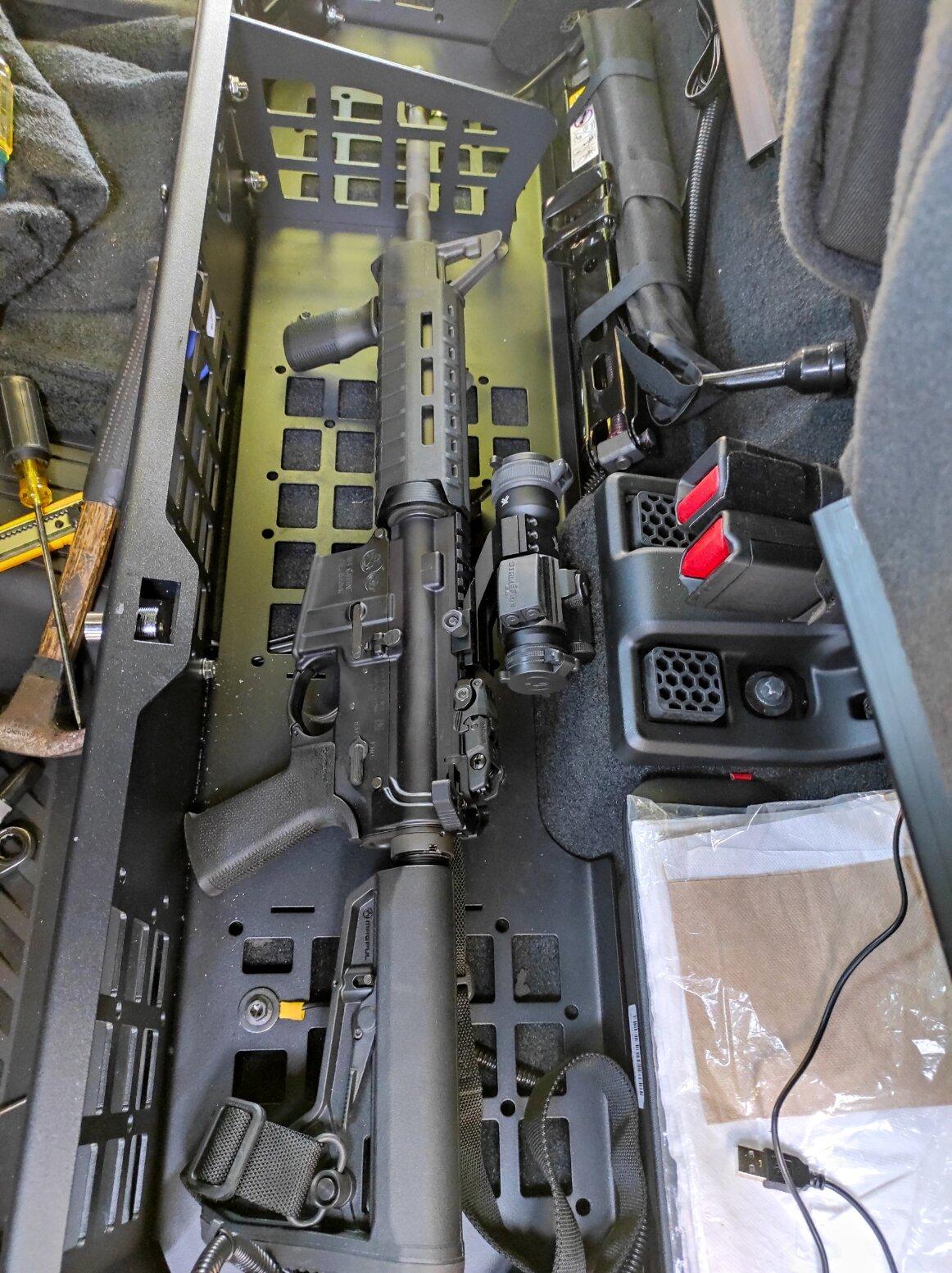

3) Installed the divider which makes a nice barrel holder ?

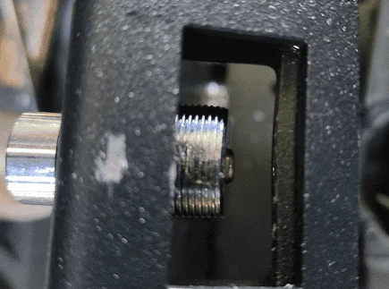

4) In my opinion, although the basket is fairly robust, the weak link is the locking assembly, the small pin, which barely engages the bracket probably won't stand up to much of a pry attack between the seat and basket. In fact, depending on how much you may/may not need to deform the bracket in order to install it, the pin might not engage with the bracket at all. It should extend fully through the bracket for maximum security.
Jeep Gladiator Rear under seat storage box lock
I'll be looking for something a little more robust for the locking assembly and will post and update when I do.

I'm waiting to see if ROAM or Pelican will come out with a solution. As for AR, get a Gen3 folder for it so the buffer tube can fold over.
