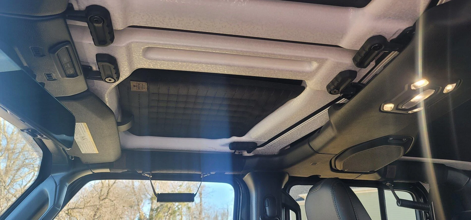

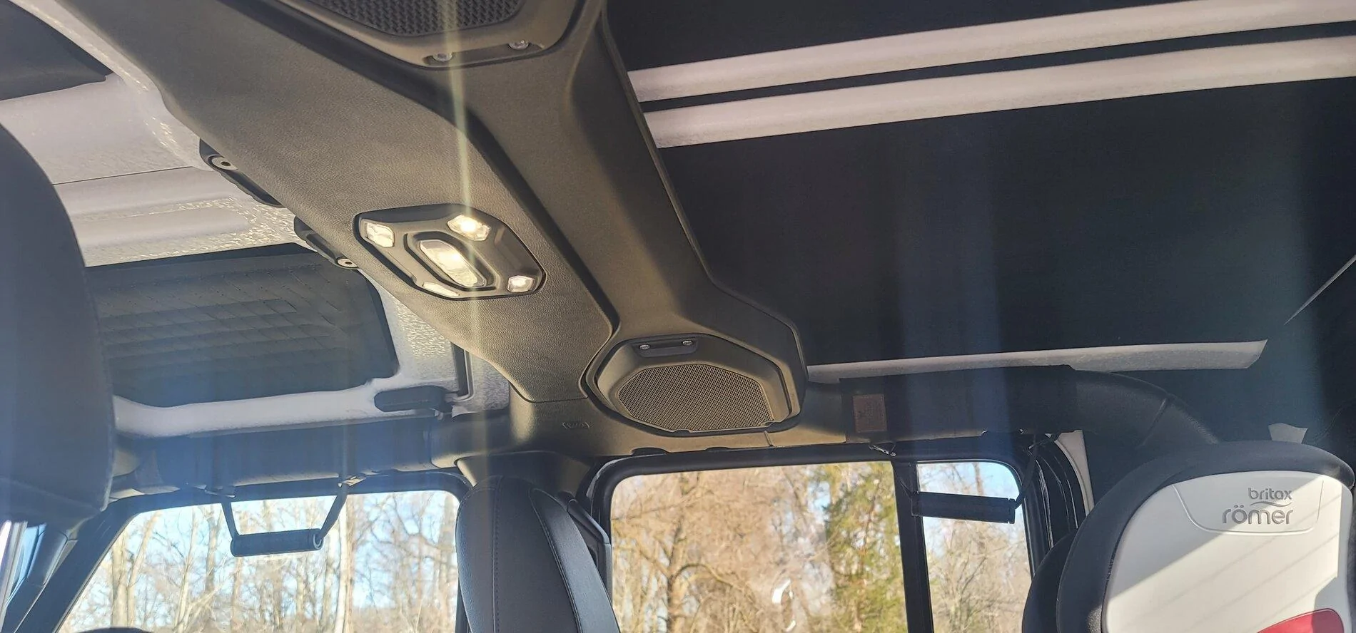

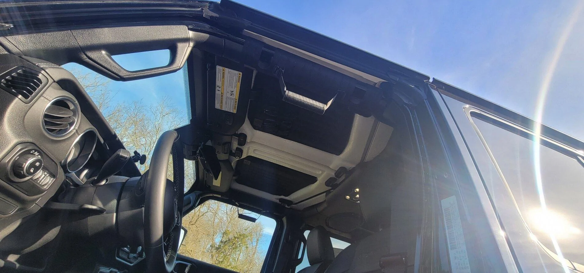

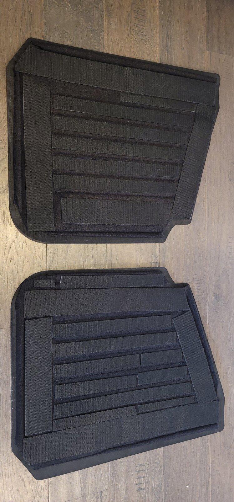

Reporting back. I am really happy with this.
First, I doubled up the velcro strips. Sticky side to sticky side, which left velcro on both sides. I then applied the velcro over the entire Invictus headliners. I probably went a bit overkill, but figured more is always better right?
Jeep Gladiator Invictus and Hothead headliners 20210309_174637
I then velcro'd these to the Hothead headliners. It is clear that the velcro doesn't "stick" quite as strongly to the Hothead fabric, but it works well enough for what I want. If you try to remove the Invictus headliner from the edge, you can peel it off pretty easily, but if you pull straight down in the middle, it has decently strong hold.
This wouldn't work for all use cases, but I think the look is great, and it gives some extra storage.

Each product on their own is fantastic: @Invictus Off Road and @Hothead Headliners. I would strongly recommend either one of them, and they do work together, if you are good with the limitations.
