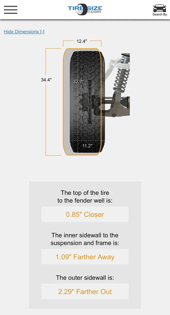

Factory wheel is roughly 5.75 backspace and 9 wide -6 is 4.75.
This is a comparison of OEM 285x70 vs 315x70 with the OEM wheel vs the wheel you are asking about. Some people want that stance so here’s what it looks like
Jeep Gladiator is a 17x9 -6mm wheel good fit on Gladiator Mojave ? IMG_2568
