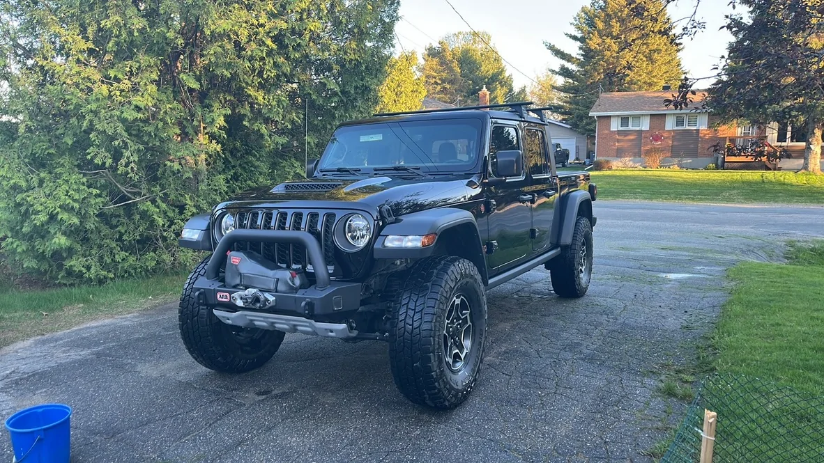

I ran 37x12.5 on the stock wheels. 1.5 inch front spacer with matching shock extension and a 1 inch bump stop extension, in the rear it was a 3/4 inch spacer and 1/2 inch bump stop extension.

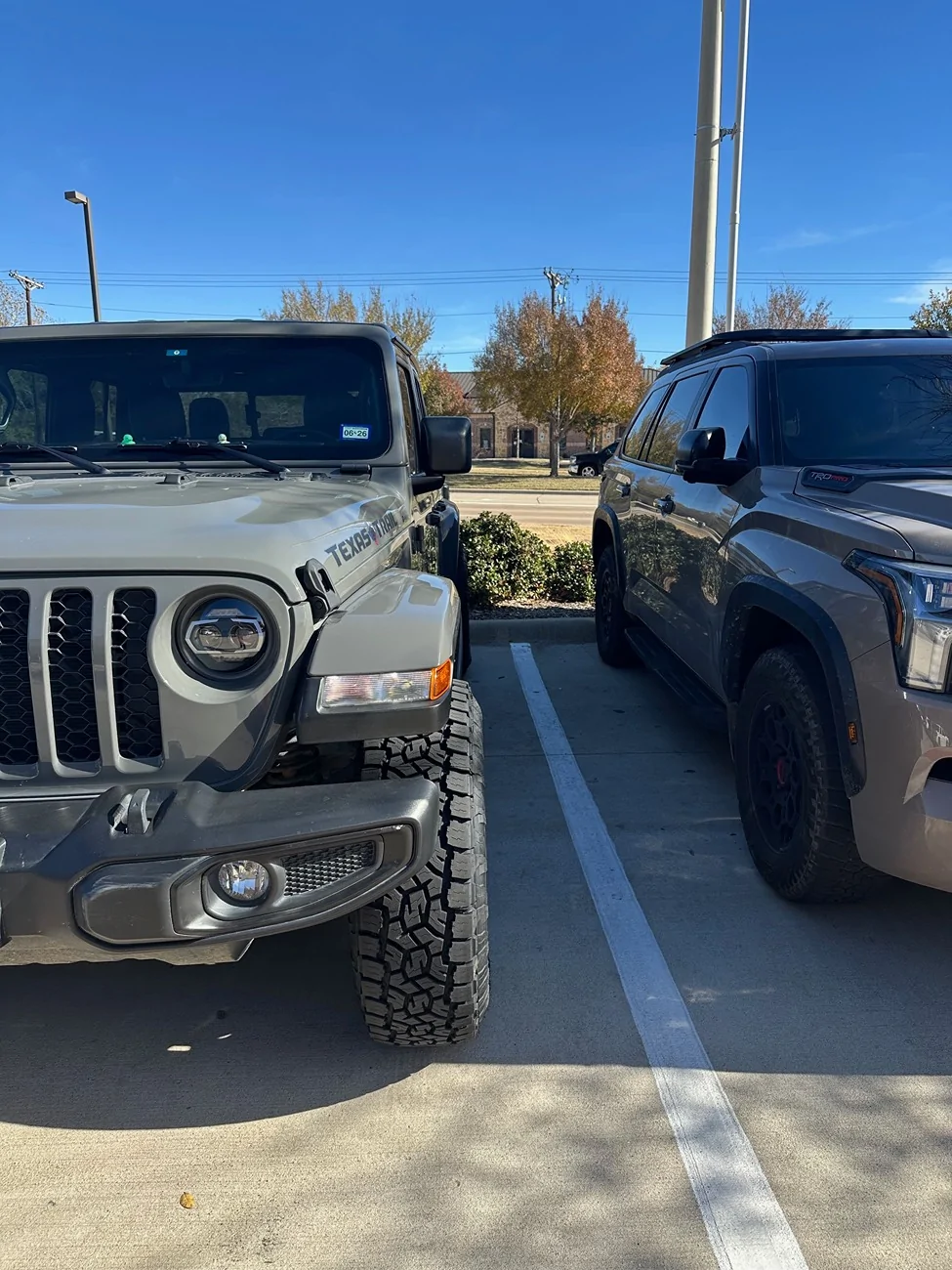

I’m running 35x11,5 on my JTM on factory rims with no rubbing when disconnected. It’s not even a concern for a factory Mojave. You may want a tazer mini to adjust your speedo. You can find websites that’ll show you the scrub radius before and after, and you can play with offset and spacing changes to your hearts desire.

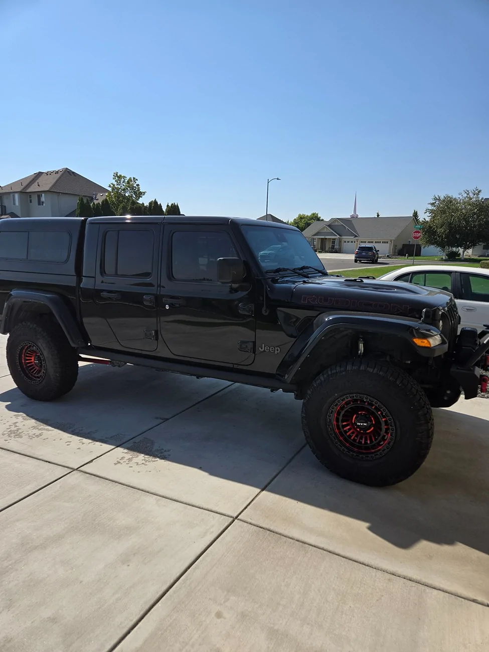

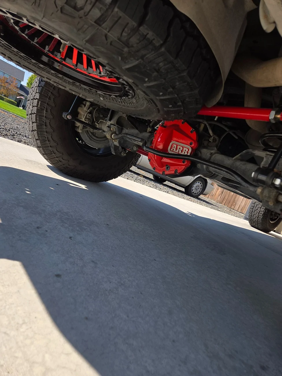

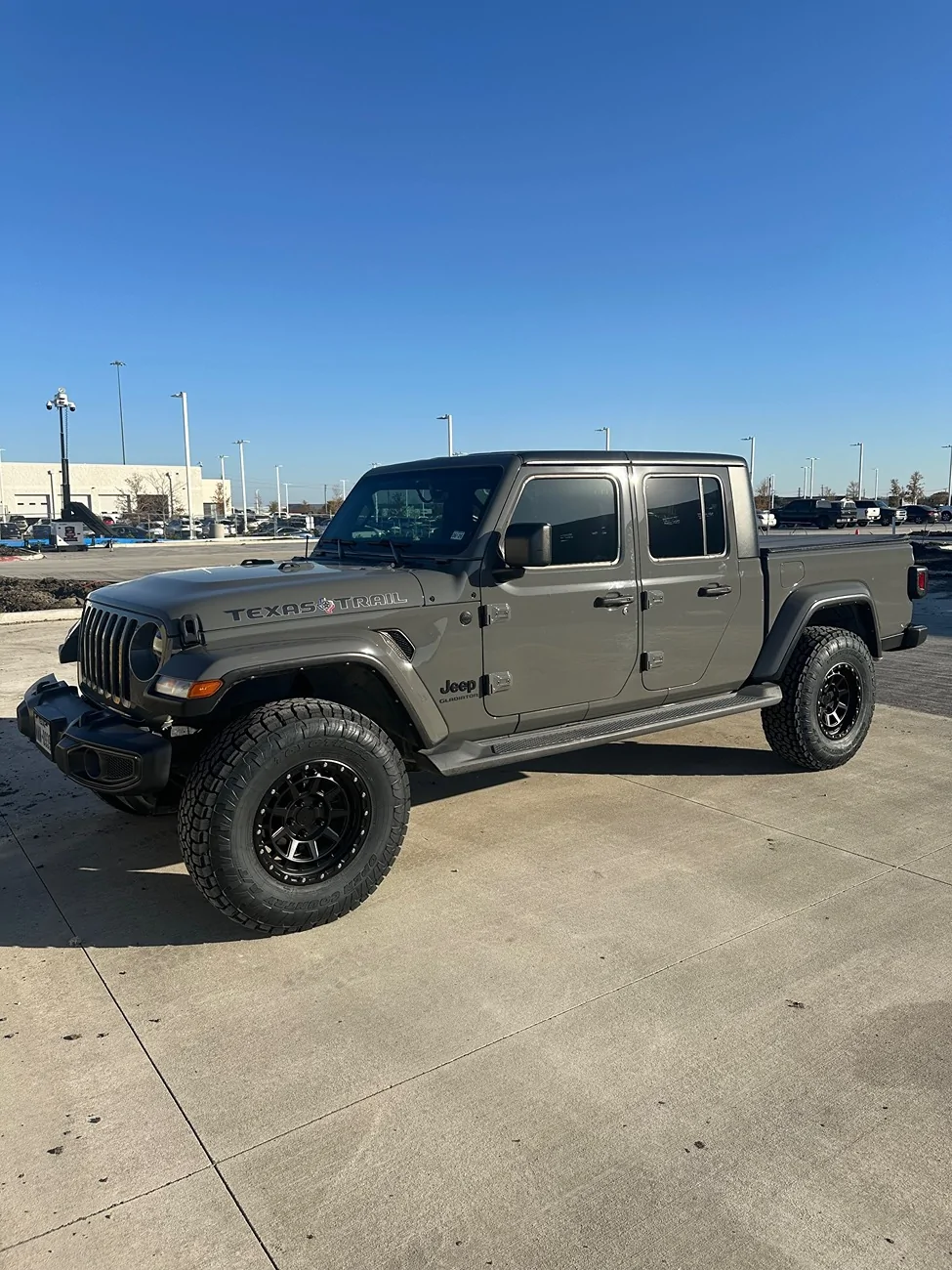

35x11.5r17 -12 offset on fabtech 3in lift with core 4x4 heavy duty control arms, drag link, and tie rod. Spare fits with room to spare.
I appreciate the pics and info!

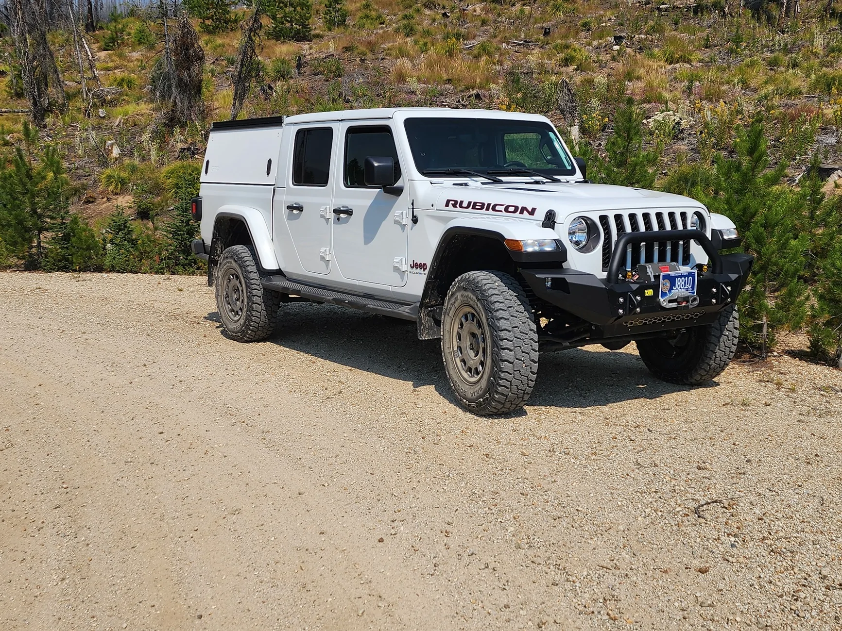

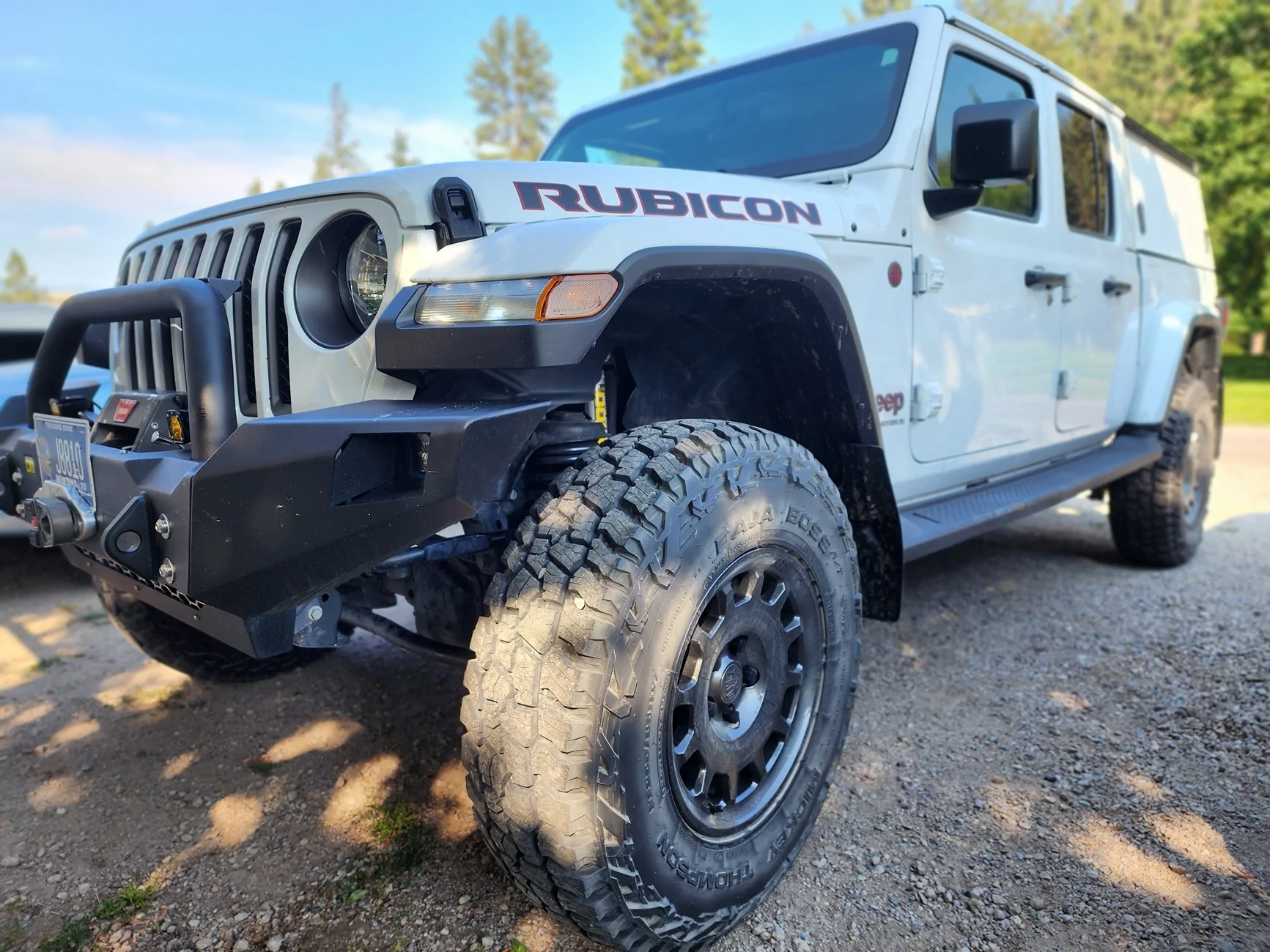

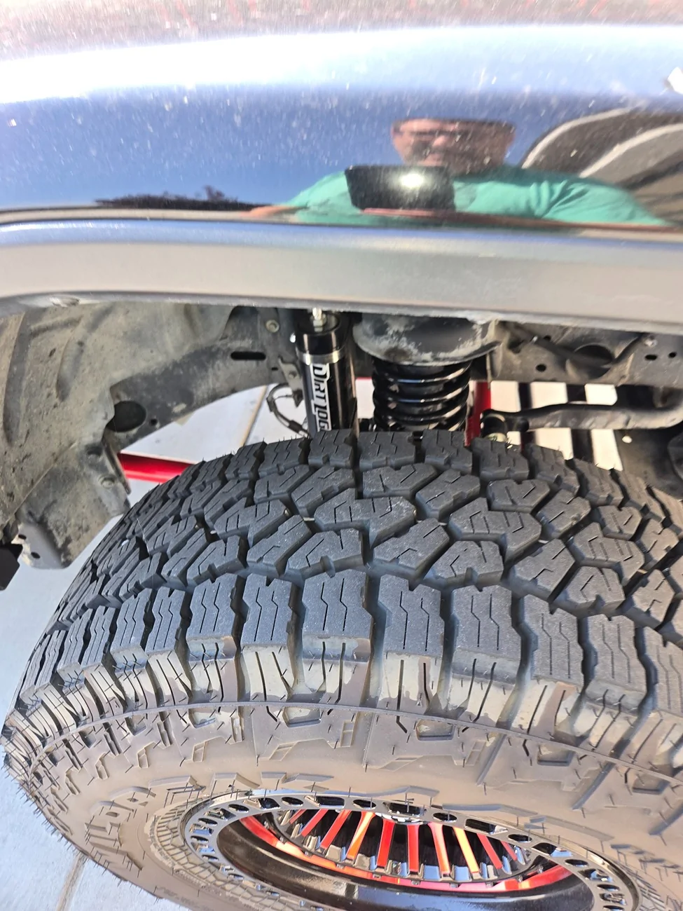

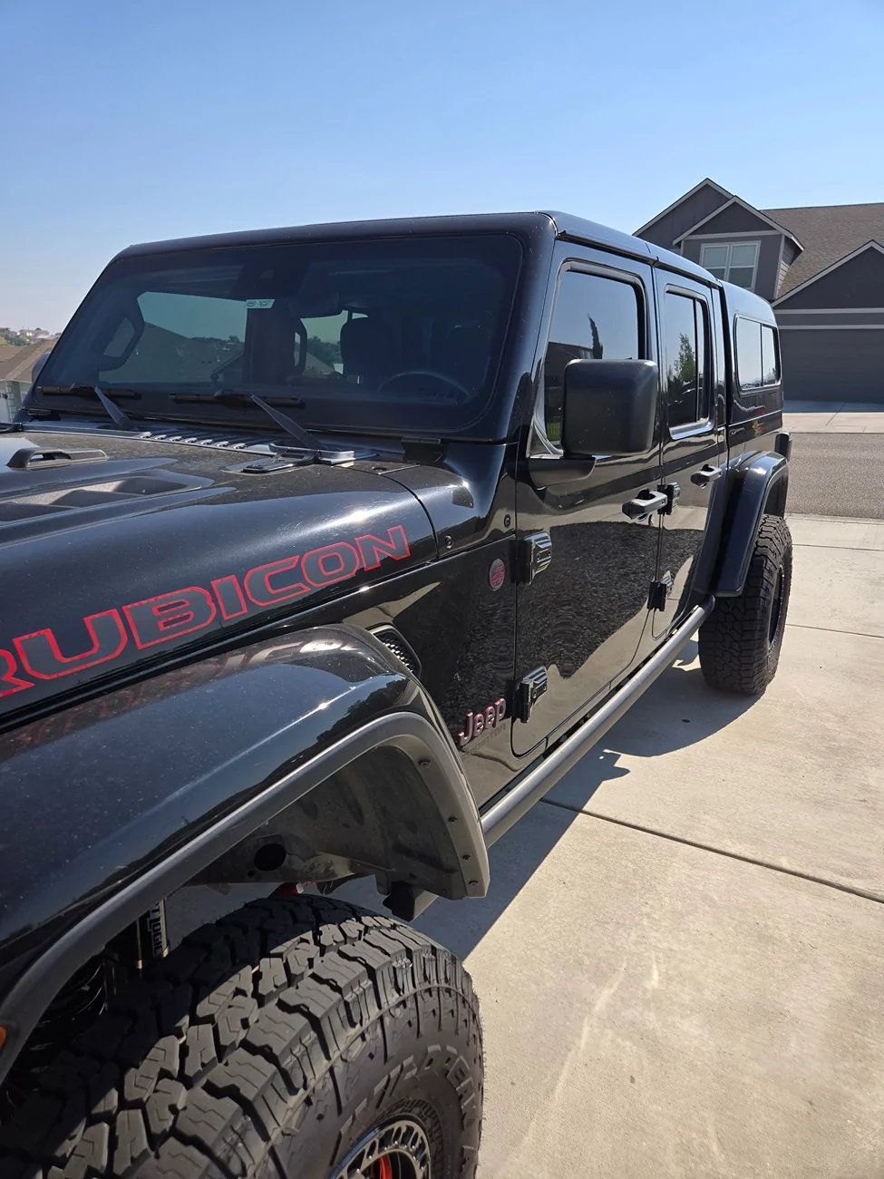

I'm running 255/85R17 MT Baja Boss A/T (skinnier) on 9" AEV Salta wheels. I would have preferred 8" or 8.5". The tire tread is right at the fender flare, the side wall tread hangs out about 1/2". I can get better pics of you'd like.
What is the offset on that wheel? Thanks for the pictures nice truck. I like the mickys

Man! I'm sorry. The internet is saying that mine are 8.5" wide, I thought for sure that they were 9".
They are +25mm offset.

The conversions of these offsets are like a half inch, so it’s going to be really difficult to see that from these pics taken at a 30° angle and 10’ away.
are you wanting pics that are on plane with the front/rear sidewalls?
