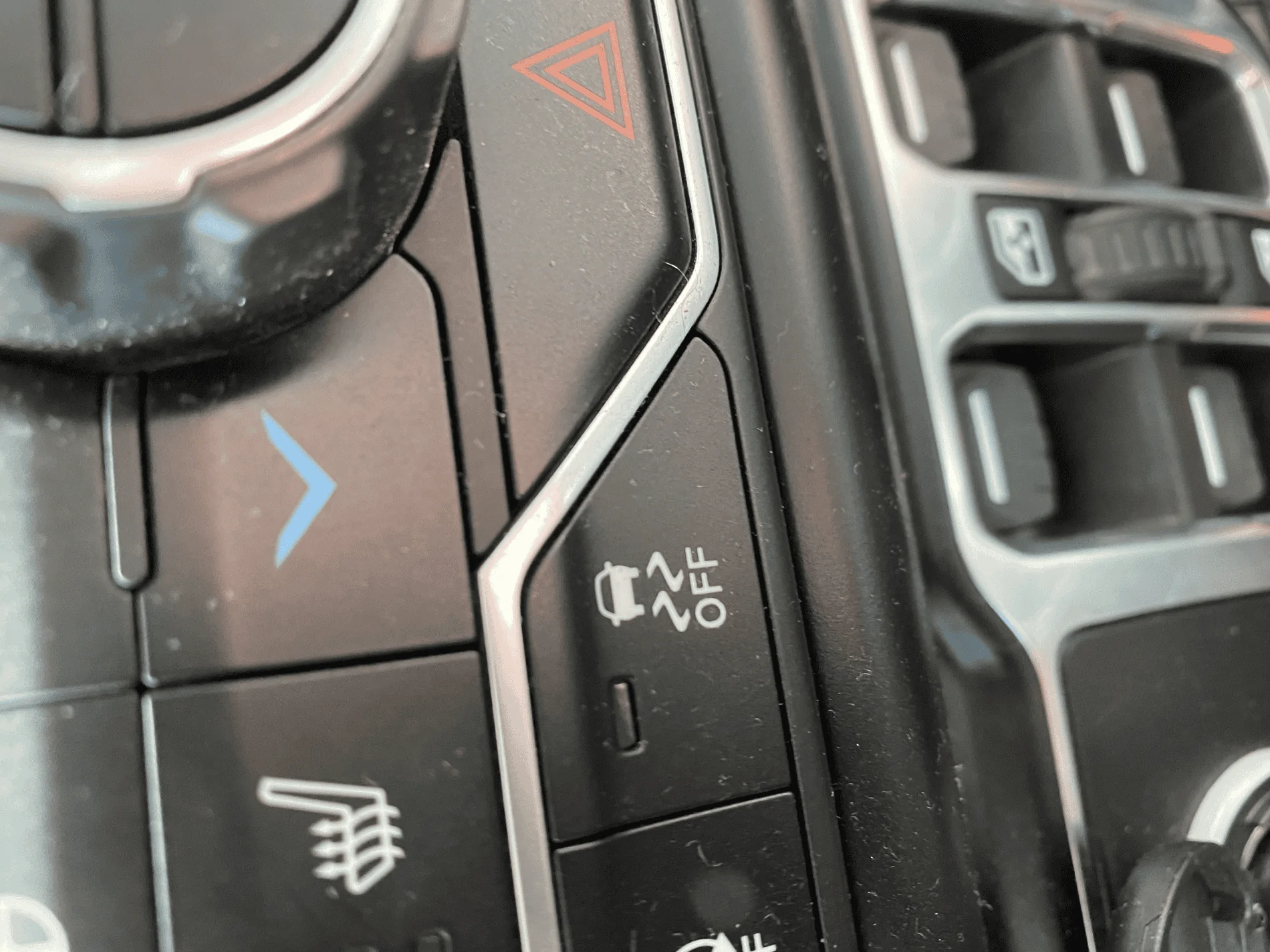

I just held traction control button for ~6sec in 2H and 4H and got the same thing twice: traction control off with traction control light on, ESC light on, ABS light on, parking brake light on, "service ABS" warning, "service stability control" warning. Lights wouldn’t turn off unless I turned the truck off and wasn't able to turn traction control back on unless I turned the truck off also..
You shouldn’t be getting any service warnings when you hold the button down. I’d scan for codes if you have the ability, and take it to the dealer if you don’t. Something isn’t right there.
Do you have the tazer? That sounds like you activated the "TC kill" option.
More reading, https://www.jeepgladiatorforum.com/forum/threads/question-about-traction-control.25038/
That is a function of the Tazer Mini and it stated you had to shut the engine off and back on to reset as it disabled the entire ABS system.
From the Tazer guide:
"Full traction control disable: Press and hold the traction button for 5 seconds to fully disable TC and ABS. Shut off and re-start Jeep to re-enable."
