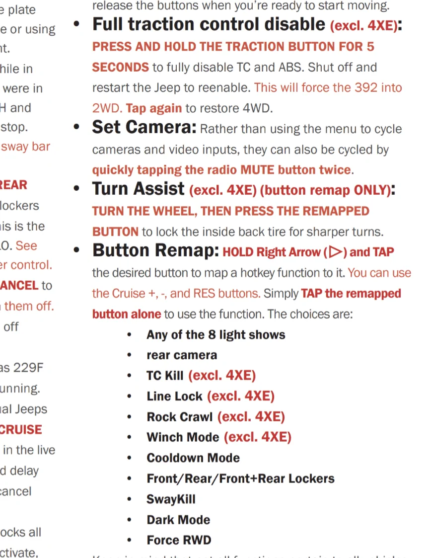

Tazer has a TC kill that can be mapped to a steering wheel button.
I can't find button mapping instructions on the Z Auto website. Link?

I leave mine on in 2H. Why not? I am on roads. If I hit a puddle, the computer is faster than me.
My "Ooops, I left in in 2H and didn’t notice because of TC" wasn’t a success. I was on my first beach drive with my new Jeep. I took a ferry to get to the island and had left my top at home because there was no rain in the forecast. I saw ominous clouds on the ferry ride. I went inside the Ranger office to get my permit and it started pouring. I ran out and started driving so the rain would fly over the windshield keeping the cab drier. I got a quarter mile out and bogged down because I was still in 2H. Stuck And spinning. After realizing that I was an idiot, I pulled it into 4H and drove right out of the problem with no issues.
I will add that the tip I read the other day on the forum about holding TC down for five seconds when in 4H so that I can lock the rear differential was a fantastic tip. I can’t wait to try that on the beach when my local beach opens to cars on September 15th.
