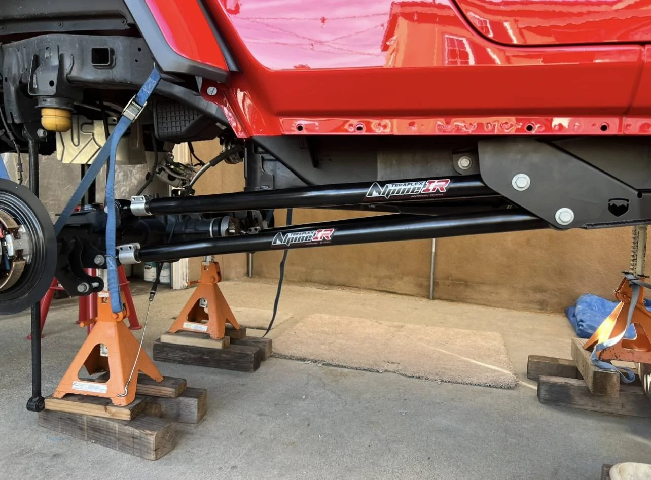

These fit or is Quadratec tripping?
Mount up just like stock. One part number, order two. Same same on both sides. They have a dual durometer-style bushing design for more travel.
