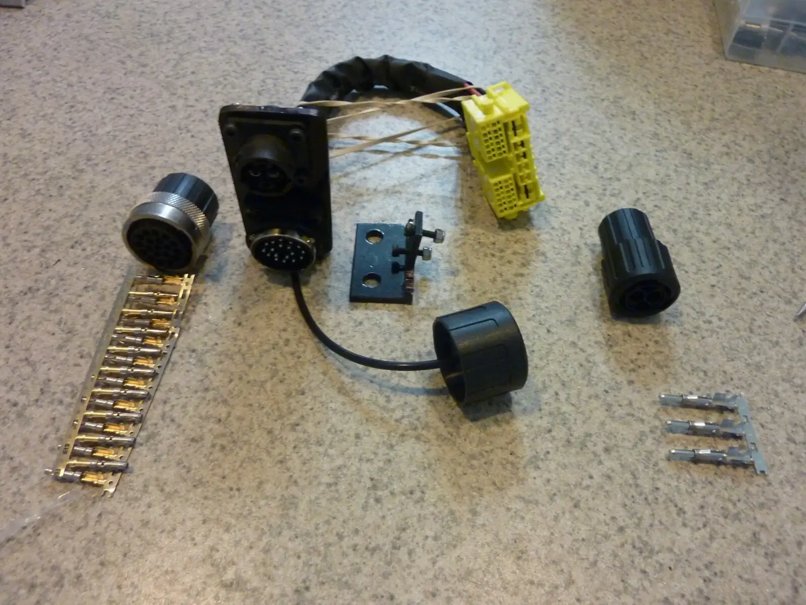

The same guy who makes the aftermarket passive entry harnesses also makes a door connector harness. No personal experience with it, and it seems pricey to me, but here ya go:
[edit] Maybe not so pricey going by the connector costs @ChrisNLA posted above.
https://www.ebay.com/itm/277566855875
Seems pretty reasonable based on what's there. Connectors and terminals add up fast.
Edit: Dang that would be $300 for two doors 😂
Well if you consider bracketry and labor, still totally understandable...
