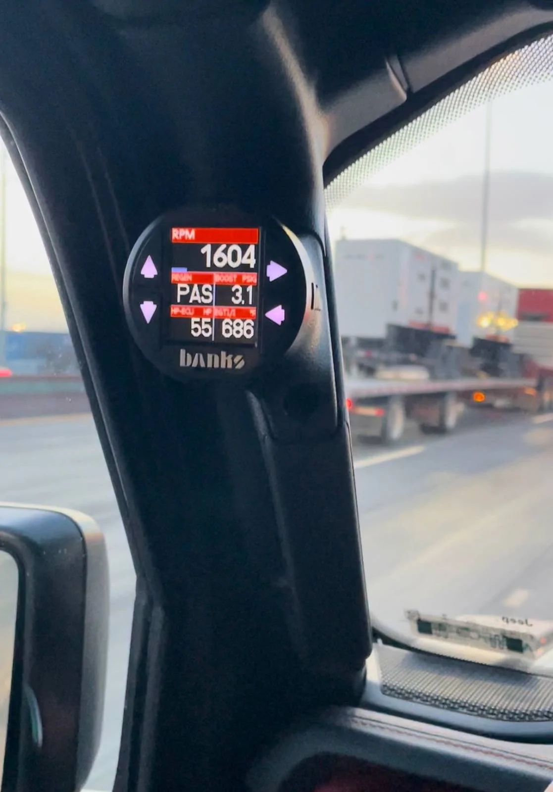

Banks iDash will display regen status along with about 134 other parameters.
Gregj
Jeep Gladiator Is there a way to see that regen is happening with Alphaobd2? IMG_8023
