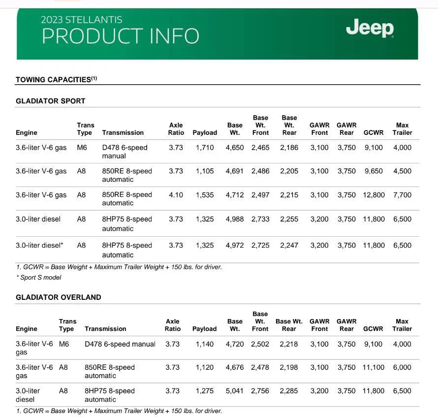

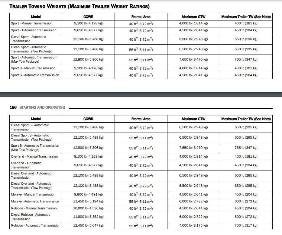

I've looked around this forum and found one mention that there is no functional difference on the diesel, just the hitch and wiring. Is this true? Is there any written proof of this?
I'm attaching the 2023 Stellantis Specs showing the diesel only has one tow ratings listed, but I'm also attaching a screenshot from an owner's manual which separates out diesel with tow package and diesel without. There, the towing capacity and payload are the same, but the frontal area of the trailer is different (40sq ft vs 55 sq ft), implying to me at least there is some difference.
Thank you, all.

Links for these files:
2023 Gladiator Owners Manual:
https://cdn.dealereprocess.org/cdn/servicemanuals/jeep/2023-gladiator.pdf
2023 Stellantis Specs:
https://s3.amazonaws.com/chryslerme...JP_Gladiator_SPaogc9msvnacjomlsc5ac25078o.pdf

It gets weirder when you look at the owner's manual chart and see that a Diesel Overland is 40 square feet with or without a tow package, gas OR diesel, yet trailer weights are different... that a Sport S gas is 40sq ft / 4500lbs and a Diesel Sport S is 40 sq ft / 6500 lbs.... that both automatic diesel and gas Rubicon are 55 SQ ft but trailer limit is 6k vs 7k....
What is causing the difference? Is it a sway control linkage?
