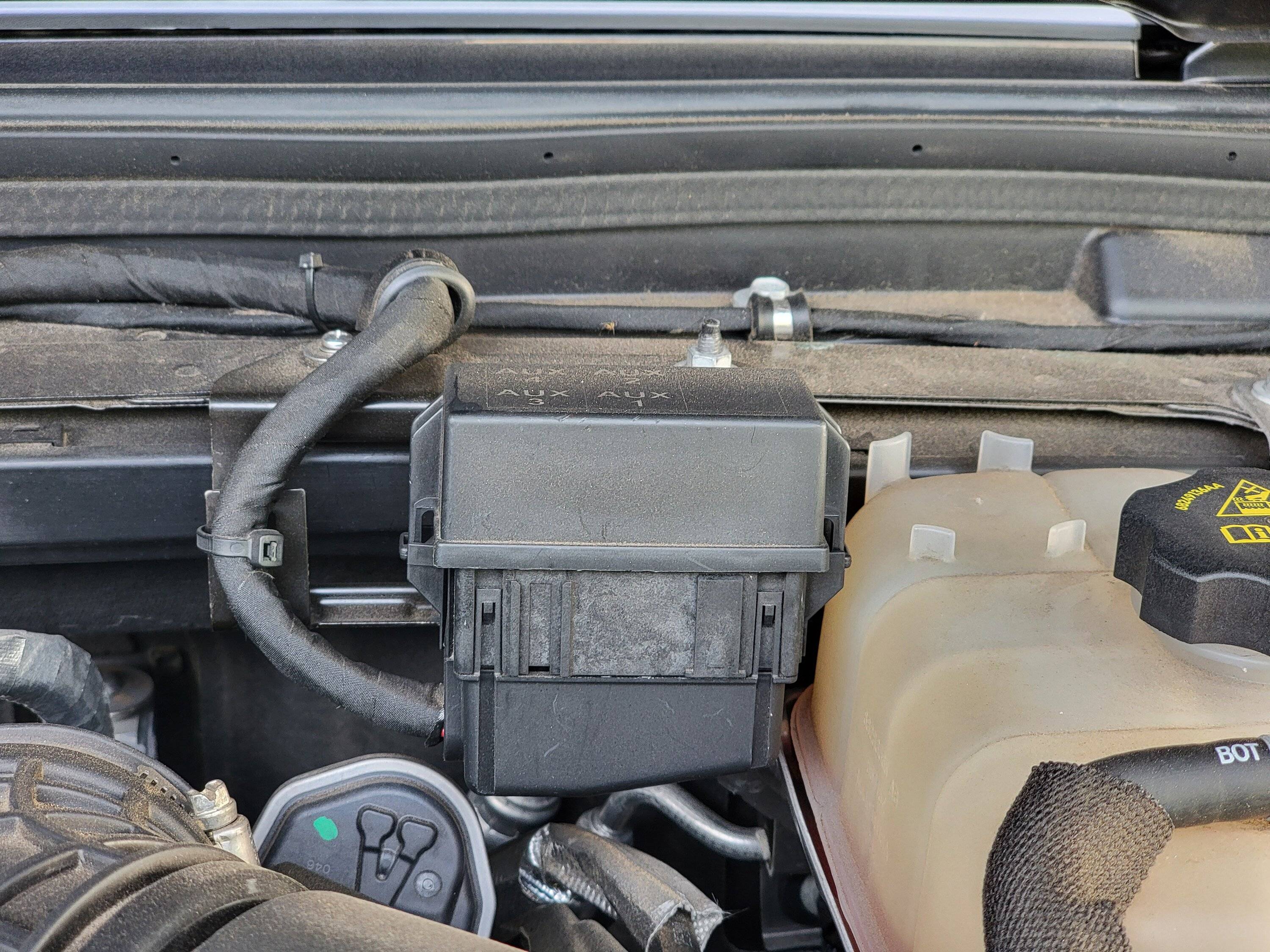

See, I knew some did. That's why I thought it was odd when they said the MOPAR kit was not compatible. Maybe it's because mine is a Sport S.
The Mopar kit is different than factory optioned.
1. Factory uses the fuse box for the circuit connection, relays, and fusing, totally built in on the wiring harness / add-on uses a relay bank you screw to the firewall near the brake booster and the fuses are inline on the way to the battery post.
2. Factory has 2 additional inside cab wires - 1 for always on and 1 for ignition on, without using an Aux switch.

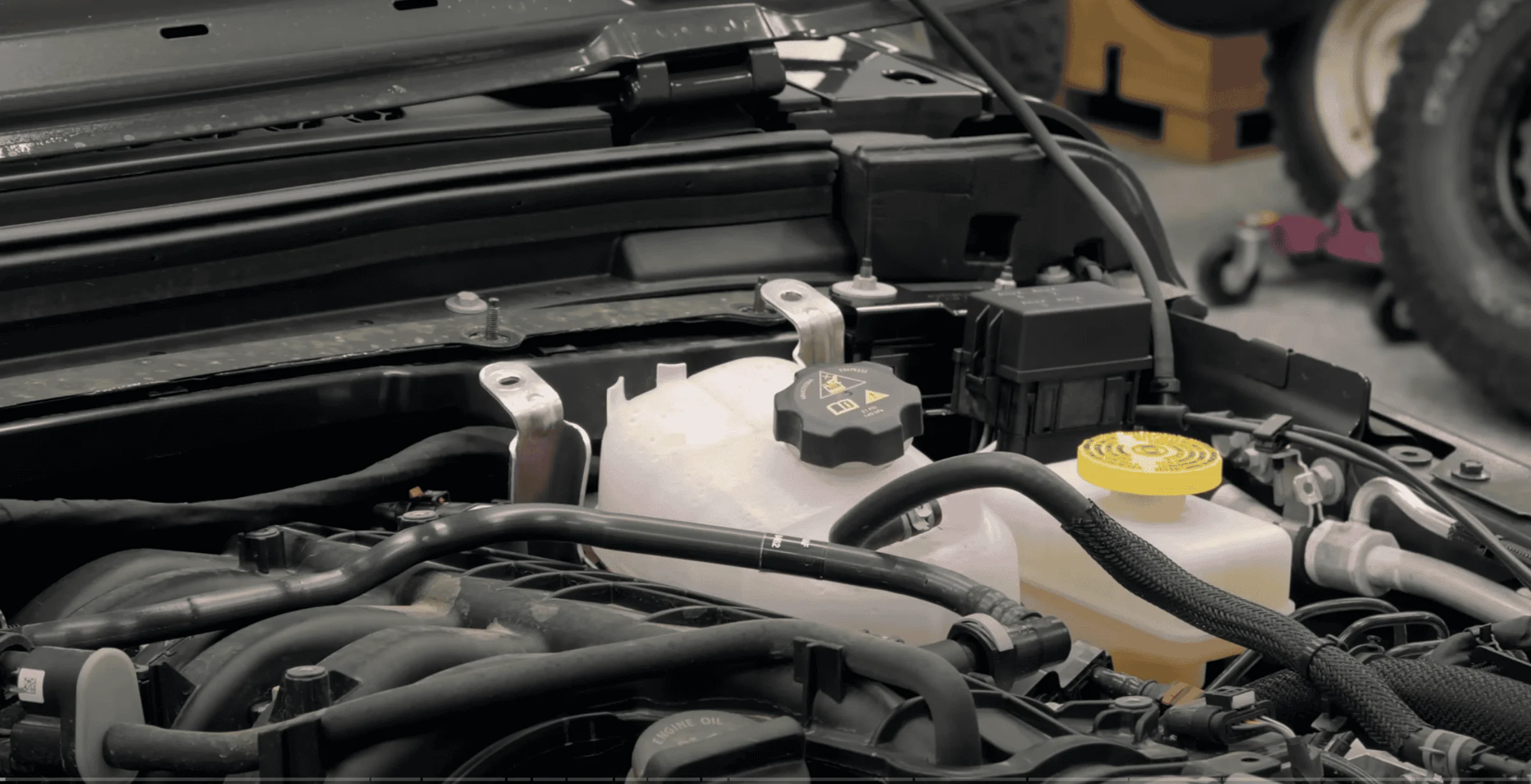

Diesel:
Jeep Gladiator Tow Package on EcoD 1704758152648
Add-on on a 3.6, black rectangular box to the right of the coolant exapnsion tank. Looks like diesel has something else there. Do what I think Rusty said earlier, just make a bracket and put it somewhere elese.
Jeep Gladiator Tow Package on EcoD 1704758296854

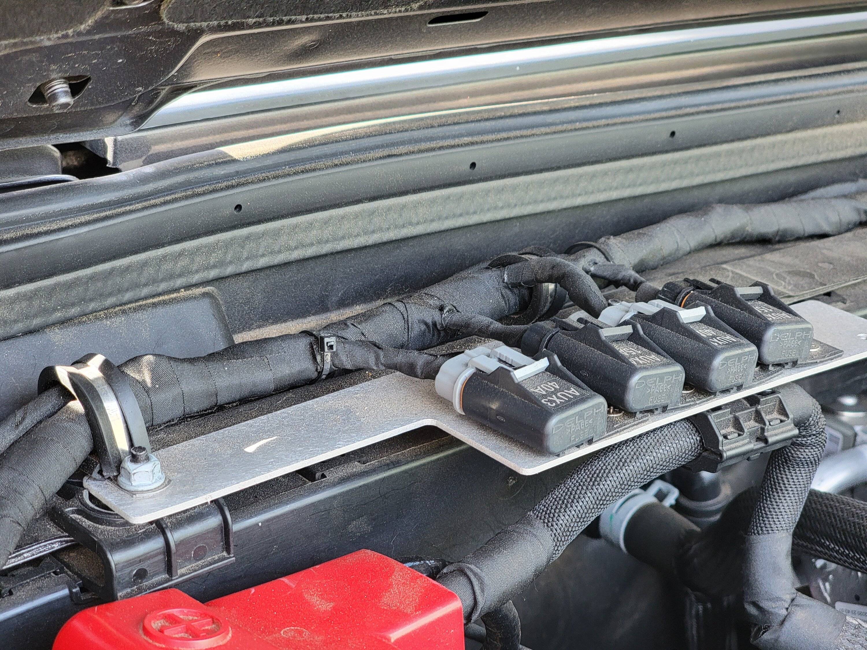

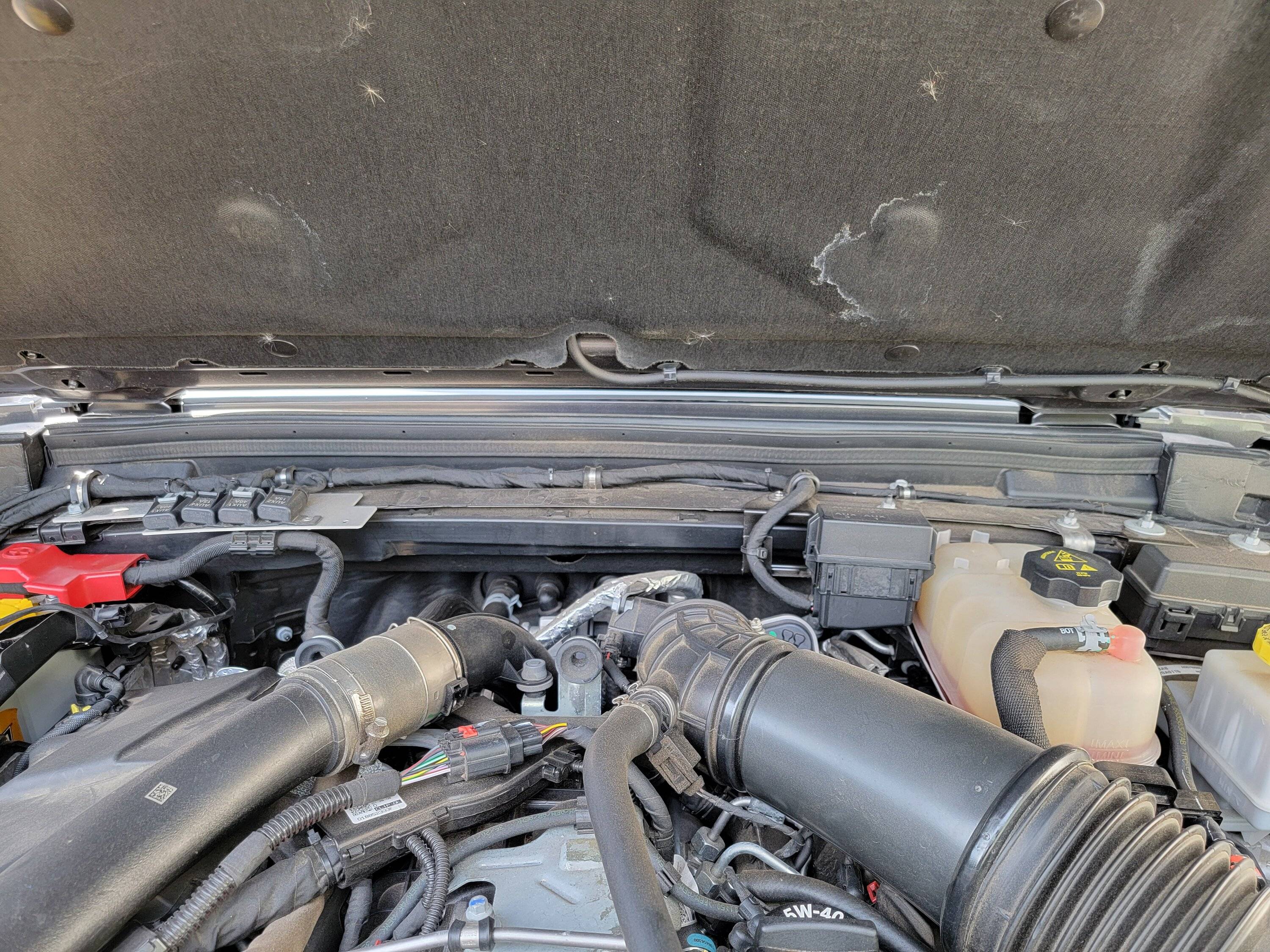

In my case, the parts guy told me that the kit was incompatible with the diesel because there was nowhere to mount the equipment, as you pointed out. So I purchased the kit anyway, found a place to mount the relays, and made my own bracket for the fuses. Then enable the switches using the Tazer. Works great.

I have the tow package and mine did not come with the AUX switches but I did install them. I do know that the MOPAR kit states it's not compatible with the diesel.That's because there is nowhere to mount the factory relay bracket. I made a custom mount for mine. Enable it with the Tazer and good to go.
Mopar sells the bracket for Diesels to mount it.

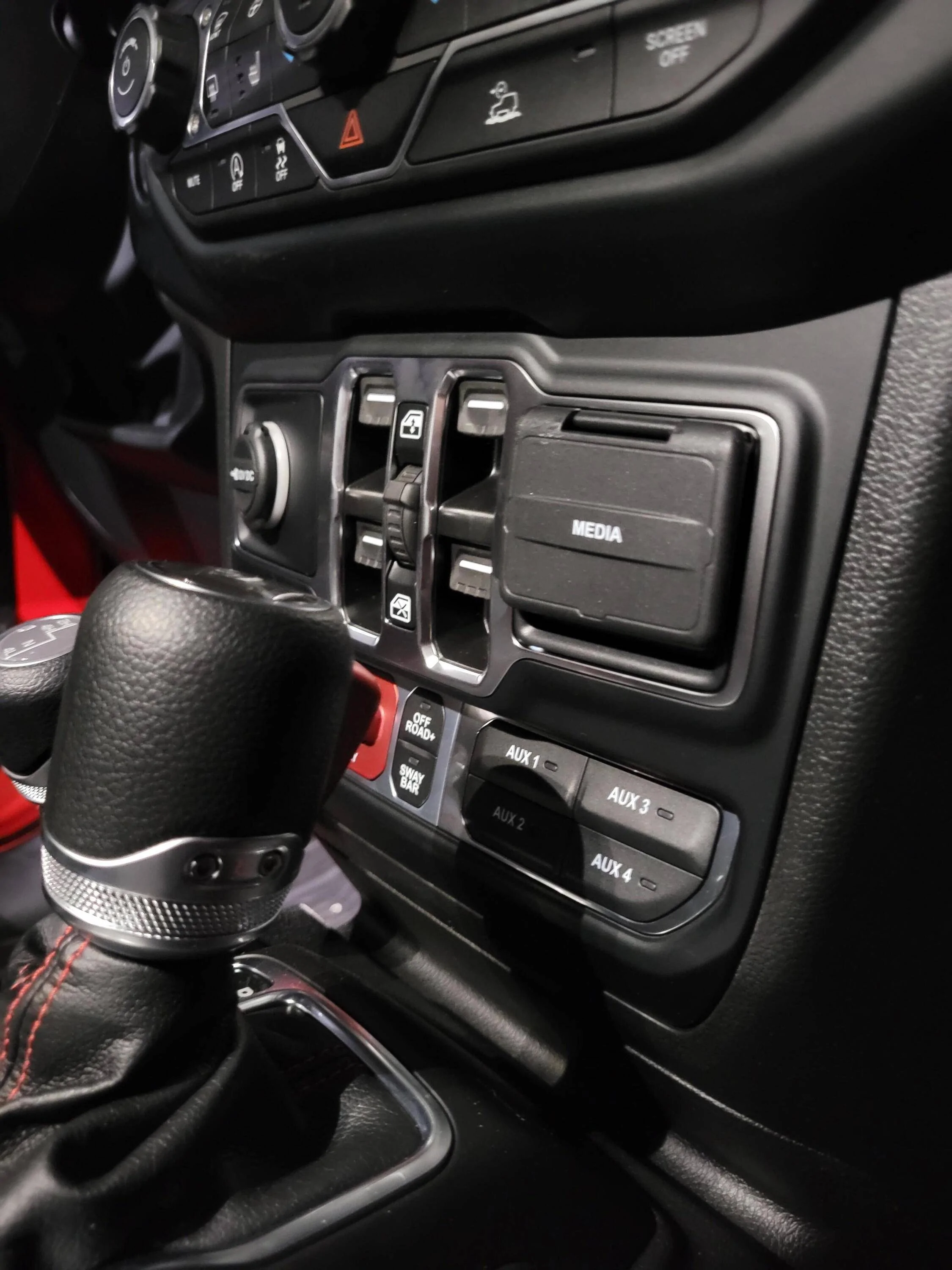

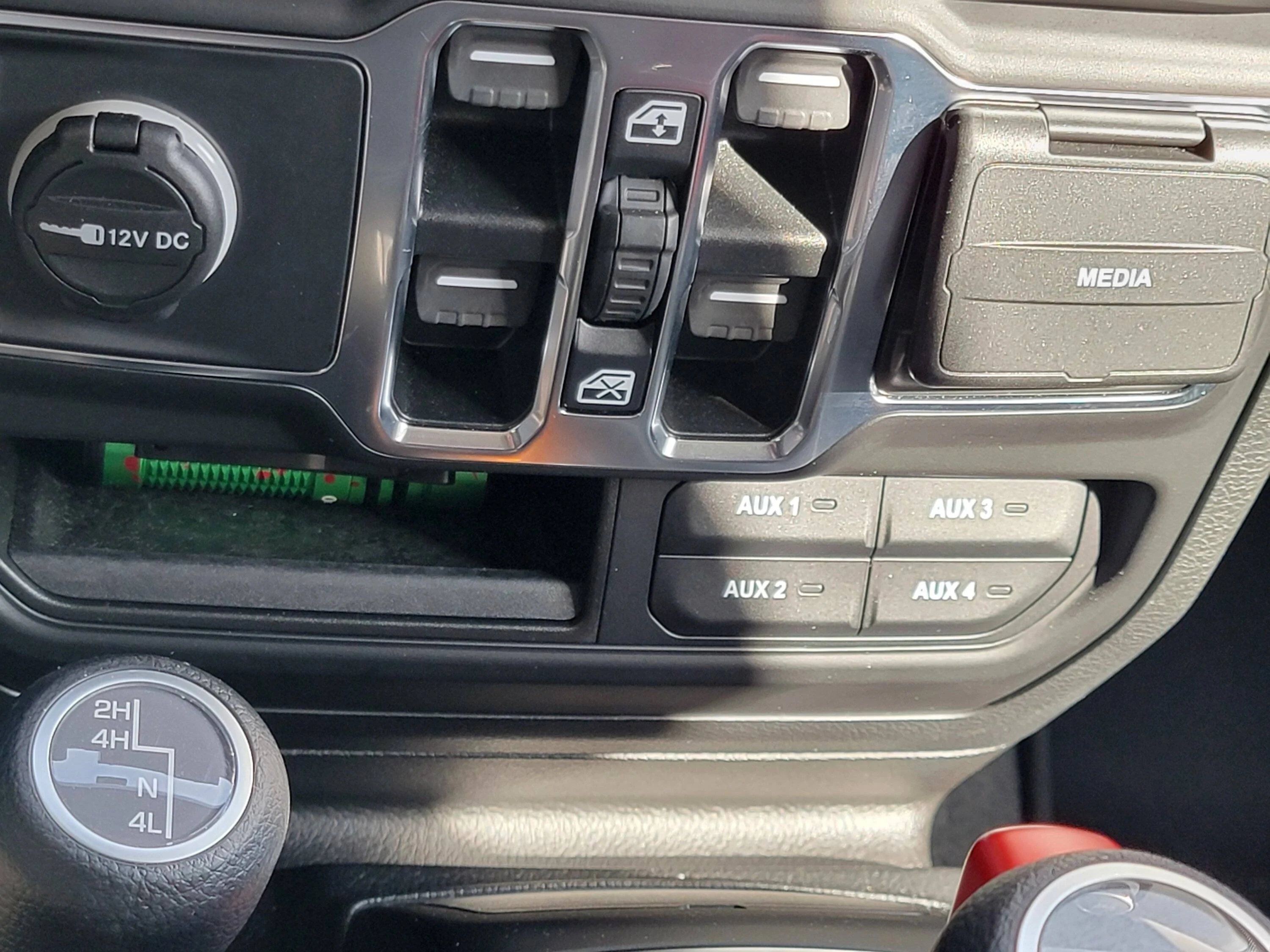

I have a 2023 Rubicon EcoDiesel. It came factory with the tow package and auxiliary switches. Out of curiosity, what you are guys running off your auxiliary switches?
I used the two 15A circuits as disconnects, triggering contactors to suppliers powers to my winch and bed. One of the 40A for swaybar disconnect. Saved the last 40A for future lights.
1 high amp on a pillar pods, 1 unused. 1 low amp running high mode on my rock lights. The other low amp runs my blue lights. It's nice they can be configured with or without ignition on.
