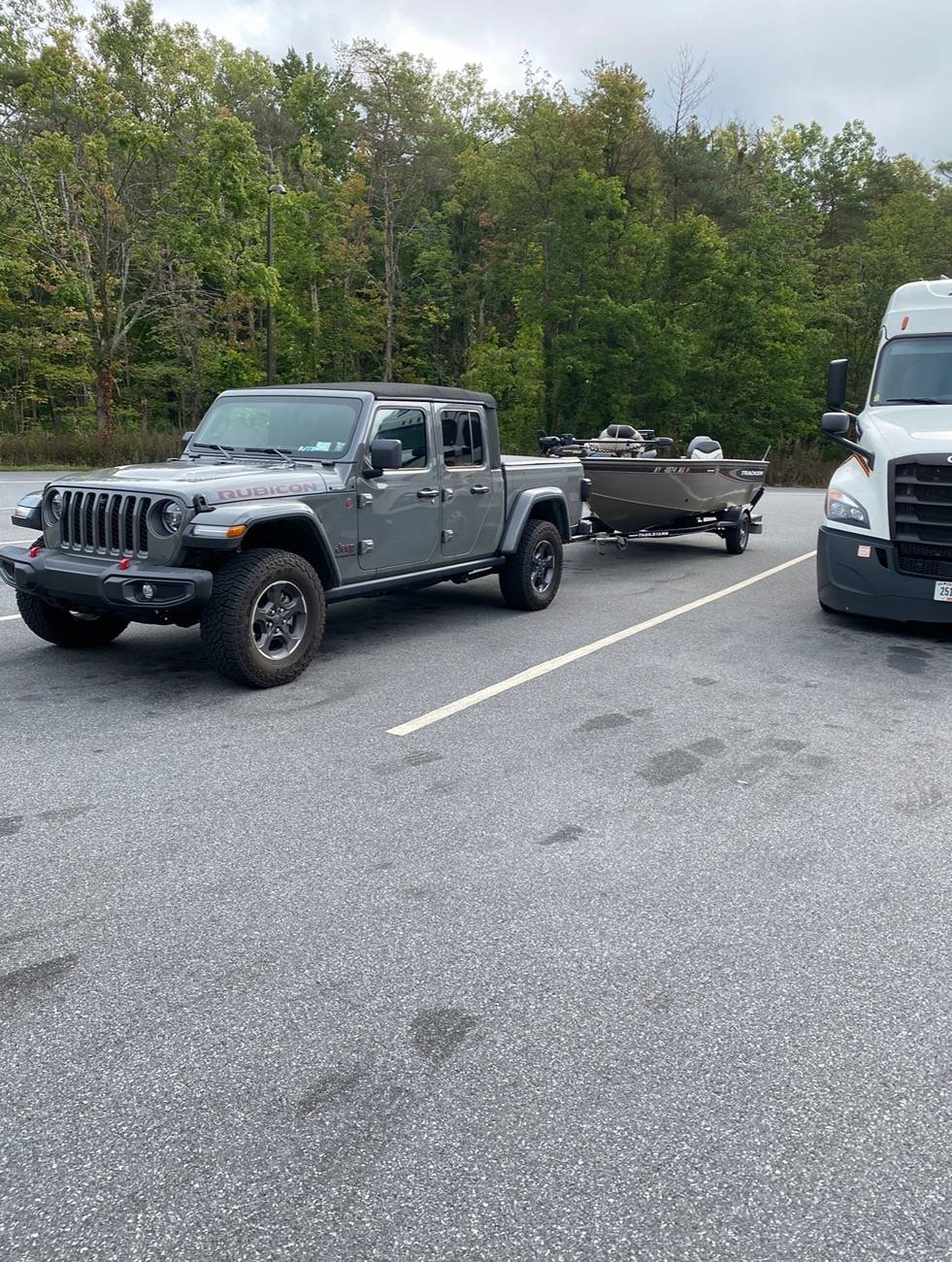

I’ve towed my boat a few times in the Adirondacks, it de-rated once, put it manual mode to a gear less and didn’t de-rate again.
Jeep Gladiator Towing vs non towing package differences A04BFEEF-2D41-4DAD-BE52-655E6C0AC3B8
