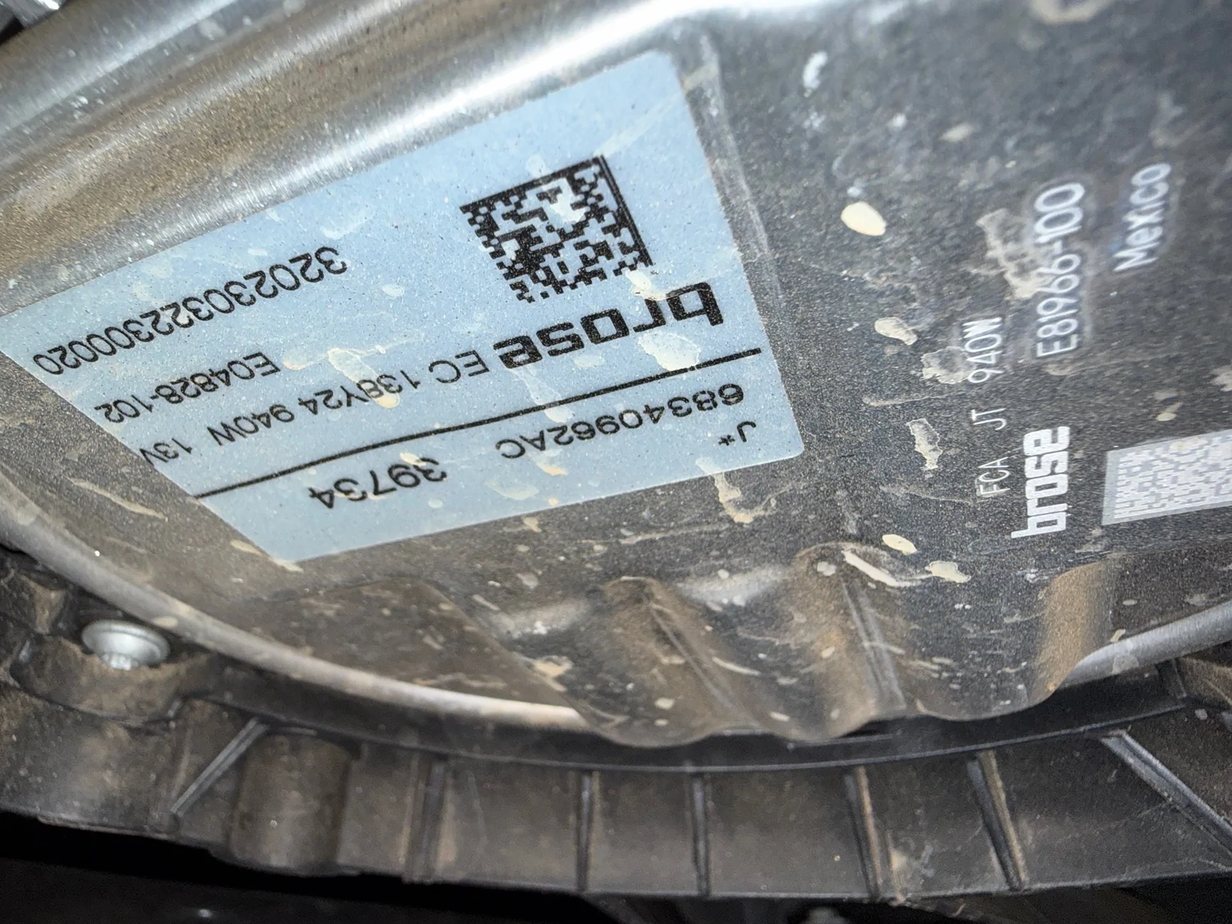

Trying to find out my towing capacity on my Jeep Gladiator. Towing package was not selected.
I know it’s been talked about before but it seems nobody has given a concrete answer. From the manual I see it’s 6000lb talking to parts counter at Jeep they told me it’s 6,500lb. Having the rubicon I have all the upgrades the Max Tow already has less the receiver which I’ll be upgrading anyway.
I looked under my hood I have a 940W fan and 220amp alternator. So much information and before I buy a camper I want to verify capacity.

Even without tow package it’s still 6,000 correct? My fan is 940w which is strange because 850 was the upgrade from what I understand.
I’m at 4300 dry. But I want to make sure I’m within my limits.

All ecodiesel Gladiators came equipped with the heavy duty cooling fan, alternator, and larger battery, so there's no difference in tow rating between those that came with the factory tow package and those that didn't but later had a proper hitch installed.
The diesel Rubicon is the only one spec'd at 6000lbs, all other diesel trims spec'd at 6500lbs tow capacity.

I was looking at my build sheet and then looked at another build sheet where they had towing package and there was mention of standard and heavy duty cooling. Both were eco diesels both rubicons. Seems that’s all just marketing.
I do know mechanically the diesel rubicons have identical to max tow package on non diesels, looks like I’ll be upgrading my hitch and that’ll give me the “towing” package.

The standard versus heavy duty cooling difference and its effect on tow ratings is a real thing for the 3.6 gassers, just not the ecodiesel.

Right, but on diesels it’s just marketing it seems. At least when it comes to rubicons.

These systems are typically automated by default so they can scale, and the towing package likely carried some of those variables with it. They just got pulled onto the build sheet even though they don’t actually change anything. I know for gassers it matters but for diesels I don’t think it does. All the research I’ve done so far seems to confirm it.
Another clue is the owners manual has no distinction for diesel with or without towing package like it does for gassers.
