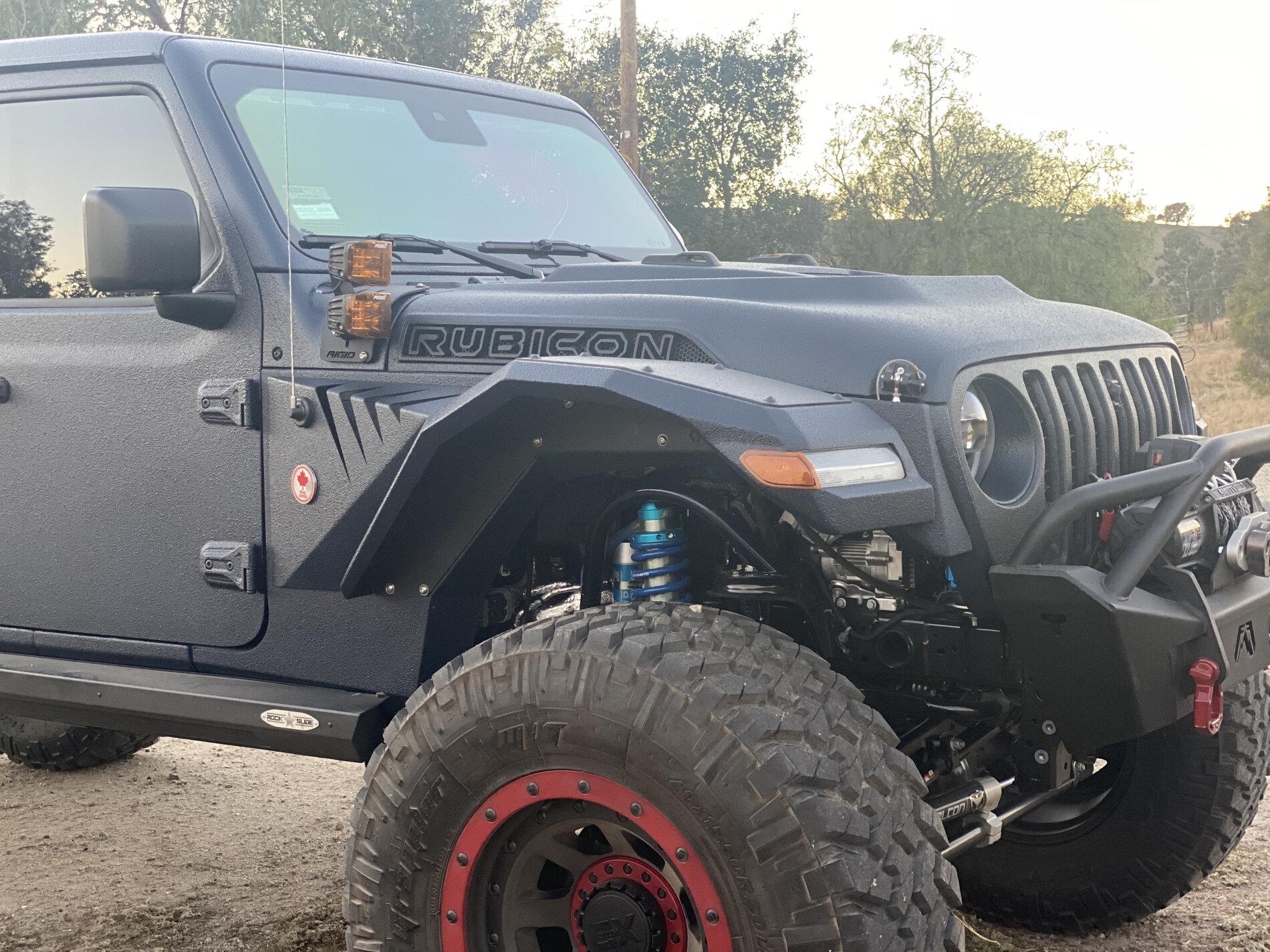

Restricted airflow is a reason I see they lowered the tow rating so I'm confused as to why no factory mods are out there to help out. The overland hood has no convent place to put vents - even if I did install top vents they would be rear facing as I am sure forcing air down would only defeat the factory air flow. .
Saw a post by "sourdough" on the wrangler forum where he lifted the back of the hood - I don't know - looks a bit odd but I'll bet it removes a lot of heat.

an induction hood with a rear facing opening
