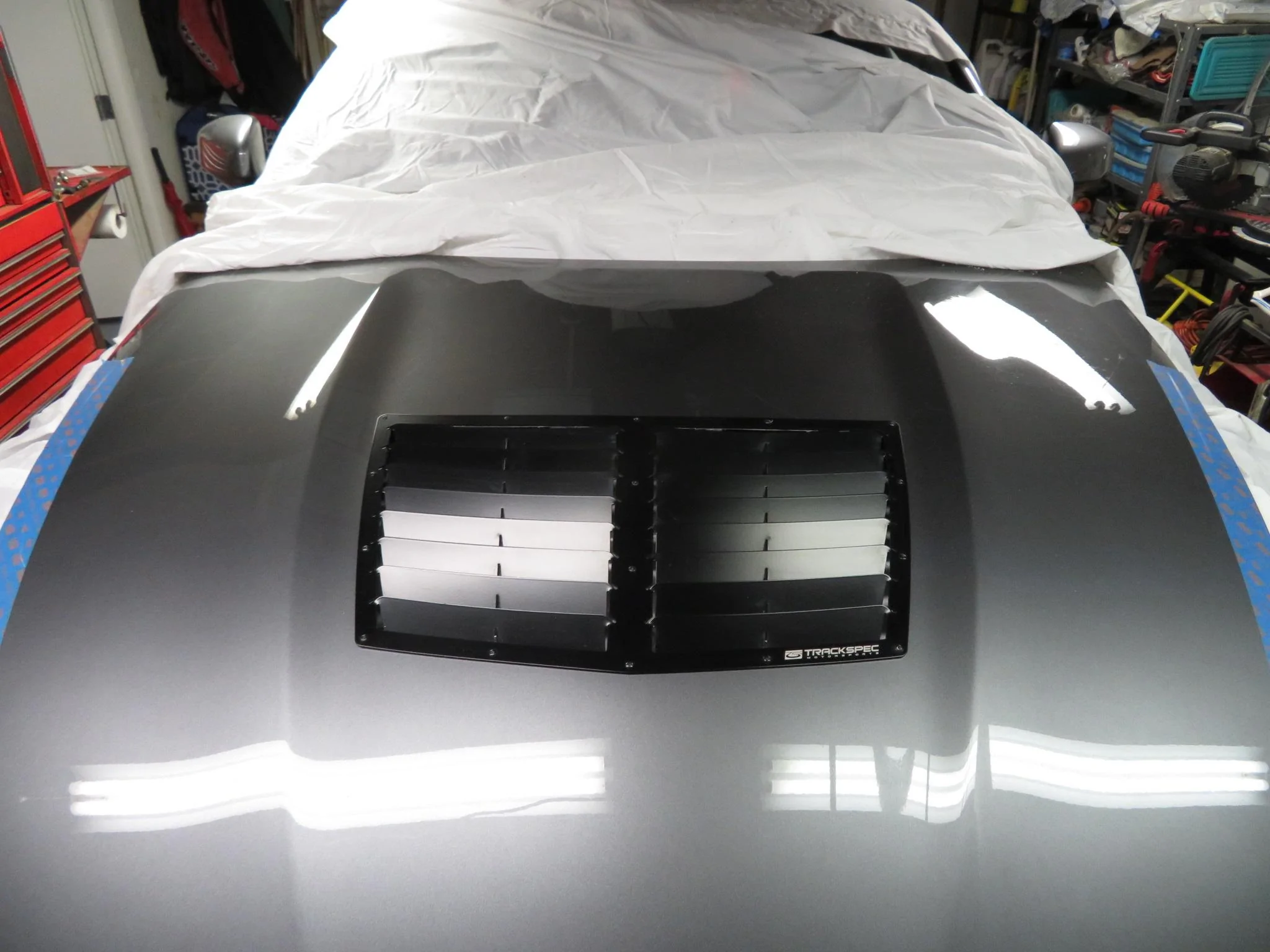

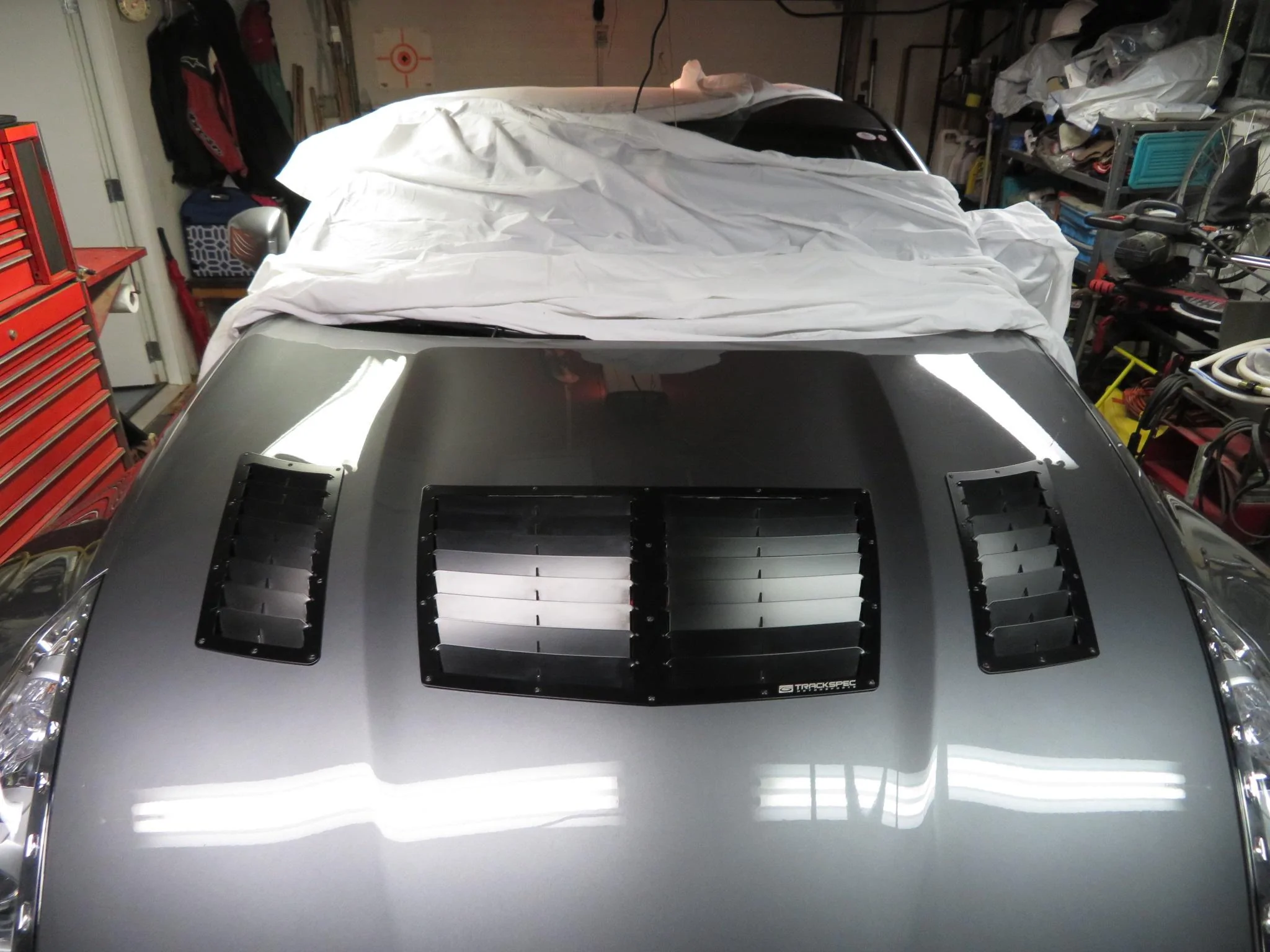

The location of vents makes a big difference. On my Nismo. No vents in the hood. I could see water temps in the 250 range, and oil in the 270 range after a 30 minute session. I added a center vent right behind the radiator. The temps dropped to 220 water and 220 oil after a session. I added 2 other side vents. Those really don't do much when moving. But let out the heat sitting still. If the vents are too far towards the windshield. They will not vent properly. The base of the windshield is a high pressure area. I opened up the vents on my JTRD hood. didn't see much difference. Think if it was a center location, behind the radiator. you would see a difference. The 392 style hood would do nothing for cooling. Instead of letting air out. It would be pushing air in at the wrong location.

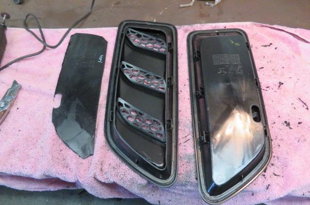

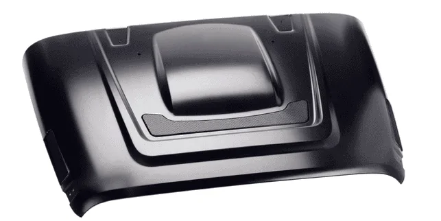

The Wrangler 392 hood which is the same as the Mojave hood has a Hydro-Glide system which provides cold air direct to air cleaner and has openings directing air directly towards the rear on both sides of engine, with rubber flaps that hang down and shut off vents when not moving and allow radiator pressure to be factory. Not a cheap mod, but one I am planning on doing in future.
I believe any cooler air entering the rear of engine compartment will help a little bit and possibly cool the air going under the body tub......Jack

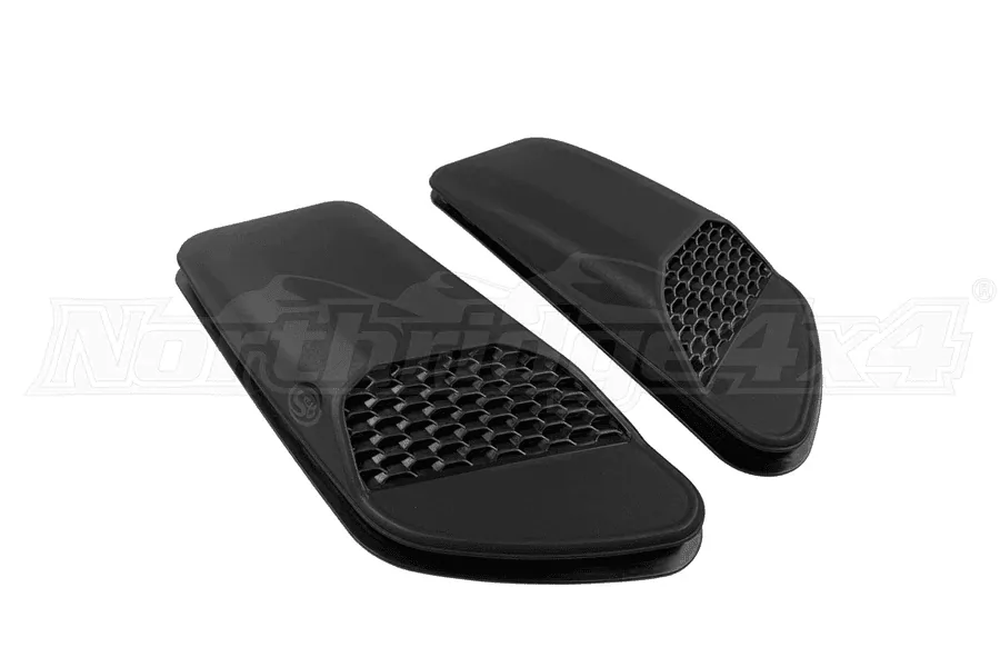

AEV made a heat reduction hood for the JKs and it had a large vent just behind the front edge. They like to test everything and here is their opinion -
The central vent of the Heat Reduction Hood is positioned to take advantage of the low-pressure area created at the front edge of the Hood when the vehicle is in motion. Since air moves from high pressure to low pressure areas, the placement of the center vent causes cooler outside air to be drawn through the radiator and up through the Hood.

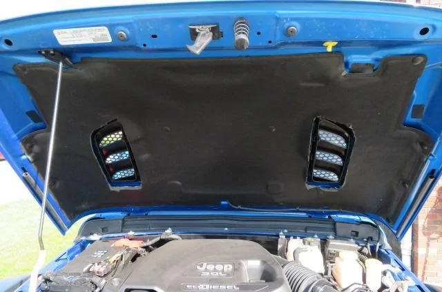

Essentially cutting the Rubicon vents is doing the same thing albeit via our shade tree engineering and could be a little far back compared to the AEV vent. Mine have been cut for a couple months and no issues, but no noticeable temp differences. Think @dcmdon makes a good point about the computer keeping everything in range.

Thats a little salty, but I have also been thinking about it somewhere along the line, after I spend the rest of my life's savings on mods 😜 A Mojave or Rub hood are cheaper arent they? You could make the Rub vents active without too much trouble if you have any fab skills at all. Only thing is if water can get into the engine area, what starts happening with electronic parts?
My JTRD has sat out in a down pour without any issues. It just washes off some of the dust under the open vents.
