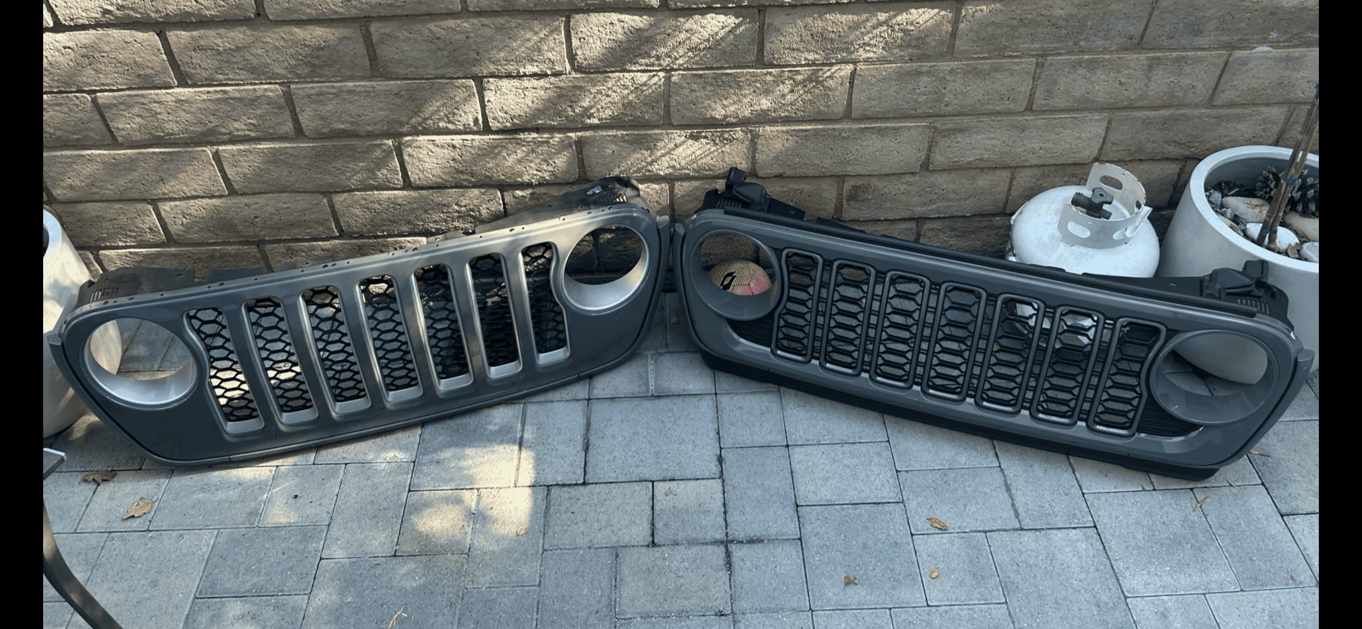

@Primer Gray When you compared the ‘24 grille to your old grille was there much of a difference visually to the amount of air it could let through? Any fitment challenges? Lastly, where did you source it given none of the MOPAR sites seem to have ‘24 parts? Very impressed with your commitment to cooling, your jeep is impressive, well done!

The new grill is substantially more open than the original — probably 25% more unrestricted airflow.
I purchased through Distinction Applied, they offer the new grill painted and ready to install. Their website interface is super simple and allows you to select whatever trim colors/finishes you desire. When I received the new grill, I noticed a small paint blemish and the guys over at distinction had a replacement trim piece shipped out to me within a week. Super satisfied with them.
There were absolutely no fitment issues whatsoever, and the new grill actually has more clearance at the bottom area which simplifies wiring/installing a winch. The entire swap takes about 20 minutes as the assembly is attached with clips and plastic body fasteners — I did end up adding a few pop rivets in some areas to firm it up, but that was not necessary.

Oh, thanks for the picture! I didn't realize the air also passes between the grill slots on the new one. That's helpful.
