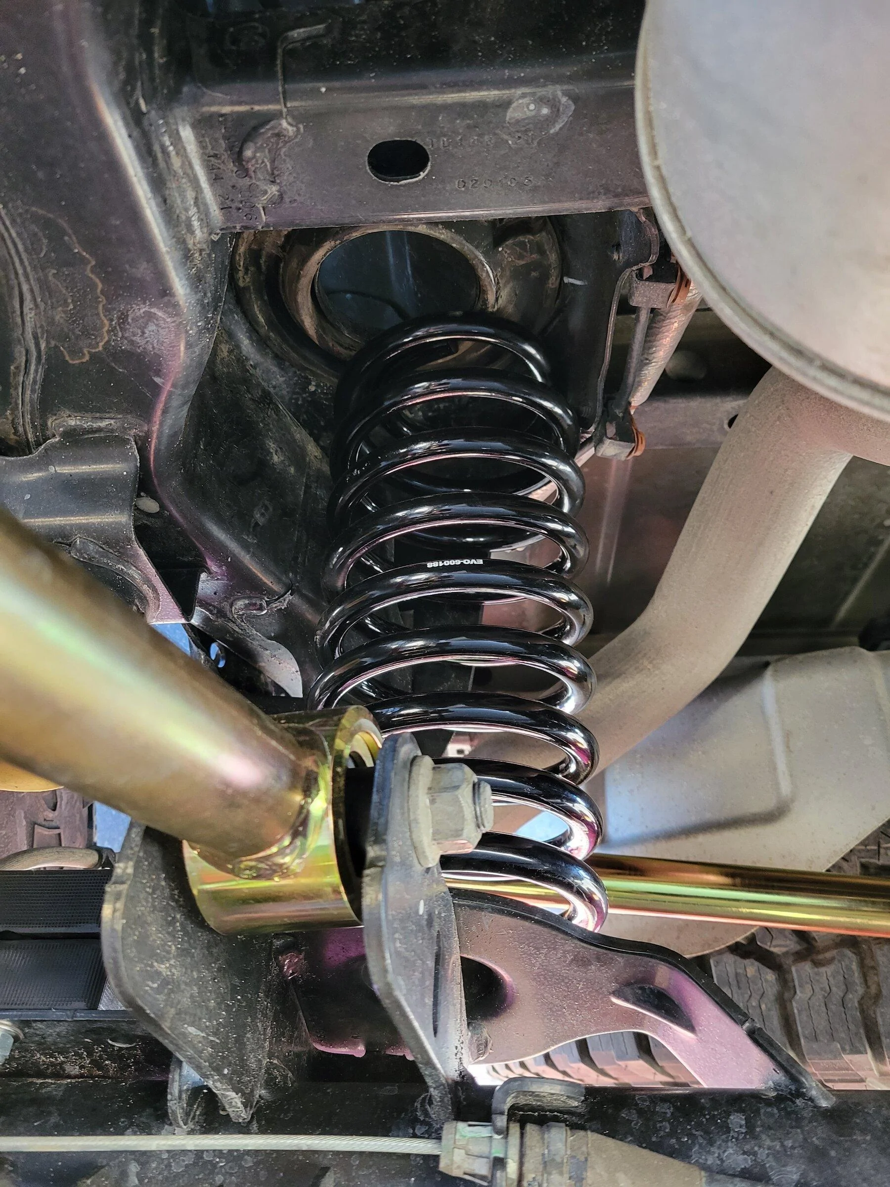

I started install yesterday, and finished up today. Overall....not bad. I didnt run into any issues removing/installing anything...although the locker disconnect was difficult, and the front trackbar was difficult to connect frame side.
I have to solve one issue though. The rear springs do not seat...I dont know if because MC substituted their springs for the evo ones, I didnt get the required isolators, or if I just got the wrong rear springs period. Ill call tomorrow, and have my alignment tuesday, so Im hoping to have it all squared away then.
Otherwise, it looks great, and I like the height. Ill post some pictures later this week. I think when I get back in to correct the springs, Ill add a puck, because the rake is gone.
Maybe someone looking at this picture can provide some insight:
Jeep Gladiator RK 4.5 inch Diesel X Factor No Limits...Pros/Cons, Other 4.5 Options for diesel? 20220227_154123
The top of the spring is too thin to seat up top...wrong springs? Need special isolators? Or am I missing something else?

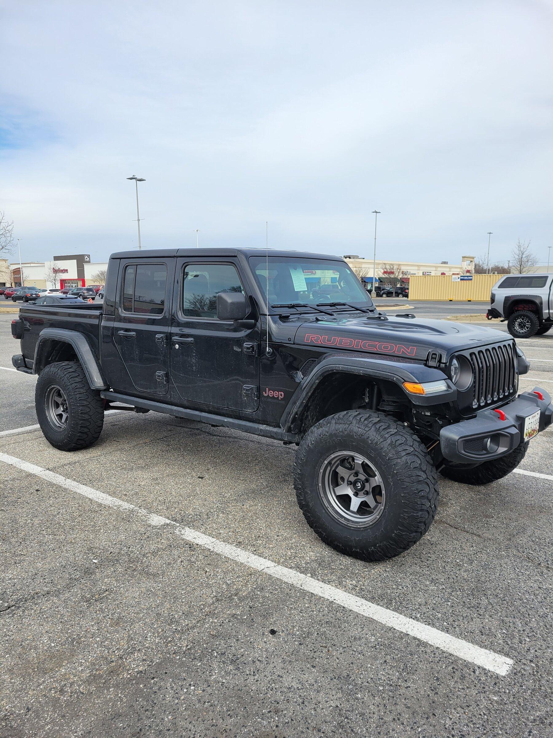

Alright, end of the story:
Was able to short order some Rubicon Express 4.5 inch rear springs in time to make my alignment the next day. Here is the finished product, MetalCloak, Evo fronts, RubExp rear:
Jeep Gladiator RK 4.5 inch Diesel X Factor No Limits...Pros/Cons, Other 4.5 Options for diesel? 20220301_142316
spring is upside down, notice part number
We tried both ways, just got a picture of it this way. The spring was for the JL, which is totally different than the JT rear.
