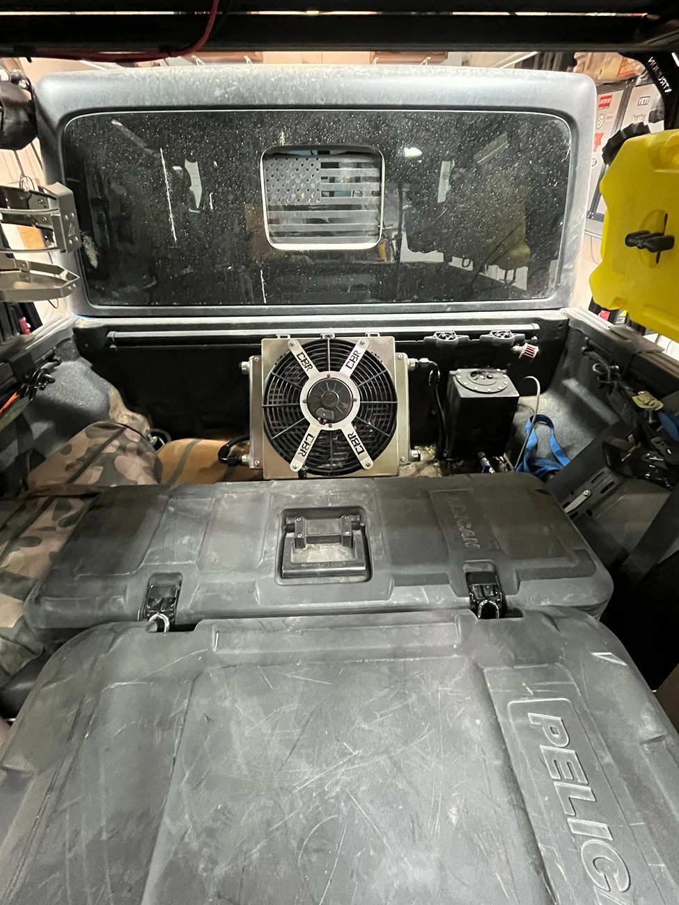

suroot
BIll
Feb 11, 2022
Cherokee Trailhawk, ZO6 Corvette, JTRD
CIO
I built a completely separate/closed oil cooling loop that pulls oil from the pan, runs it through an external CBR cooler/fan setup mounted in the bed area, and then returns it back to the oil pan. Flow is roughly 2–3 GPM. This is not tied into the factory coolant/oil cooler circuit. It is a separate oil loop and added about 3 quarts of total oil capacity.
The tank on the right is not related to the cooling system. It is a 1-gallon tank that feeds my heater for camping when I am not pulling the trailer.
Before doing this, I would see oil temps climb to 275°F+ towing my roughly 3,000 lb trailer up long grades. With this setup running, the highest I’ve seen is about 235°F under the same kind of towing conditions. It knocked roughly 40°F off my worst-case oil temps while towing.
I wanted a setup that lets me tow at a reasonable speed without watching oil temps run away. The truck is used for rock crawling and pulling an off-road trailer only.
-B
How did you tap into the oil system? I've considered going straight into the oil pan with -10AN fittings and using a Tilton oil pump to circulate oil through a cooler completely separately from the engine's oil circuit.

I like the idea of a dedicated oil cooler for a oil. I am glad your solution works and keeps the oil temps down.
I do want to ask about EGT's; oil temp and EGT's are proportional to added work/load. My concern is you knocked the oil temps down, but are now cooking the turbo and down tubes running sustained periods of high boost. Have you monitored EGT's and whats the highest seen for how long?
