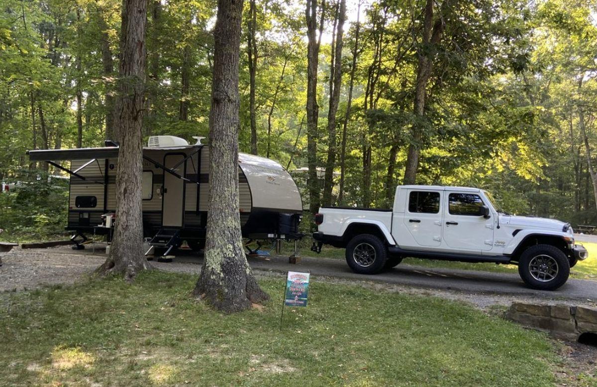

I pulled about 4700# up 7-9% grades in the summer @ 60mph. 488 gears/ 3.6 gas. No cooling issues at all. Trans or motor. Diesel should have no Motor or trans issues. Your towing restrictions are due to suspension and axles. It's not Motor performance related.

how do you feel about the 4.88? What size tire?

285/75/18 ( 35/11.5/18) I think the combination 488 & 35" tire is awesome. Great increase in all around performance. Getting 16 MPG average. As good if not better than what you would get struggling with stock 373's. I am using all 8 gears in transmission now. Was seeing mostly 5th and 6th with the 373.
