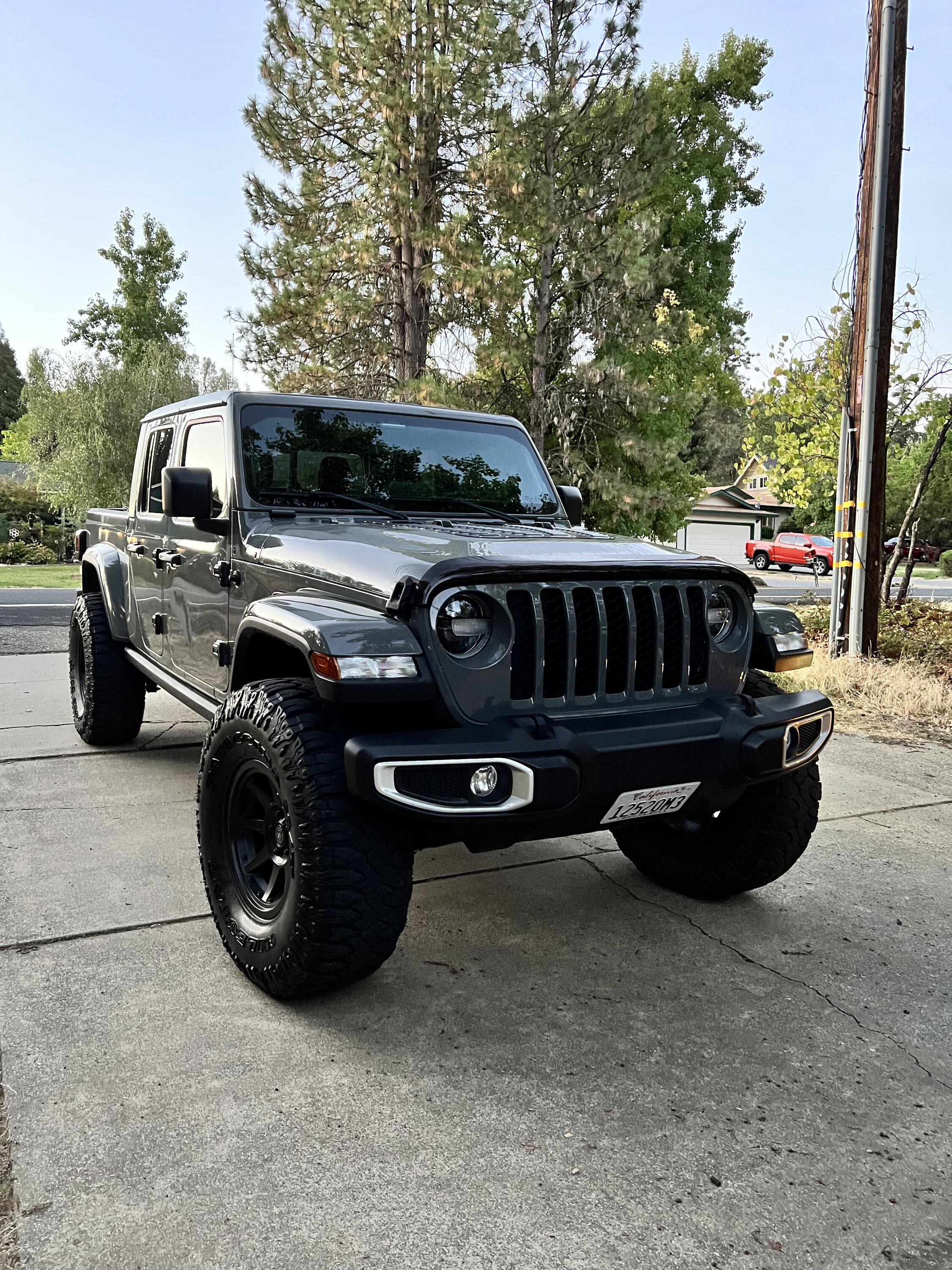

As I expected, good to hear!! If you get a free moment would you mind posting a pic of your front end but higher up so we can see the louvers? I'm thinking about doing this mod sooner rather than later and seeing yours will probably put me over the edge lol
Did you cut out the underhood insulation or just remove it all together?
I removed the underhood insulation. Installation is not for the timid. It is a disaster to get everything done perfectly. I also ended up with one small ding from my jigsaw jumping out on the last cut even with tape around the work area. A blanket is probably a better idea.
Its like 40 holes 16 long cuts with a jigsaw some unibit holes all through 3 layers of aluminum.
Not sure how a cut off wheel would cut through aluminum. the best option is likely a oscillating saw!
I would definitely go with a multimaster or potentially even a top end jigsaw like the carvex by festool.
After installing the same louvers on my JK i'm all too familiar with how scary it can be throughout the whole process LOL. I used a dewalt angle grinder with a cutting wheel and it cut through the hood like butter, although it sent sparks/future microrust all over the place...might give an oscillating saw a try on this one as you suggested. Gracias.
