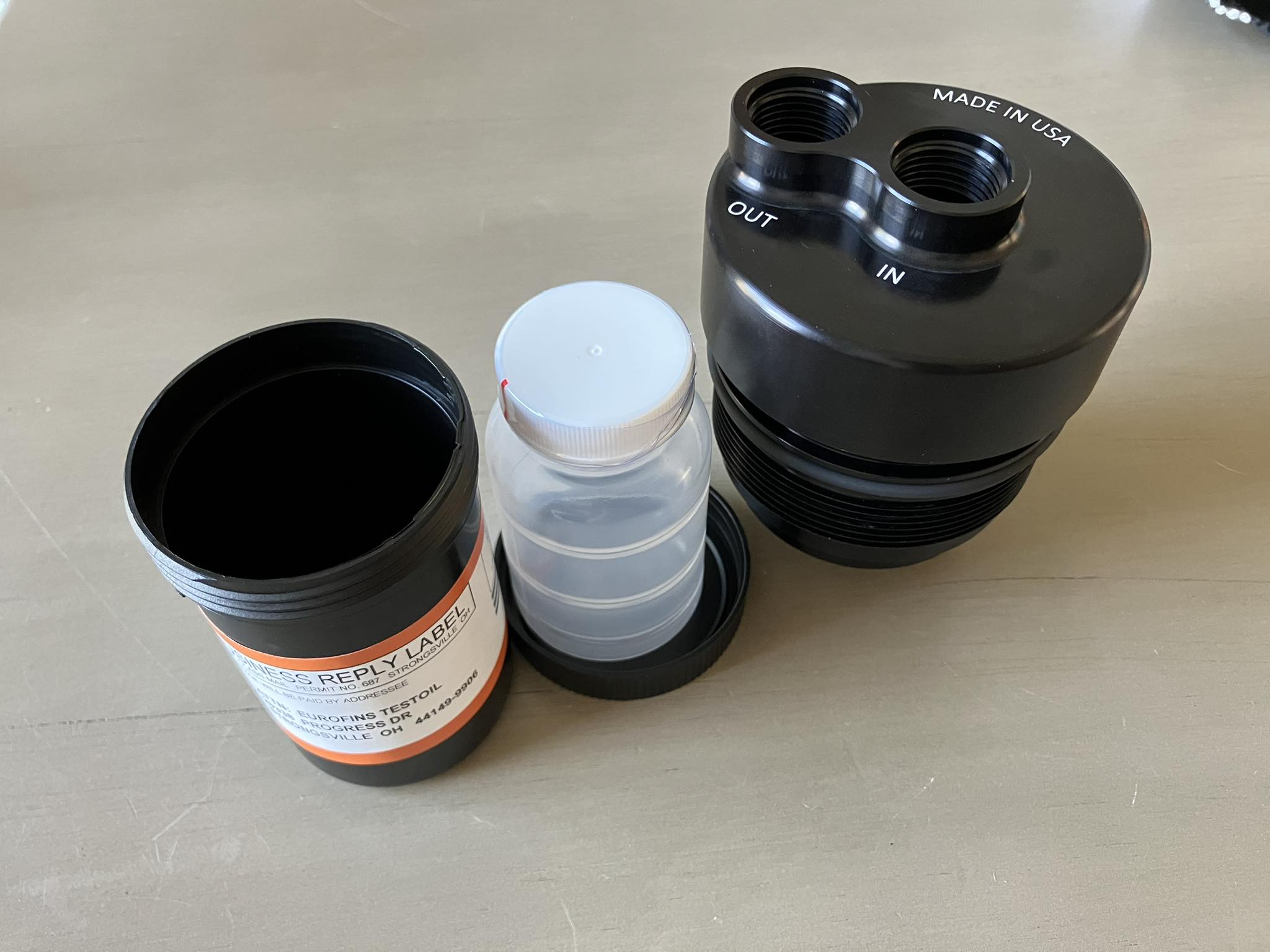

Hey All, seems like this thread just keeps on truckin! Been a while, but i just got a new travel trailer, so I wanted to check on the progress!
I this post from @biodiesel and I was wondering if there has been any updates? Wasn't able to access the facebook group.
Mat has been working on that for two years. Here's a sneak peak of what the oil filter adapter cap will look like.
