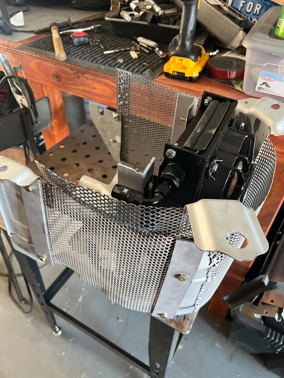

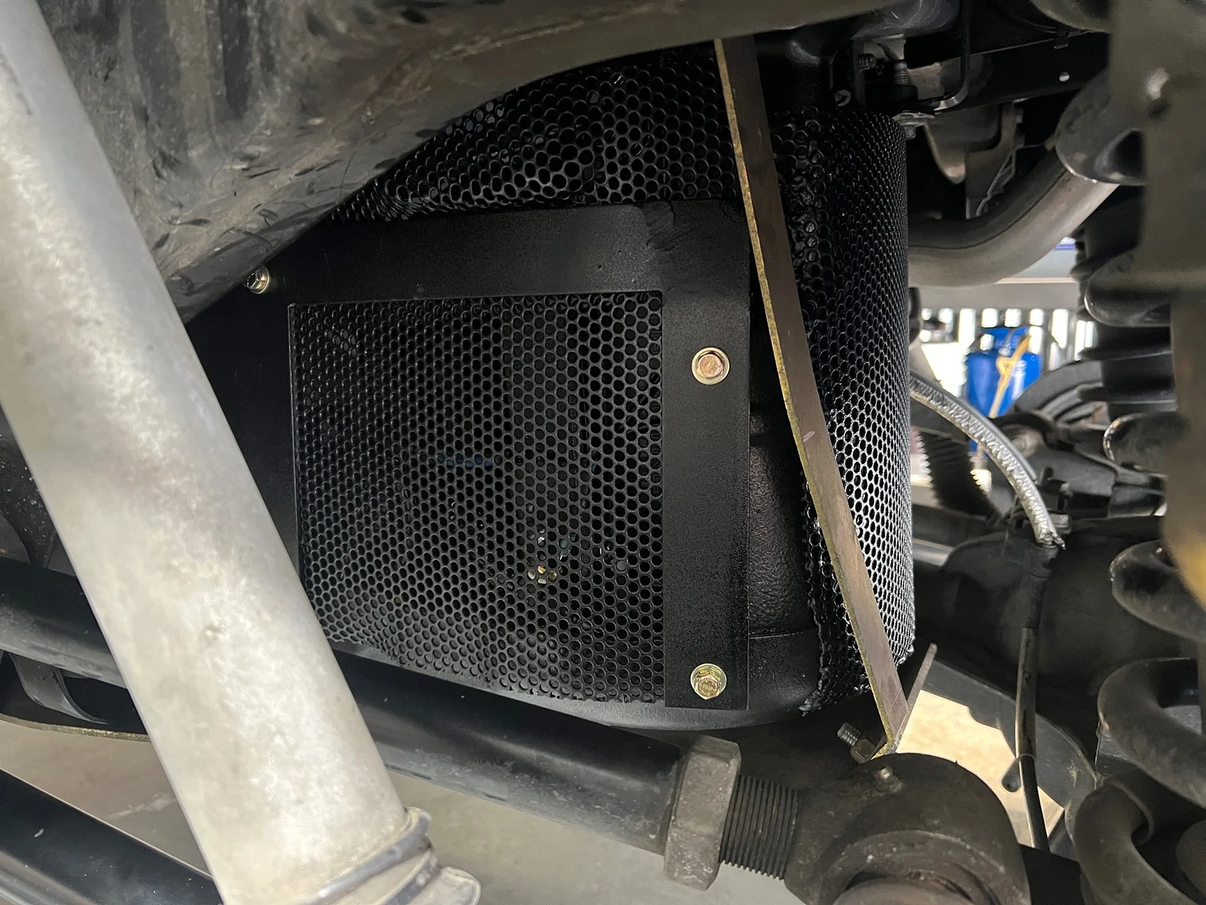

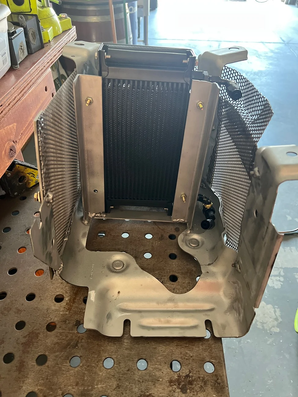

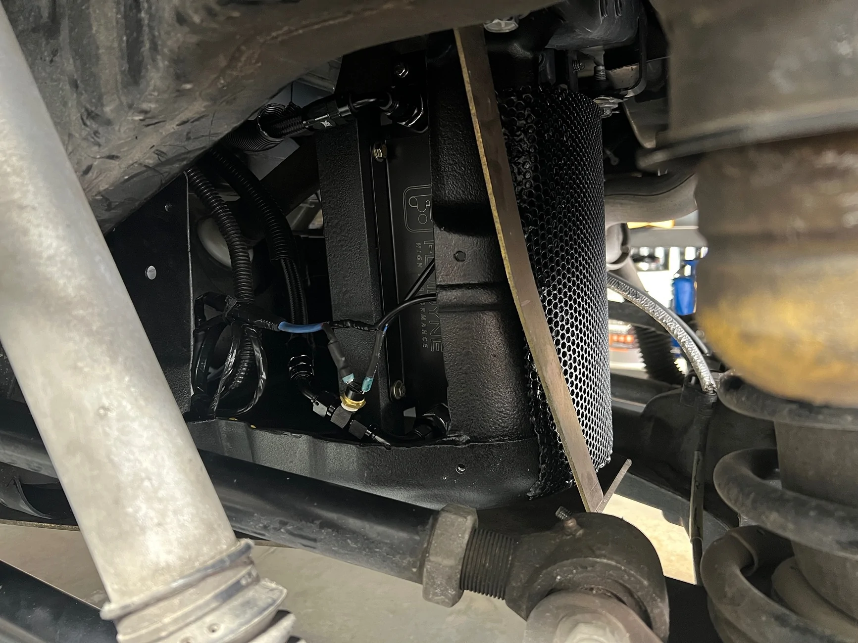

Soon I’ll have my insane diesel bypass kit with the oil cooler in def tank location and CSF radiator in . This with my meth injection I will have no problems anymore while towing.

I'd love to see some pics of that oil cooler system when you get it plumbed in please.
I would love to repurpose my DEF tank for fuel but haven't seen a system I like yet.
