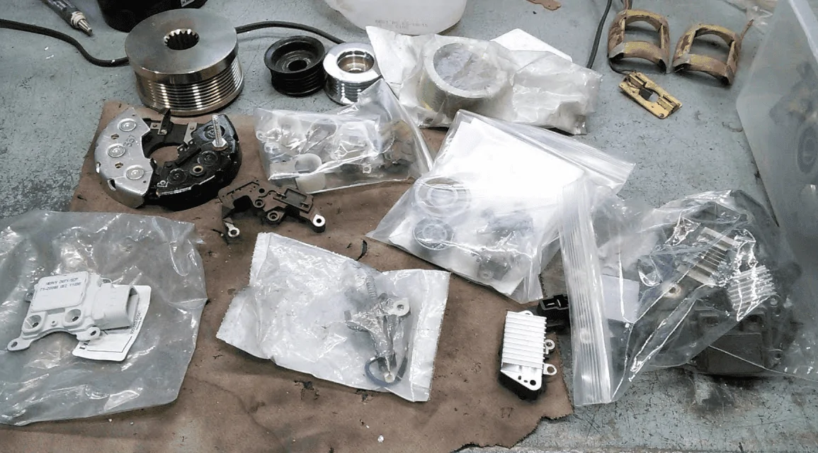

A batch of alternator parts I bought on auction to sort through - mostly 15 year old stuff or older (field windings from a wiper motor, not alternator related)

It wasn't the water - it was the MUD
That makes total sense as these will run fine WET. Water has no impact on them, I have proven that by washing the engine while it's running (and even when not running a couple of times)
Mud - plugged the cooling, perhaps even got between one of the rotors or stators and scratched things up to the point of cutting windings (there are two stators and two rotors made into one physical stator piece and one physical rotors)
Once the cooling holes are blocked and air flow blocked, they'll get hot fast.
