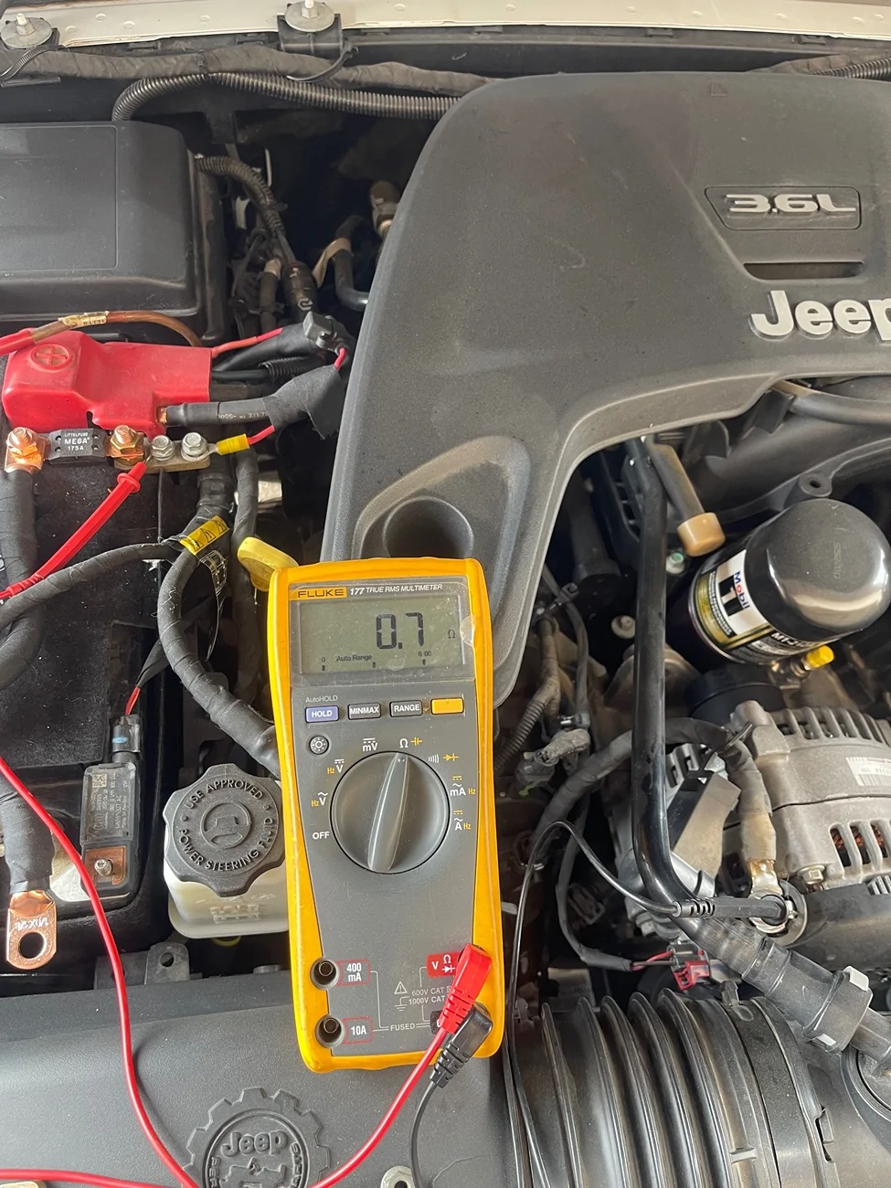

Disconnect both grounds
Measure from plus battery to alternator should be near 0 ohms
This is across N7 fuse
Jeep Gladiator Alternator or PCM IMG_0798

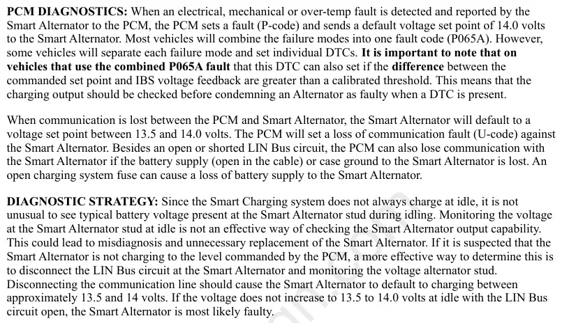

The wire between the PCM and alternator is a LIN bus communication wire, not an old school field wire. Reading the voltage from that wire doesn't tell you anything useful with a smart charging system.
To determine if the smart alternator is bad you need to check three things:
- Check for battery voltage present at the heavy charge wire lug at the alternator with engine off. If battery voltage isn't present, check for a bad N7 fuse or wire break.
- Check that the alternator case has good ground continuity to the engine.
- Start the engine then disconnect the communication wire from the alternator. With the communication wire disconnected, the alternator output at the charge wire lug should default to 13.5-14V at idle. If the output doesn't default to that, then the alternator is bad.
