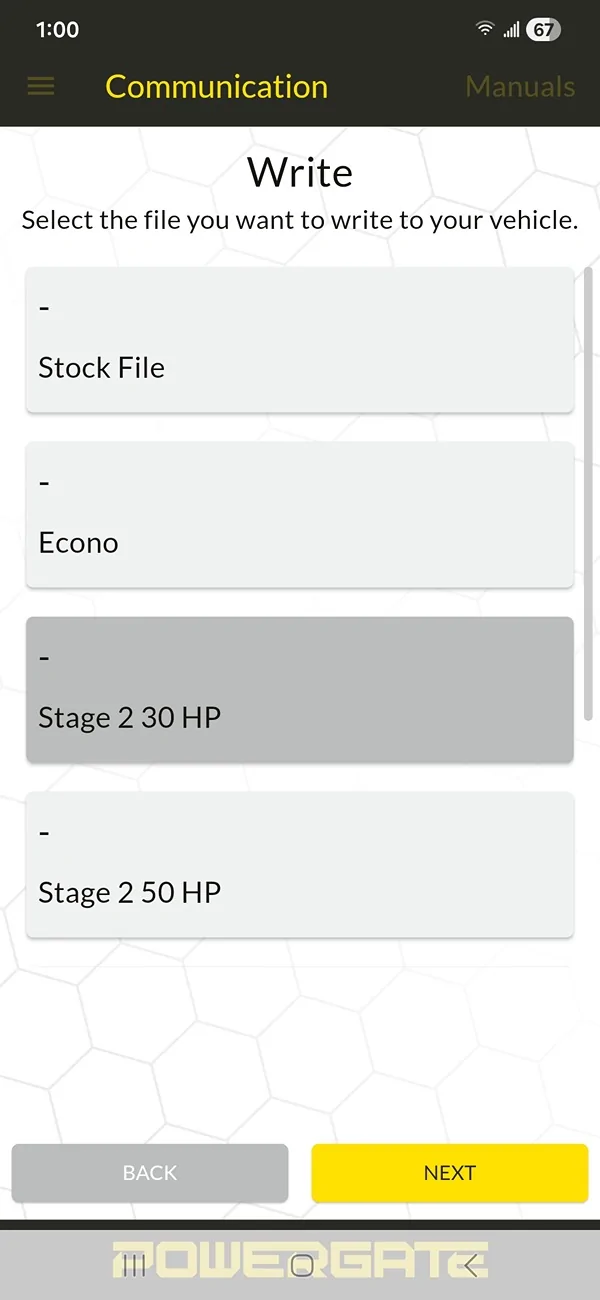

My Powergate holds the tunes for my TCM and PCM. I reflashed both modules using the Powergate and OBD port after having the PCM unlocked. Only the PCM needs to be bench "unlocked".
The TCM can be reflash as installed, directly thru the OBD port.
And you are correct in stating that you do need to bypass the SGM for the TCM AND PCM flashes.
I had my Tazer installed so was able to simply un-marry the Tazer, then it acts as the bypass. I performed my tune flashes and then re-married the Tazer

Ahh! Yes, that is an important point. I have the ACC. I just flashed back to the Econo tune. It's much easier than I expected.
Also, I suspect the Powergate devices have rolled to a new model as I found the instructions are not really that great... I think I wore out my welcome with Martin with all my questions :) But hey, I didn't want to brick my PCM!

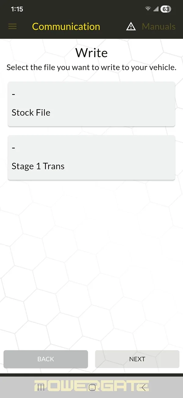

Do you happen to remember about how long it took for you to receive the tunes once you uploaded the stock files with the PG4? I first connected mine Saturday morning and had a little trouble getting the stock files. They tried to help me through it via email a couple of times Saturday afternoon. The last time I tried, I was able to do what you see in the attachment but that looks like it is missing the virtual read they asked for. I haven't heard from them since sending that in.
It took about 3 days. I got my stock files successfully uploaded late Thursday and I finally got the email notification on Saturday. That was with me kinda bugging Martin. I think I annoyed him. LOL But hey! My rig was down for over 2 weeks and I was eager. He was great to work with though. Really helpful.
