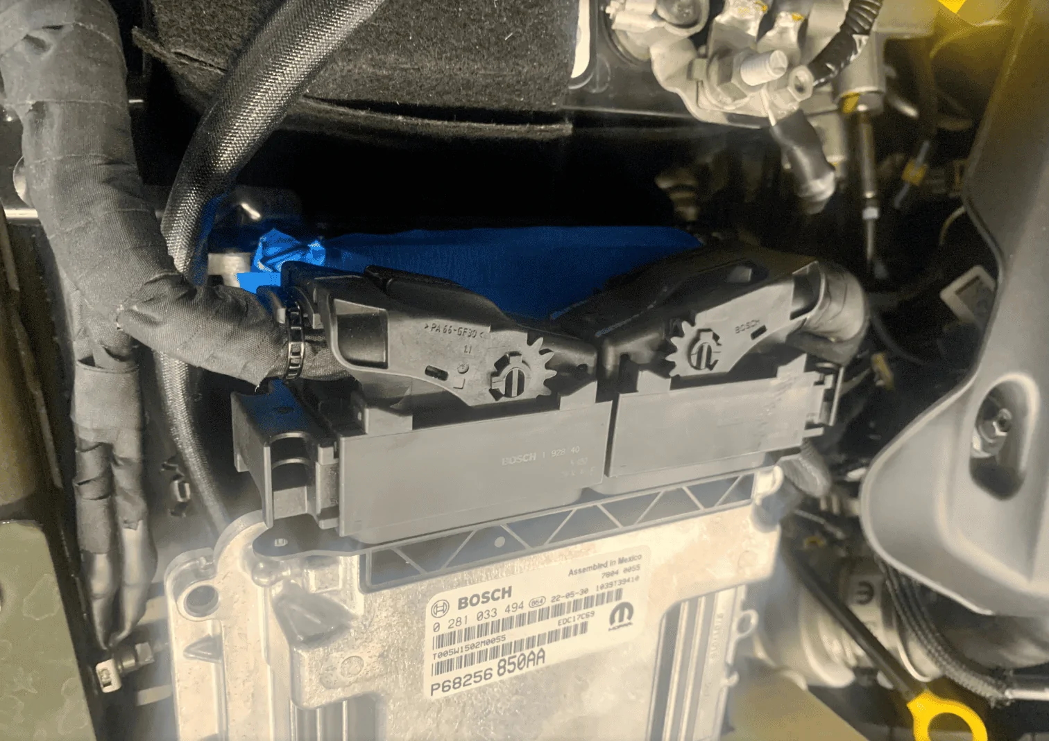

Like a champ so far. Enough play exists in the cabling such that I was able to install it by zip-tying it to the fuse box without having to remove the old one just yet. I just masked off the female ends of the existing PCM. Going to run it a few days but so far no oddities, it seems to have remembered everything down to stations unless stuff like that isn't stored in the PCM in the first place, not sure.

I also grabbed another fuse box cover so I could create a mounting surface to leave my stock PCM in place the entire time. I still haven't removed the stock PCM. Fuse box cover was $28 or something then another $5 for bolts and wingnuts, not a huge expense to be able to hot swap them in seconds thanks to just enough loom in the stock wiring. This way I can just pull the lid with the "extra" PCM, put the stock cover in place and back to stock. I'll post some pics once done.
