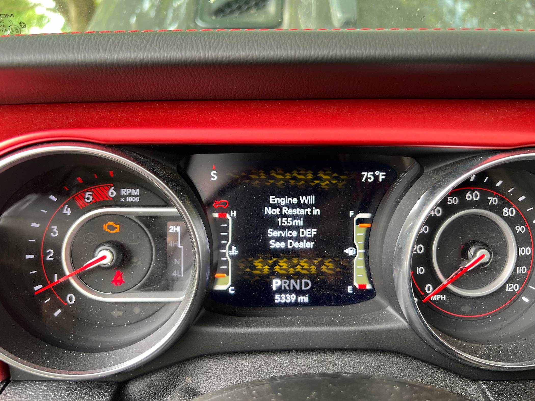

I received mine without software or any instructions as well. I also realize that my laptop doesn’t even have a USB.
Since getting the reprogramming scanner and new PCM in the mail I made the mistake of continuing to drive the Jeep. This weekend I received the dreaded CEL with a warning that states the Jeep won’t start in 150 miles, DEF Service, see dealer. The Jeep is a 2021, with 5500 miles. It’s out of warranty. I am not looking forward to a dealer visit and the costs associated with the DEF system. I tried clearing the codes by disconnecting both batteries (negative) but it came right back.
Anyone in central Florida that might have any experience in these issues? I need to clear codes, so I can then get the ECU cloned. TIA

Can you post a picture of the warning? It is standard for the system to give a warning when the DEF level is low letting you know the truck won't start in X miles. Is the DEF tank full? If not fill it up and see if the warning goes away.

My DEF tank is registering at 3/4 tank. I vented the cap for a an hour and also disconnected the batteries to try a reset of the ECU.
here is a pic of the warning.

You have issue with the DEF system. You know what the CEL code is?
I don’t know what code it is. I have a OBD reader but it isn’t giving me the code(s). I’ve got a dealer appointment in the morning. Hoping for the best…

I vaguely recall reading about people having issues with the DEF level sensor or a connector or something. Hopefully that's what he's dealing with, especially with it being a '21.
They are
The dealer had to replace the DEF sensor in the DEF tank, after not being able to clean the sensor of crystallization. Unfortunately the sensor is actually part of the tank, so they wanted to charge $2700 plus labor and tax. The jeep went over its 3 yr/36k warranty (currently 5300 miles) just 3 months ago.
I called Jeep Cares and after an initial issue, I was able to get assistance and made a claim. I’ve got to say that I’m very pleased with the outcome as they paid for the entire repair. Let’s hope there aren’t any more issues before I can get a total weight loss. I’m still trying to get a local shop to clone the ECU so I can get a stage 2 tune done.
