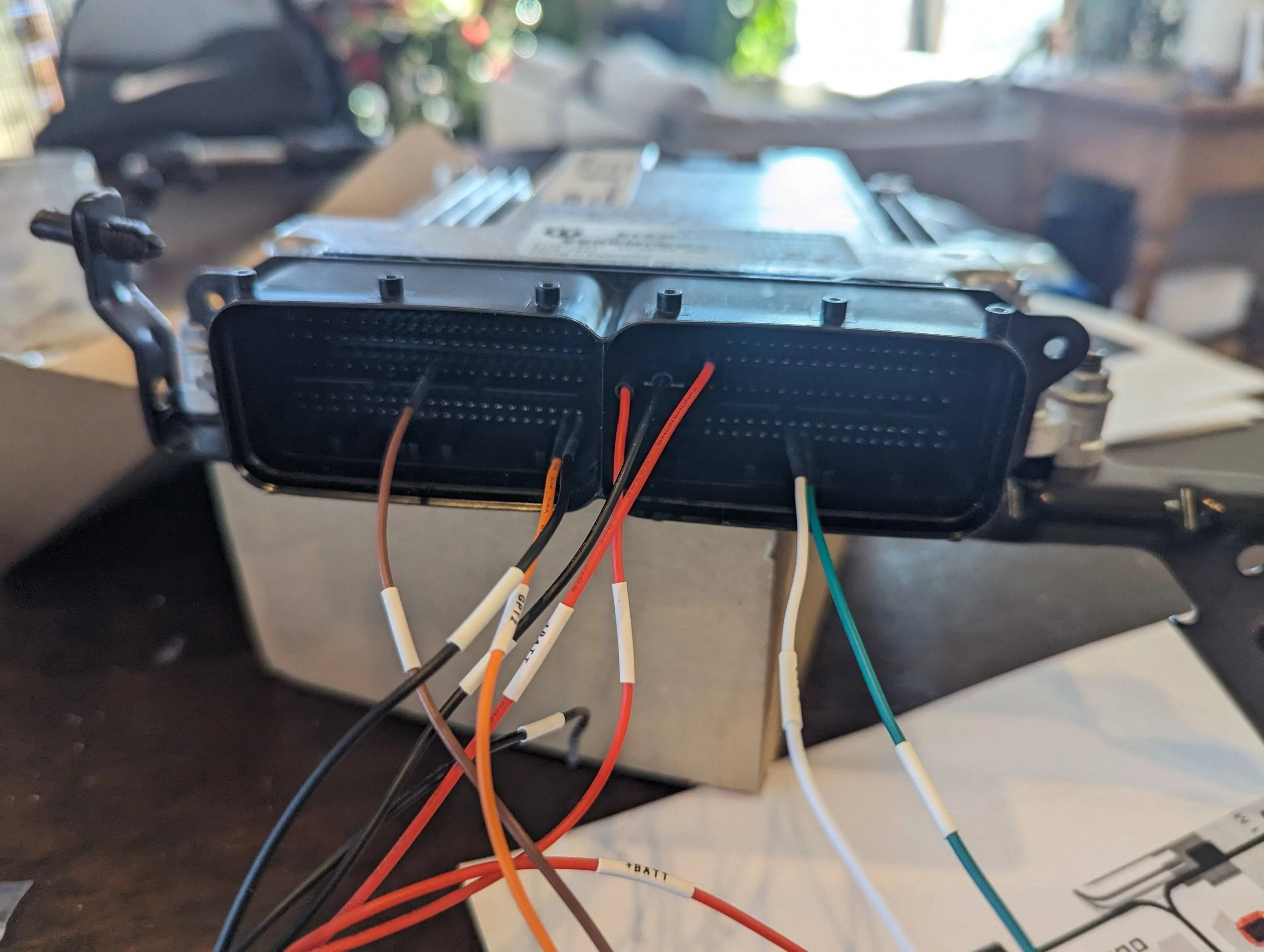

If you want to clone your own ECU, you can purchase the tools to do it yourself for less than $150.
You have to purchase a Chinese clone of a scanmatik 2 pro, and use pcmflash version 1.20
You can get the clone scanmatik 2 pro from here:
US $37.14 25%OFF | SM2 PRO J2534 VCI PCM ECU Programmer Dongle 67 IN 1 ECU Read&Write V1.20 EEPROM FLASH BENCH OBD Update SM2 Hardware 12V/24V
https://a.aliexpress.com/_mPGnnQI
Make sure to choose option (new full set).
If anyone is interested in learning to do it this way, please let me know and I will assist you..
Justin is the man. Longest time was waiting for ALI-Express, they left out the USB Dongle in my first order..... so had to order Dongle in a second order.
1. Installed software
2.disconnected batteries,
3.Pulled PCM, hooked harness up to computer, copied files, installed files on new PCM......
4. Installed Original to its mount, connected clone laying on top of fuse box, reconnected batteries and cycled start button 3 times to pressurize fuel system then started it to confirm no lights.
5. Disconnected batteries and then connected original PCM, reconnected batteries and cycled start button 3 times to pressurize fuel system.
All done ( not even sure if I need the extra fuel pressurization cycle but figure it wont hurt if I just make it a habit anytime I disconnect the Battery) Banks I-Dash showed no diagnostic faults, and I had no extra red lights when starting up.
Even with my ordering error still only $213 with shipping for PCM and then like $100 for the Ali-Express items(should have been less but I had to make two orders lol)..... no trip to dealership and no extra charges to do this...... and now I have the PCM files in a folder on the desktop in case I need to make another Clone.

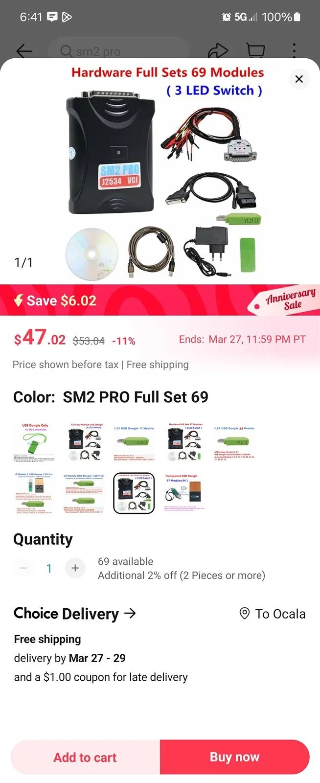

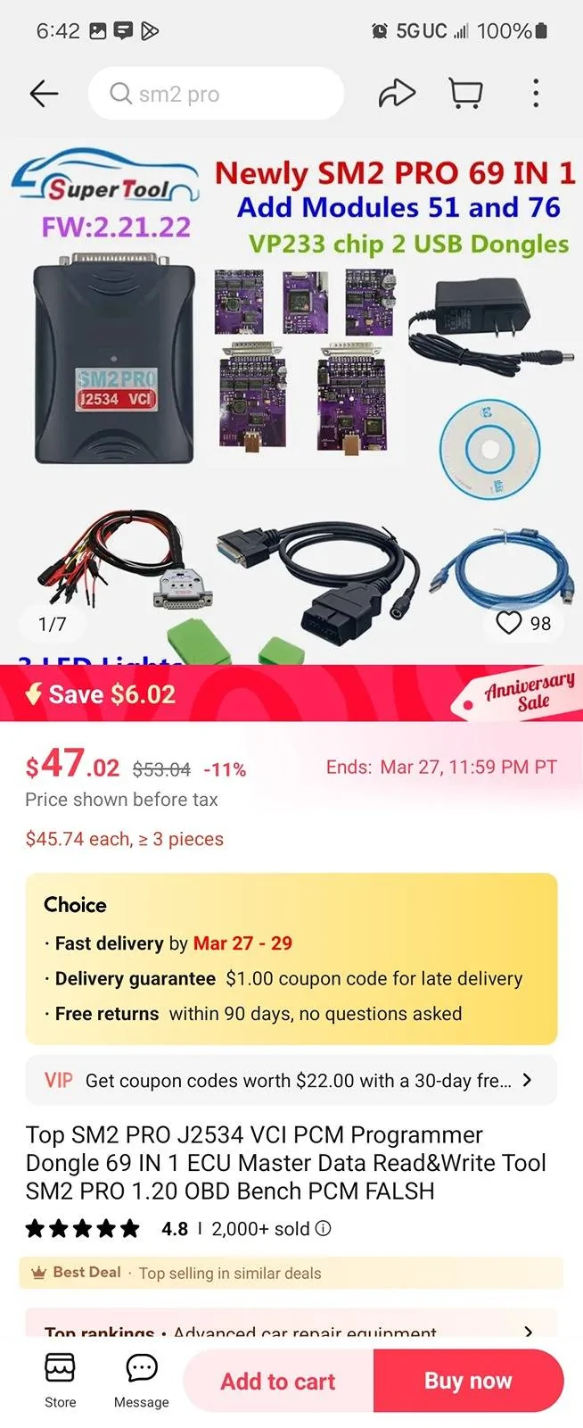

Link is no longer active. Any chance you have an updated link?
Link updated make sure to purchase the full kit for $47
Just found this amazing item on AliExpress. Check it out!
$10.29 11%OFF | Top SM2 PRO J2534 VCI PCM Programmer Dongle 69 IN 1 ECU Master Data Read&Write Tool SM2 PRO 1.20 OBD Bench PCM FALSH
https://a.aliexpress.com/_mKku44O
