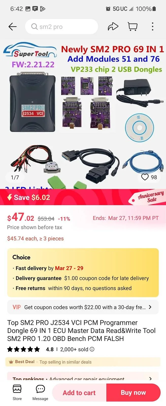

If you want to clone your own ECU, you can purchase the tools to do it yourself for less than $150.
You have to purchase a Chinese clone of a scanmatik 2 pro, and use pcmflash version 1.20
You can get the clone scanmatik 2 pro from here:
US $37.14 25%OFF | SM2 PRO J2534 VCI PCM ECU Programmer Dongle 67 IN 1 ECU Read&Write V1.20 EEPROM FLASH BENCH OBD Update SM2 Hardware 12V/24V
https://a.aliexpress.com/_mPGnnQI
Make sure to choose option (new full set).
If anyone is interested in learning to do it this way, please let me know and I will assist you..

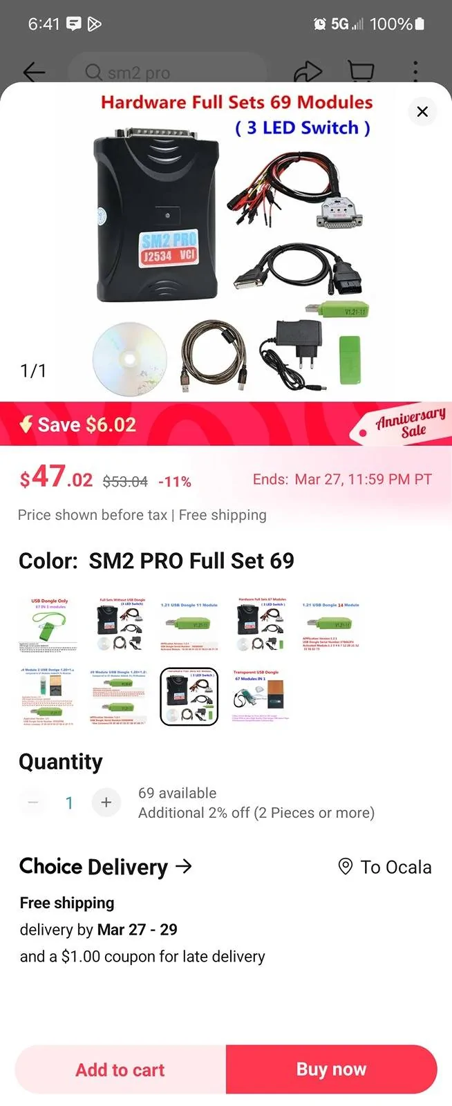

Just found this amazing item on AliExpress. Check it out!
$10.29 11%OFF | Top SM2 PRO J2534 VCI PCM Programmer Dongle 69 IN 1 ECU Master Data Read&Write Tool SM2 PRO 1.20 OBD Bench PCM FALSH
https://a.aliexpress.com/_mKku44O
Jeep Gladiator ECU/PCM clone process & pricing Screenshot_20240321_064201_AliExpress
Jeep Gladiator ECU/PCM clone process & pricing Screenshot_20240321_064130_AliExpress

I have done this myself, and have helped guide about 6 other members who have purchased the programmer and successfully cloned their ECU'S
I don't doubt the programmer could work in essence, just get worried about knocks offs of knock offs being sold by resellers. At a price point of 7 bucks are those the knock off knock off ones that got left out in the rain with the crappy power source that also didn't pass QC and are being flipped?
If you have a seller you bought from that sold a knock off that didn't fry your ecu then I am all ears.
Like i said i just get nervous about untested readers and cutthroat prices, and am hoping someone can point to a seller they bought a reader from that when used didn't fry their ECU.
I think it's awesome you have jumped into this figured it out, gave it a go and it worked!
It's not $7 it is $50.44

Everything is a risk for sure. However so far haven't had anything go wrong. The real sm2 pro cost over $350. Dealer wants that to clone a ECU... Buying this tool for $50 let's you clone the ECU and have all your factory files in case anything ever goes wrong with your ECU, you can just reflash a new ECU...

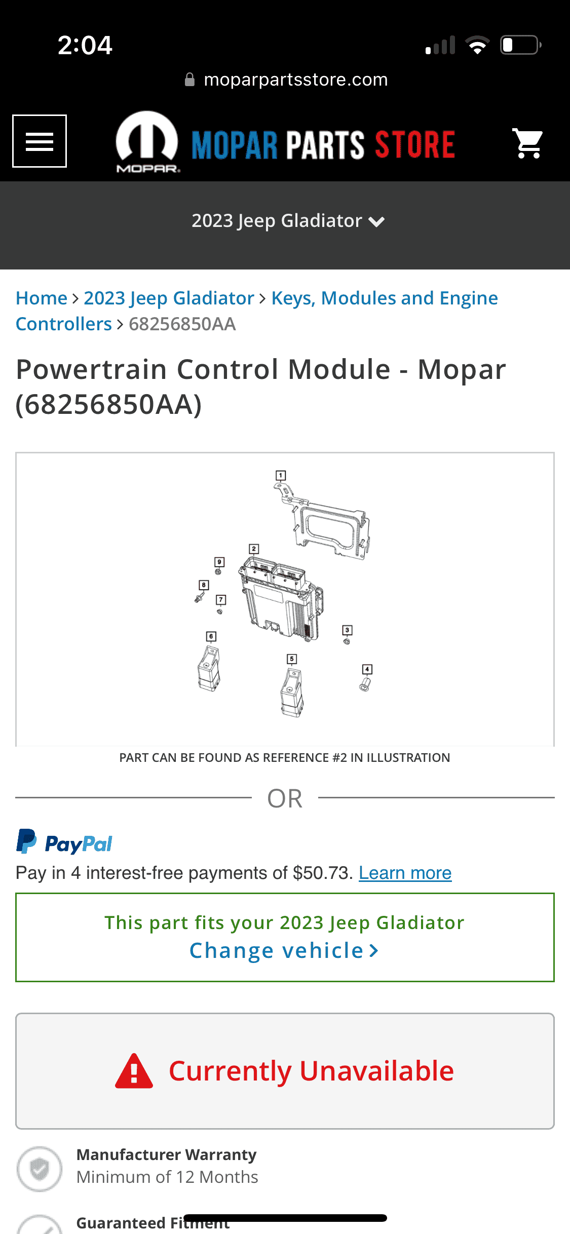

I am just looking into this as well. I tentatively ordered a PCM using the original part number at the beginning of the thread.... 68256850AA. The place I ordered from had an automated response that says it may not fit my VIN. I have a 2022 Gladiator Ecodiesel Rubicon. Can anyone help me out...I thought that the Gen 3 Ecodiesels all have the same PCM....regardless of Gladiator, Wrangler or Ram. Should I be concerned or is this just a canned message from the parts house I ordered from?
Just need some reassurance.

When I’ve searched the part number through different Mopar part sites. It said they were compatible with the 2023 Ecodiesel
