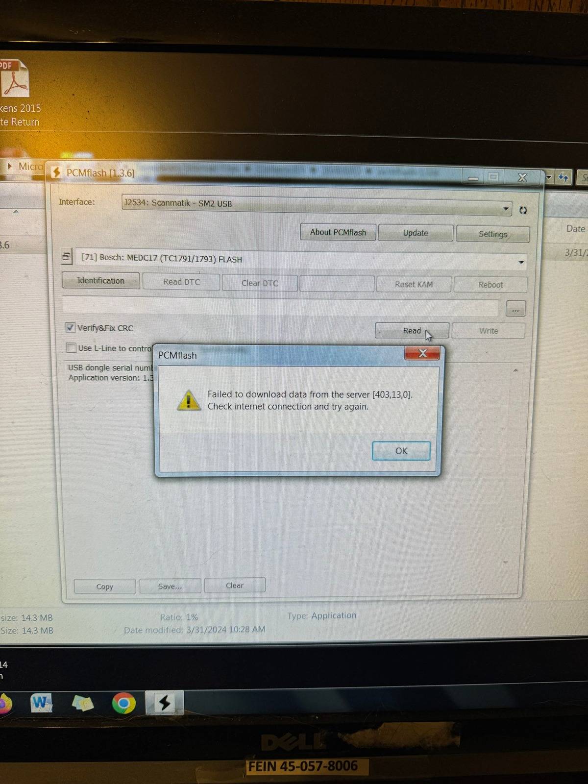

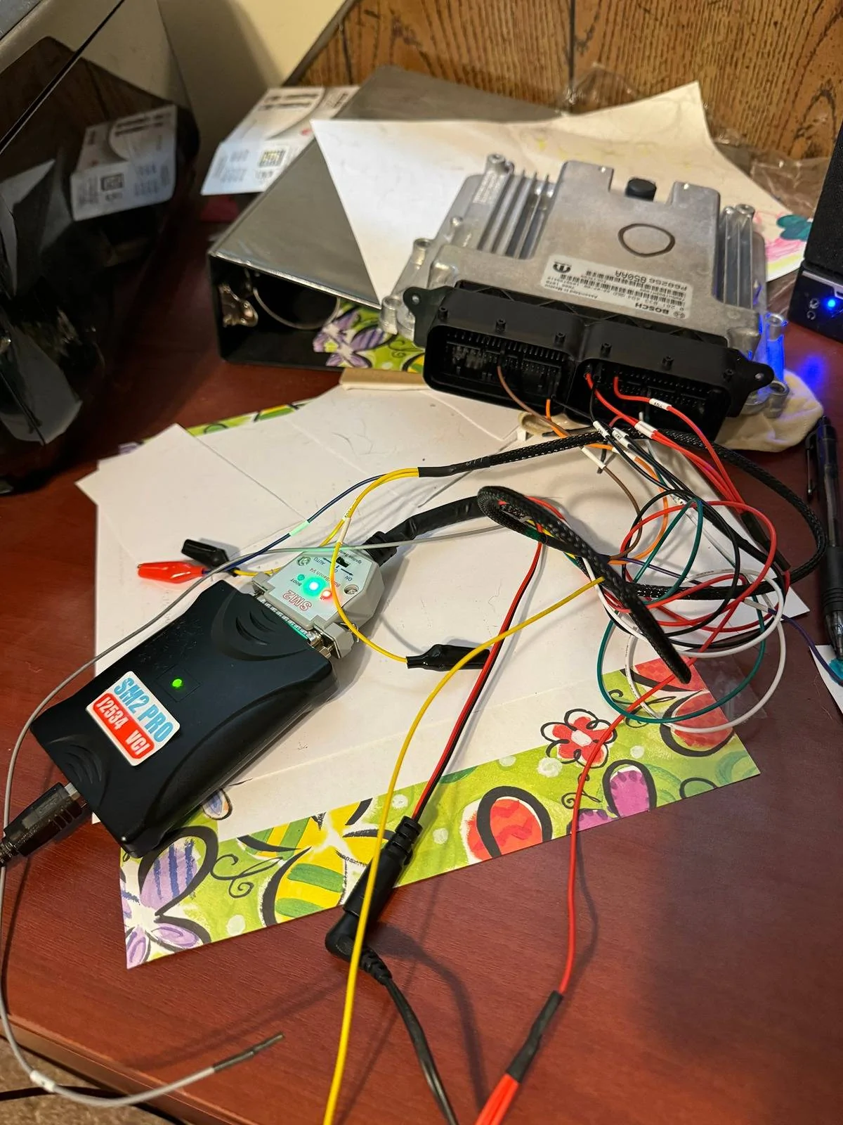

I am either doing something wrong (entirely possible) or the Aliexpress system is being blocked by the software. PCM Flash released version 1.3.6 on 3-31-2024. I tried the included version and the shared version others on here have used. Both required you to update to the 1.3.6 version and I can not get it to read the factory ECU. All attempts to update or identify/read the ECU gives the error "Failed to download data from the server (403,13,0) Check internet connection and try again." I have tried on two computers and both connect to the internet fine.
The computer and software are recognizing the dongle and 2 green thumb drives and I have checked the connections about 50 times. Any advise would be amazing! Trying to avoid putting the jeep back together with without successfully cloning.
Jeep Gladiator ECU/PCM clone process & pricing IMG_8053
