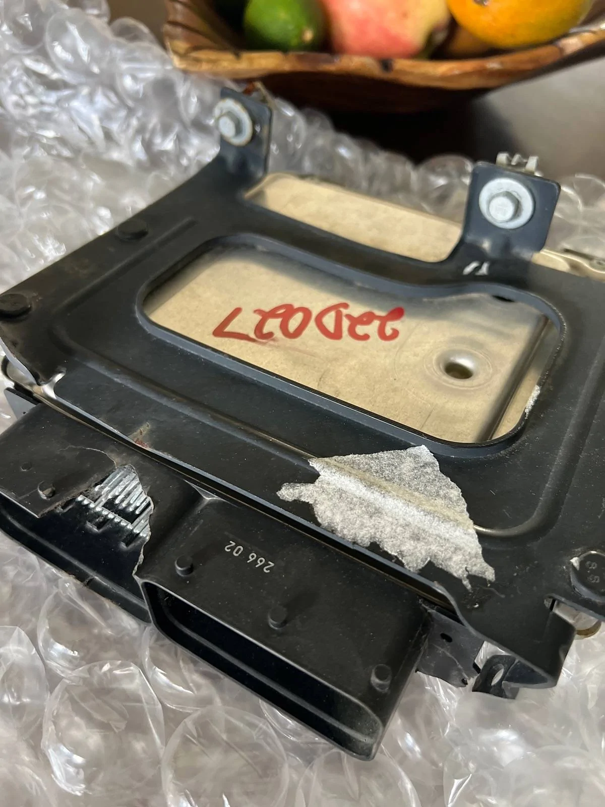

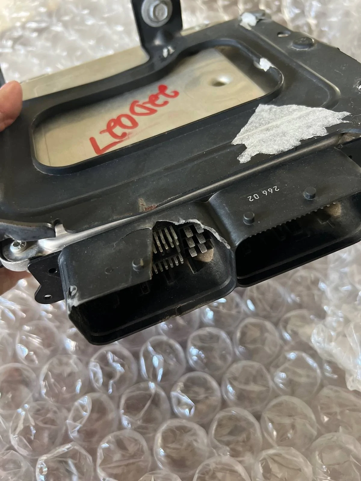

So I just got my new/used ECU in the mail from a wrecker. Came from a 21 ECO gladiator. What are your thoughts on the broken plastic parts? Send it back or….?
Thanks
Thanks
I wouldn't trust it given the crack as you've mentioned but also the oxidation on the pins leads me to believe it sat open-faced or at least exposed to rain for however long.
Yeah I saw the pins looking like chit!
I’m in Canada so with exchange and shipping and all that fun stuff this was the cheaper route to go. As we can see, obviously not! ?
We are travelling to the states shortly, so I guess I’ll buy a new one and have it shipped to the border and pick it up on my way back.
Never did price it out here and have the dealer flash it for me.
Thanks
Thanks
Send it back. The bent pins and missing alignment studs from the snapped plastic may damage your female side on install. I would not even test it.
And the fact that the connection should be water tight. With how far down that is cracked water will get in there no problem and start shorting things out.
Thanks
Reason I would say send it back is the small pins that are now missing on the broken part, they’re used by the mating connector to guide, and then lock the connector in place. I wouldn’t want that to be lose or just mess up pins or main loom connector due to misaligned pins and a bit too much of force applied.
EDIT: finished reading the thread and @22EcoDs beat me to it.
