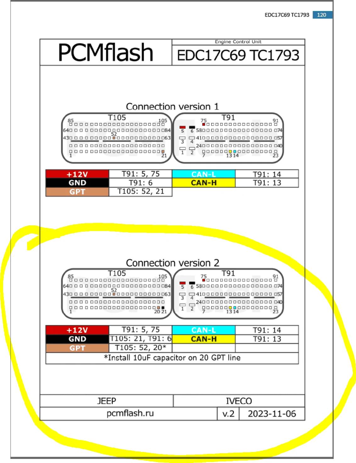

Step 1 done - I was able to pull the flash and eeprom from my donor ECU.
Next i will try to pull that info off my JT's ECU and then write the good info to the donor ECU. I'll save that for another day...
I did go down a rabbit hole trying to figure out where the pin diagram came from in the PDF instructions. I wanted to tied back the pin out to the pcmflasher program since it hosts pinout diagrams to be used with it's program.
Any who, the magic search info for the ECU is "Bosch EDC 17C69" (info is on the ECU sticker).
And the Pinout info is found on the PCMflash_71.pdf page 120 option 2. At least that is what aligns with the instruction PDF and the config that let me read the ECU.
Jeep Gladiator ECU/PCM clone process & pricing 1717293301034-cf
Armed with that info you can now self educate and start doing some searching related to that ECU and what is out there for you to screw with.

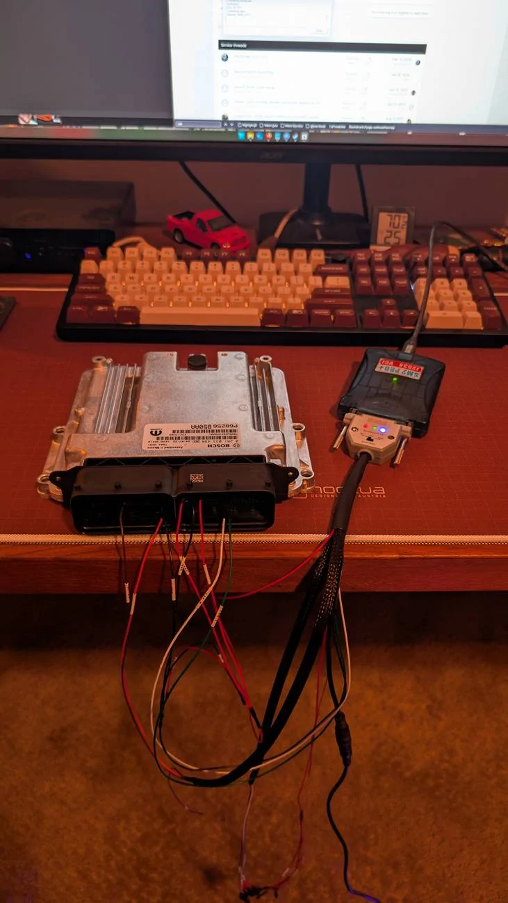

Clone appears successful! Used the knock off aliexpress sm2 pro following some instructions posted on this site. I bought 2 of these devices if someone wants one. I will include some annotated notes to the original instructions that i found helpful to clear up some confusion.

I was nervous about cloning the PCM myself, mostly due to the knock off harness and that worst case scenario is you have a bricked PCM and a dead gladiator... Regardless, I did it anyway. I am happy to report that I just got back from my test drive with the cloned PCM installed. Everything works 100% perfectly. No security light, no errors or codes, operates just like the original one was installed. Thank you @Justinswidebody for your PDF instructions, they were very helpful.
The only thing I did different was that I got my harness off of Temu for $40.45 shipped. It's the same one but I also had to buy a 12v wall outlet power adapter vs the car cigarette one it came with.
For anyone considering this, take your time, triple check everything and you'll be good to go.

Also just completed this process tonight. Kind of fiddly, some of the colors weren't the same and the labels didn't match exactly but it was pretty straight forward.
I COULD NOT get it to read the ECM, though, until I saw @rharr 's note about doing the identification step first. Then it worked right away. Seems obvious, I'm fairly experienced with HPTuners and I always do a preliminary pull first but this whole Chinese setup made me a bit more hesitant to try anything outside the instructions explicitly. I just kept messing with the timing of plugging in the power lead and I wasn't getting anywhere.
Also windows defender didn't even flag anything as suspicious. All seems "above board."
Anyway, haven't driven it yet but it just fired right up in the garage with no codes or lights.
Thanks all. This isn't just going to help me, it's going to allow me to help some others locally.
